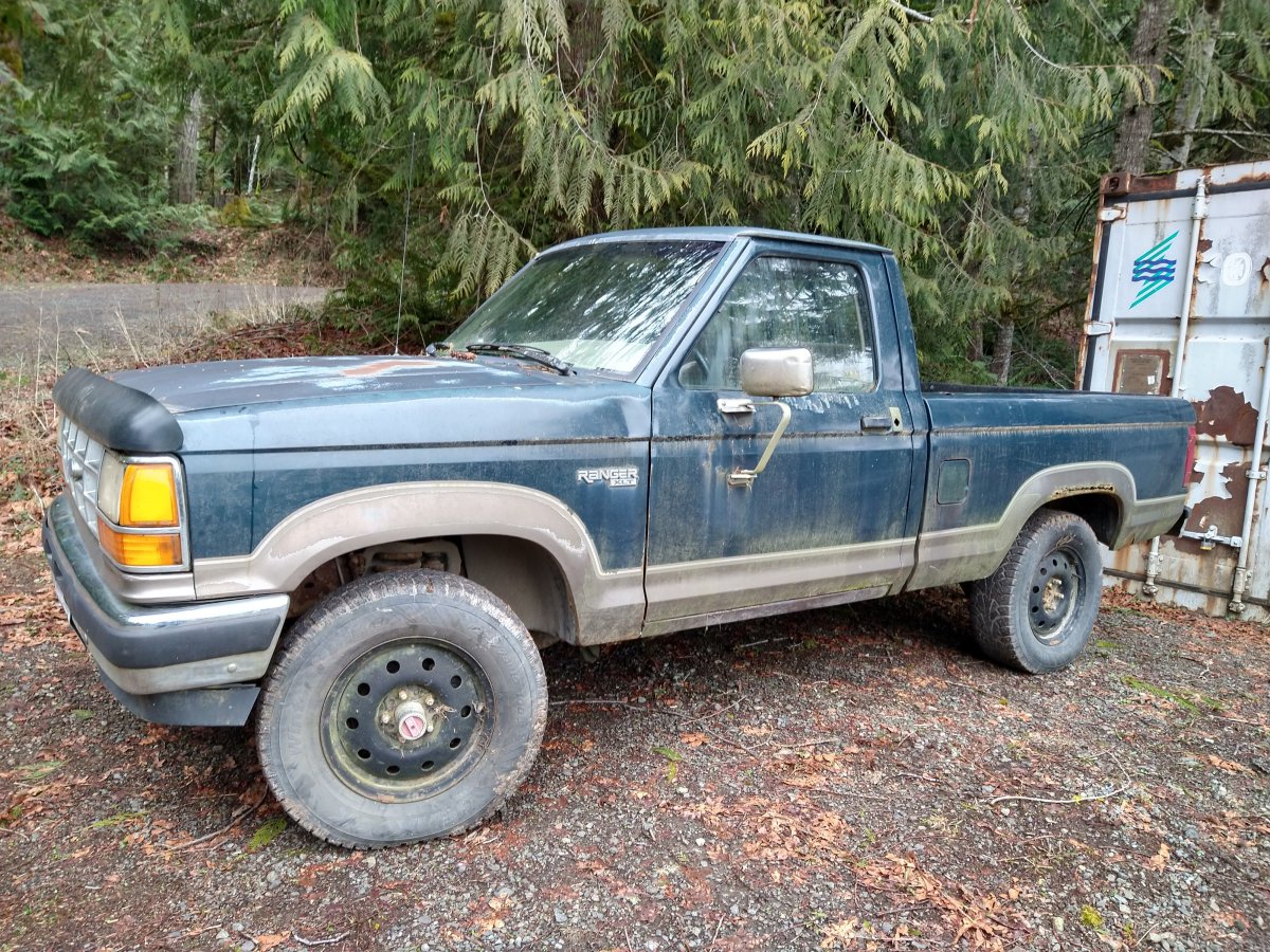

The plan is to take this '89 Regular Cab, Short Box 4x4 frame, and drop a 91' Extra Cab body on it. Swap in a 2.0l TDI motor, and have fun wheeling and daily driving it

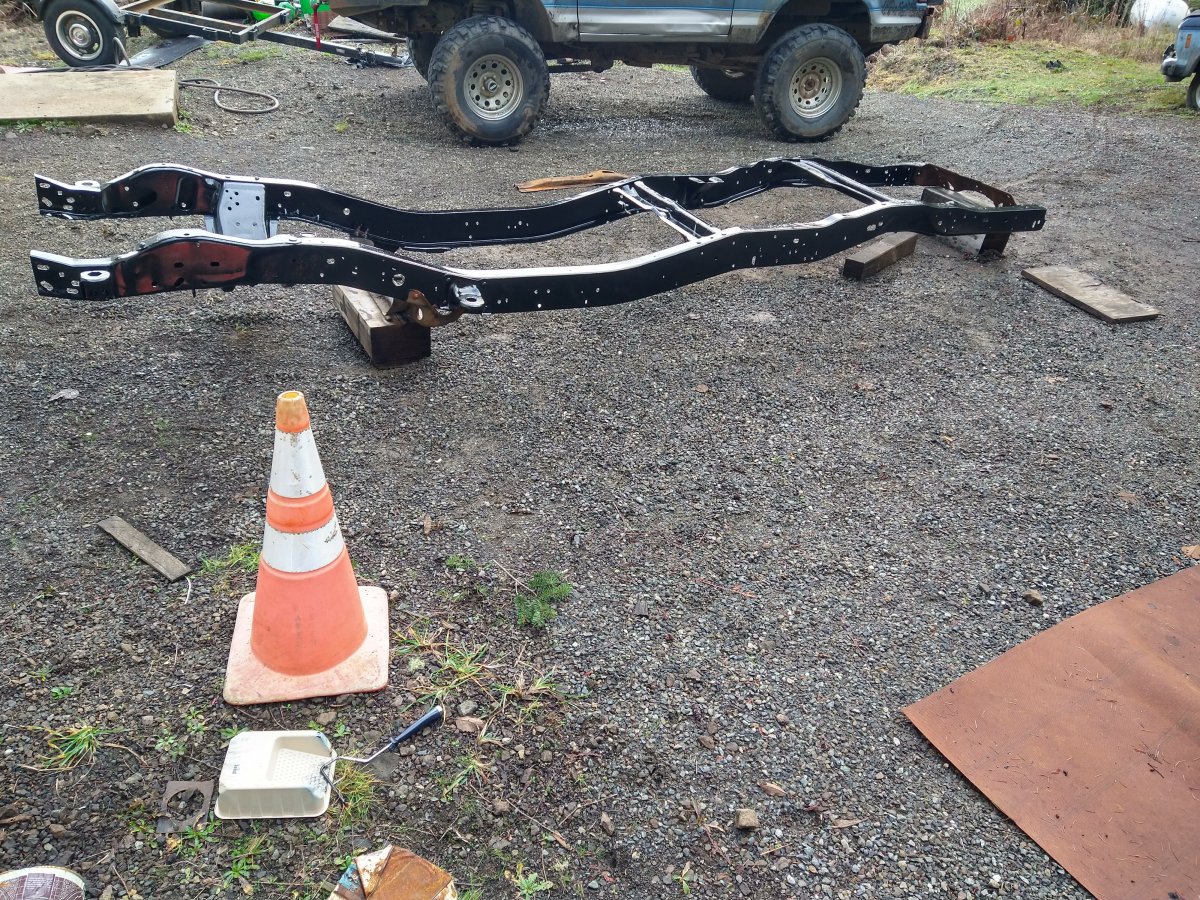

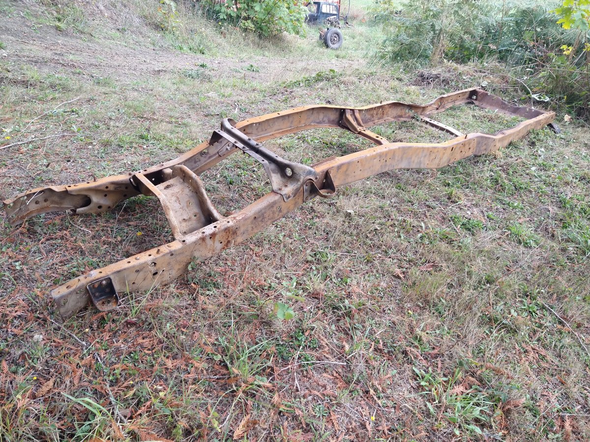

I spent the last year stripping down the Regular cab to the frame, and sand blasting the frame

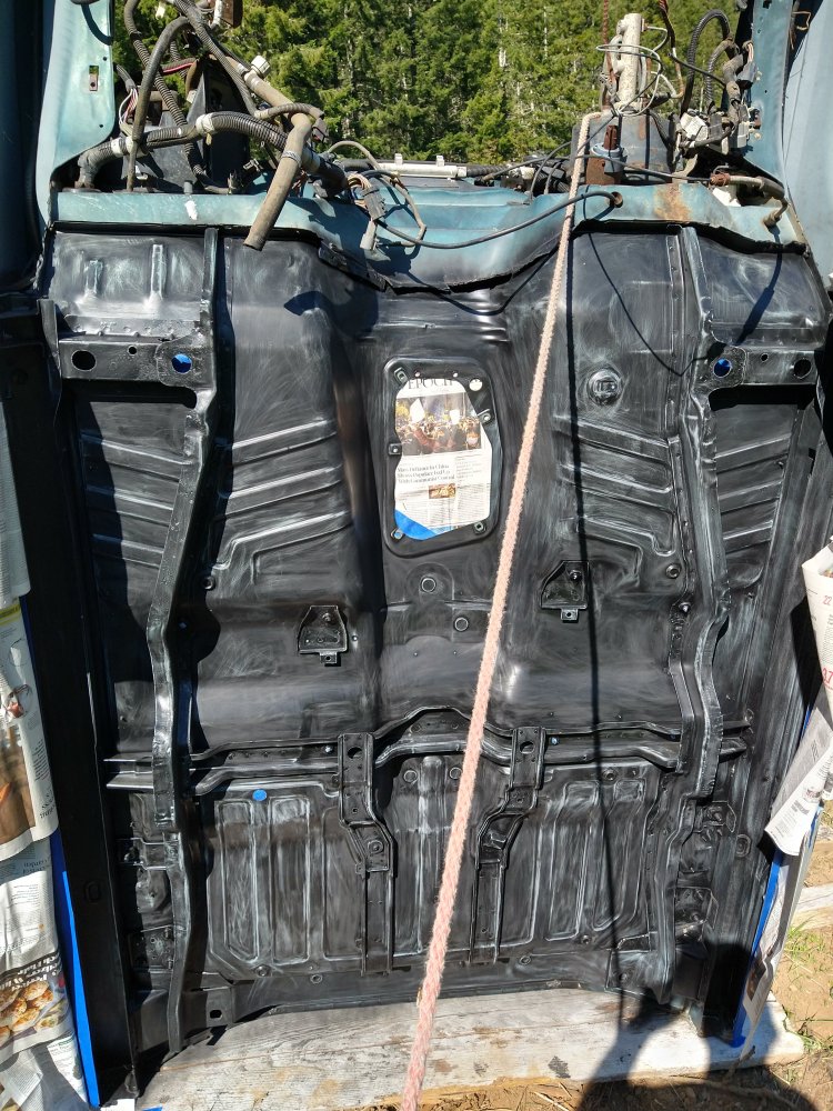

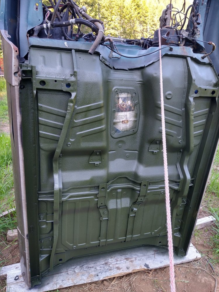

Also spent a little time on the underside of the Extra Cab with some paint and Raptor Liner while I had equipment around to lift things up

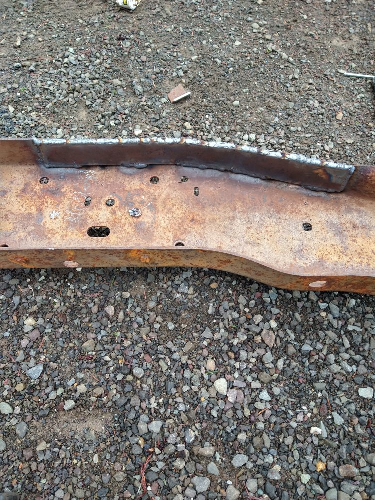

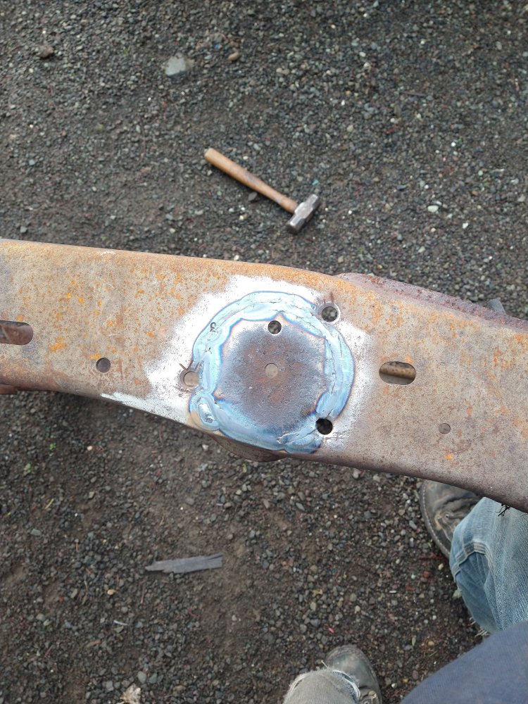

Just last weekend finally got around to patching a few spots on the frame before I get some paint on it

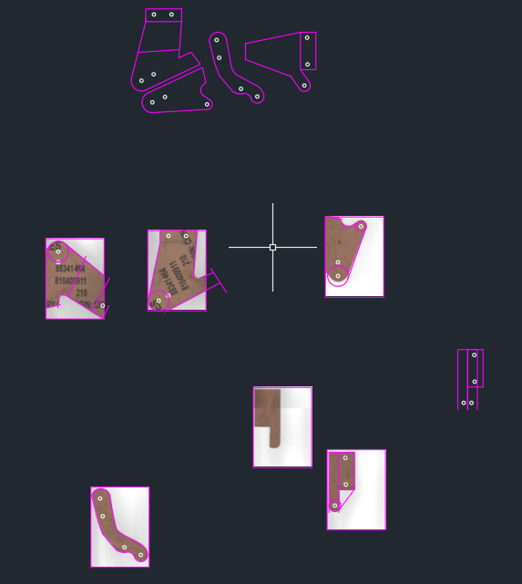

Have also been working on building some lift brackets for the front axle. I tried to model them after the STX lift brackets, except with 2" of lift. Need to get a press brake to bend things up still. Plan is to run this, with a cut and turn at the ball joints for the total lift

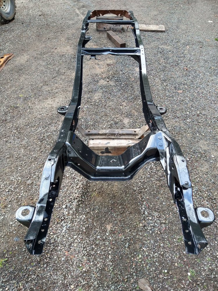

Weather was nice enough yesterday to get the frame painted. Got one coat of por15 on it. Probably need to get another coat, and then top coat it

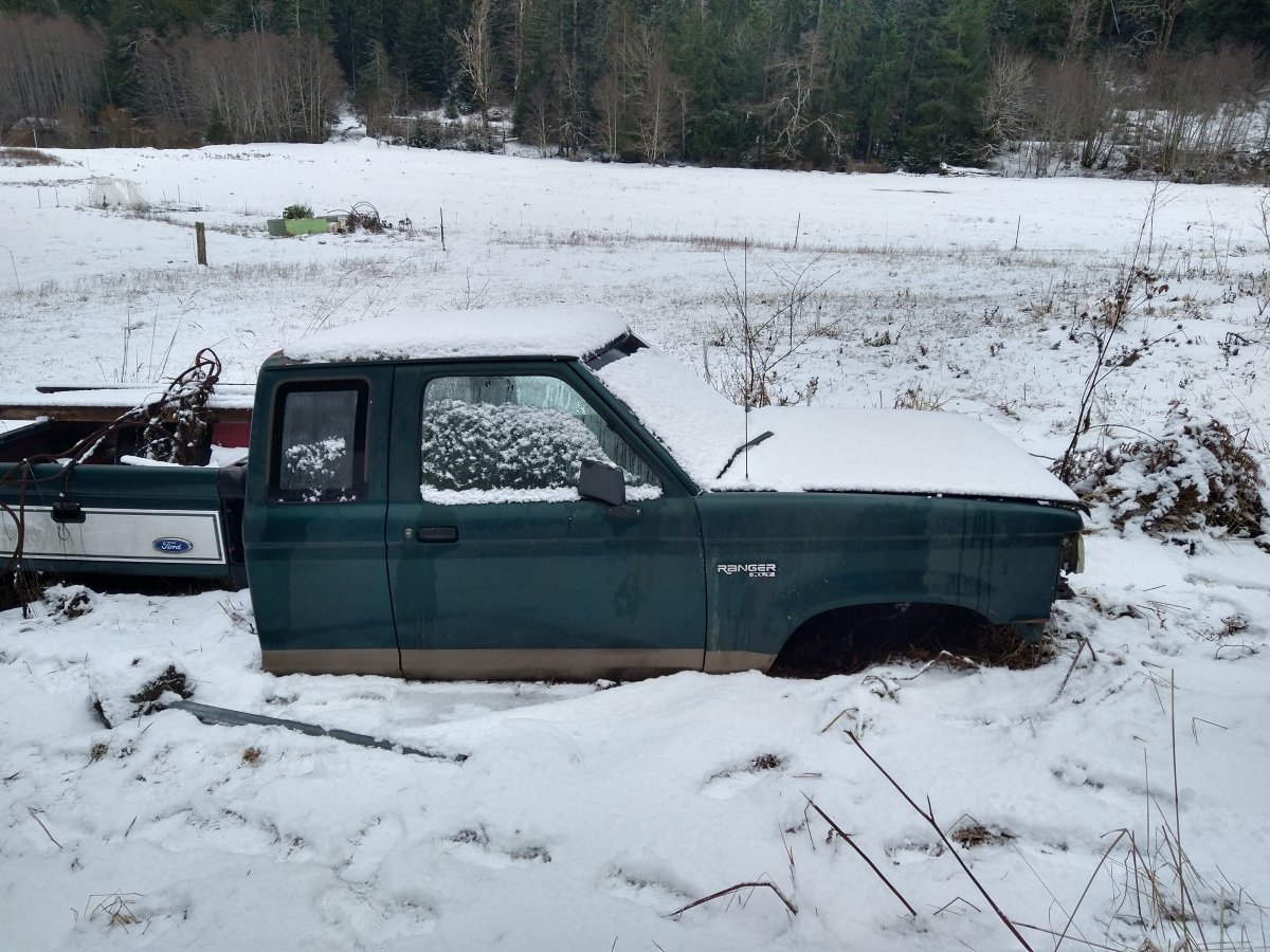

Does anyone happen to know the weight of an empty extra cab body? We moved stuff around with the excavator, but I'd like to get this in my carport on a level surface to set the body on, plus I have to fab a rear body mount perch. so it would be nice to have it sitting level to figure things out.

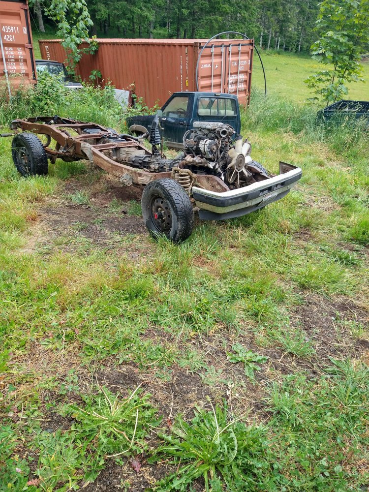

Well not a ton of work done for a while, lot of research and planning, little bit of clean up on parts, and figuring out what things I need to purchase
Got the TDI pulled out of the donor car

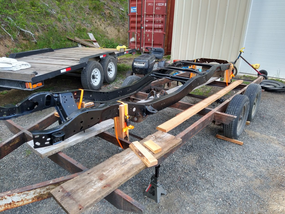

I did get the frame set on another trailer frame I have and got it all leveled up so I can get the cab mounting figured out. Just need a solid weekend to get things fabbed up and mounted

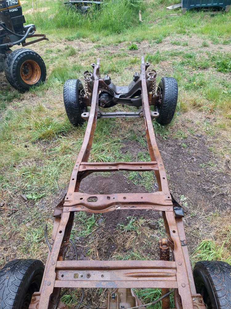

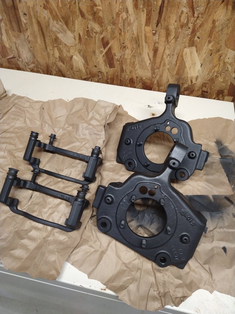

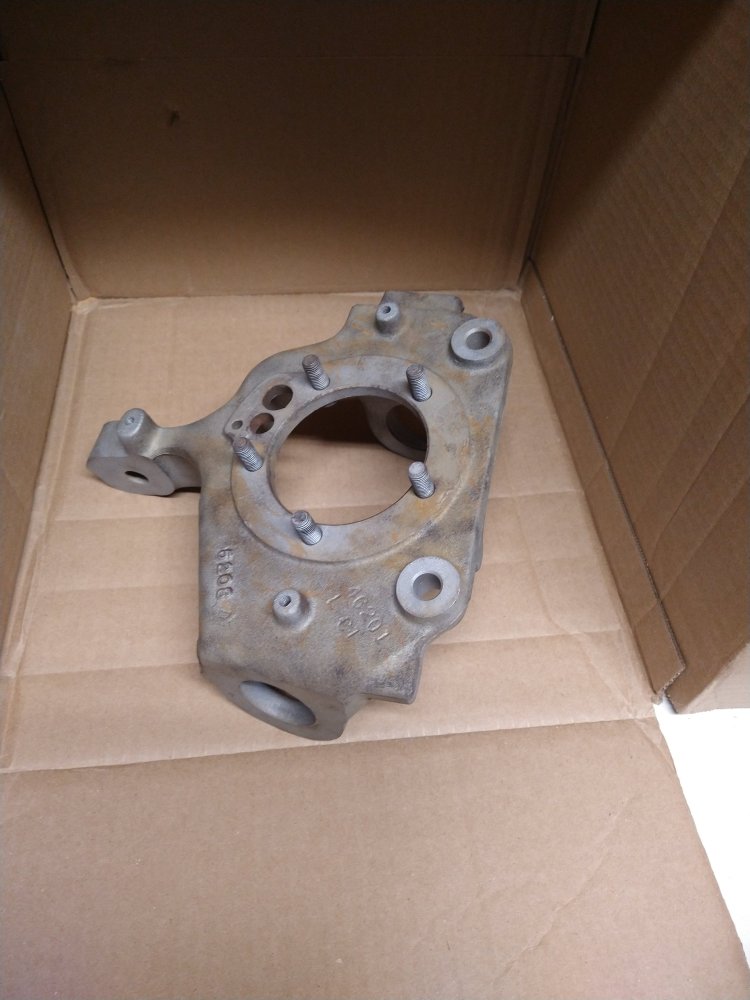

Got the steering knuckles for the D35 sand blasted and painted. Tried out some Steelit paint, looks great hopefully it will hold up to wear and tear. I did get the axle broke down, all joints pulled out, and just getting a list of parts to get it back together

Still looking for a rear axle, would like to find a disk 8.8", if anyone knows of an exploder parked in a backyard in the PNW, that would be great. The list of things at this point is to get the cab mounted so I can get it sitting at home and be able to work on things as I get a little time. Get front axle brackets welded up and axle mounted so I can figure out how much I need to cut and turn. And then just keep on with the project

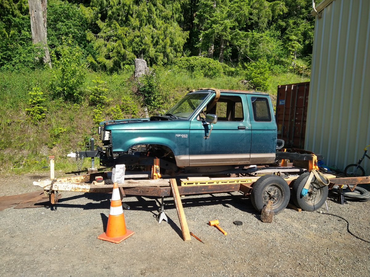

Got a fair amount of time spent on the project this weekend, along with some nice weather.

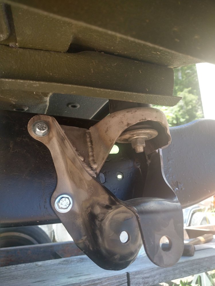

Body is sitting on the frame now and got the rear body mounts fabbed up. If anyone is curious, an extra cab on a regular cab frame puts the rear body mounts about dead center of the front leaf spring hanger.

Truck looks great, just has some redneck spacers under the front right now to figure height, but I got bolts ordered and just need to fab up some body lift blocks and get everything bolted down
