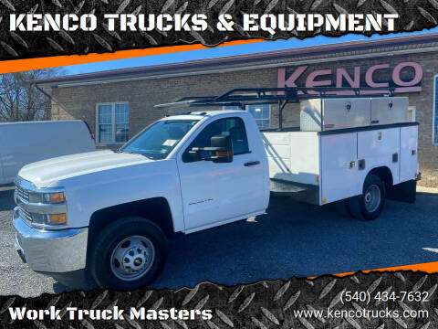

This reminds me of a truck I once saw. It was a New work truck, Lets say F350 (?) but there was a space between the cab and bed ( about 2', maybe) and in that space was a compressor and welding machine. I thought that was a genius use of space. the compressor and welder wasn't IN the bed like most work truck that have the same equipment. The bed still had room for all the tools and things. I assumed it was like putting a single cab on a quad cab frame with the bed where it would be on a quad cab. leaving the space between the cab and bed free to put equipment there.
like this (kind of)

It took some weird search words, but I finally found an example.

This is the one I was thinking of
I’ve always assumed those guys took a short box and put it in a long bed frame. Or even a chassis can frame. Like a 8’ bed on a frame for an 12’ flab bed or something.
I’ve seen more crew cabs with a gap between the bed cab bed than singles.

That thing presents an odd picture, glad I don't have a service bed! Thanks for looking.
That is some mighty fine information, thank you! Definitely gonna draw some different storage configurations out and sit in a single cab, see how small the space is. 14" sounds like perfect amount of space for a big ol fuel cell (good shit dodge, I never say that) and would probably help me bring some weight forward and centered to help with understeer. That dodge is pretty dang cool, and 170gal is a wild amount of fuel.
Yeahhhh looks like that would make a lot more sense as for as effort expenditure
