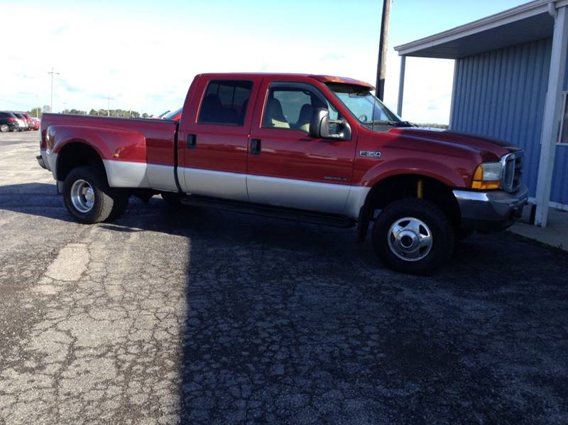

Seen this yesterday. Got quite a few miles but looks well cared for.....thinking about checking it out. Whats yalls take? I dont know a whole lot about the 7.3 so anything to watch for?
No personal experience but from my reading, the 7.3 seems to be the most desirable of the Ford diesels. IIRC, it was made by International.
Never mind. Missed the description part. Says it smokes on startup and misses. I aint touchin it.
Probably just a bad injector. The 7.3 is right up there with the 300 I6 as far as durabile Ford engines, though the 7.3 was made by International. That's a pretty good price for a 4wd Crew Cab and 195k is nothing to a 7.3 that's been reasonably maintained. The 7.3 can be made into a decent runner, but in stock form it will pull a house. It's no 6.0 or 6.7, but great for a simple dependable workhorse.

Oh i know the 7.3 is a good engine.
But not knowing how long (or how hard) iu got ran with that bum injector makes me nervous. Not to mention i have no clue how to rip into a diesel besides lefty loosey righty tighty lol

That's pretty much how it works. The injection system is a little different than a gasser, but not incredibly complex. I don't know what part of Michigan you're in, but there a shop in Defiance, OH that's about as good as it gets for 7.3 Powerstrokes. Well Powerstrokes in general, but they cut their teeth on the 7.3's and know them well. CNC Fabrication If you could get it to them, I'm sure they'd tell you all you need to know about it.
Im only about an hr and a half from defiance. The truck is about 30 min from there.
What would it cost labor wise to get injectors in it?

A full set of injectors would probably run between $1000 and $1500 for stock replacements. Labor is iffy depending on the shop, but I'd guess it's about a 4 hour job. I've never done a 7.3 , but that's about what I'd think the flat rate would be on a 6.0 and they're similar in that respect. @adsm08 might have more information there. I don't think he's into diesels, but he could probably look up the labor time. Give Corey a call at CNCFab or start a chat on their website. Tell him G8orFord sent you, it probably want save you anything, but it might get me a discount the next time I buy something from him. LOL
Better yet, join Powerstroke.org and go to the 7.3 section and talk to them. Great bunch of guys over there. Kinda like here, just without the pooping in the furnace stuff.
