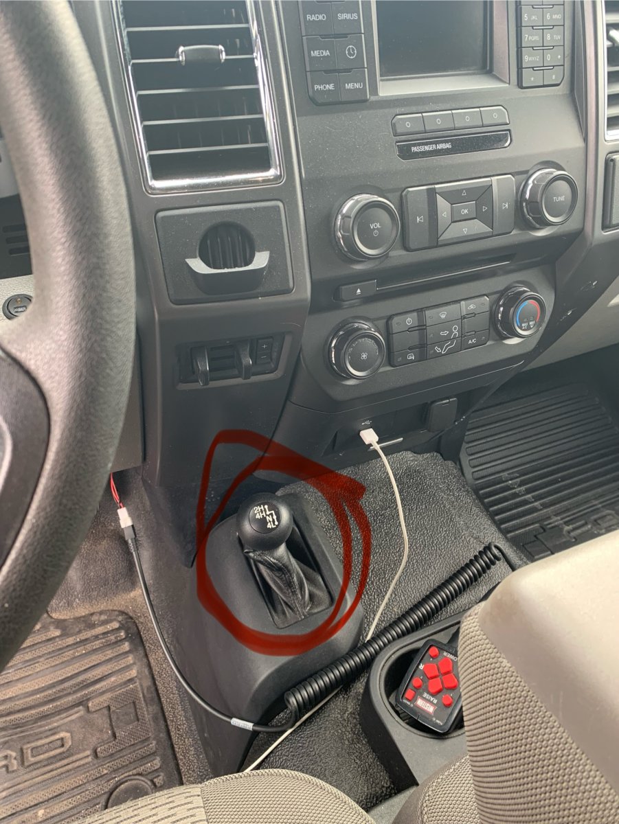

I was gonna have the dealer look at it but since it just costed me 1100 bucks for a range sensor ill look into it myself...
What would cause the auto hubs not to lock? The 4wd works fine if i lock it in manually. The vacuum hoses look good. I havent dug real far in though.
I guess i dont understand how the auto hubs work and what exactly i should be looking for when i dig into it.
Any input is apperciated.
