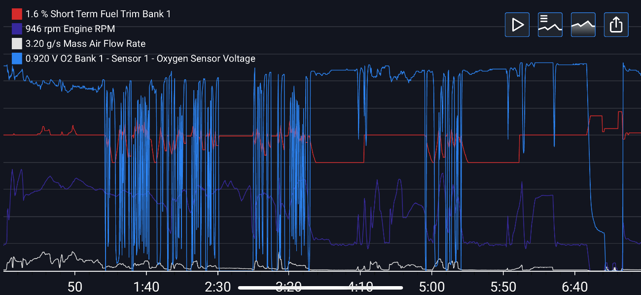

Do you have a code scanner that can show the 02 trims & ideally live data (with a graph)?
Knowing what the trims do based on RPMs and load can be a useful indication as to where the problem may be..
Also being able to see the reading can show if the sensor itself is bad or not.
If the sensor reading is pegged at it's highest or lowest value then it's probably a bad sensor or connector, but if it's readings are fluctuating and responding to what the car is doing then I wouldn't even consider replacing it until you sort out the other issues.

I have a scanner and the O2 sensor starts high and will swag with rpm input but stays high and drops on rpm drop. The short term fuel trims have been the weirdest through this search as it mostly holds at 0 during idle and drive but will have random spikes between -20 to 14% swings. I will attach the graph below of a short drive with engine at warm temp.
