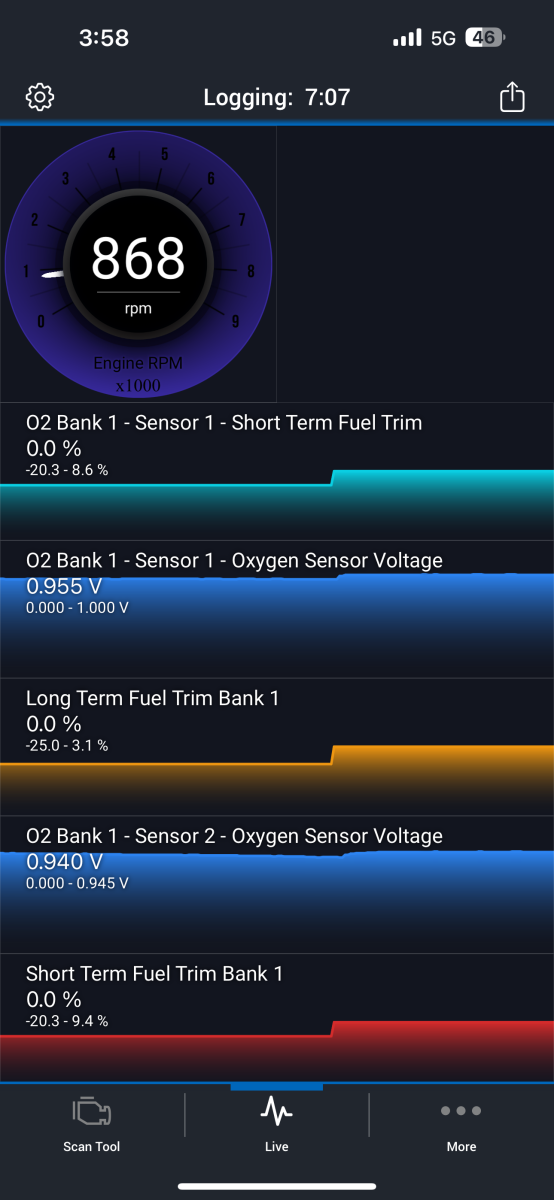

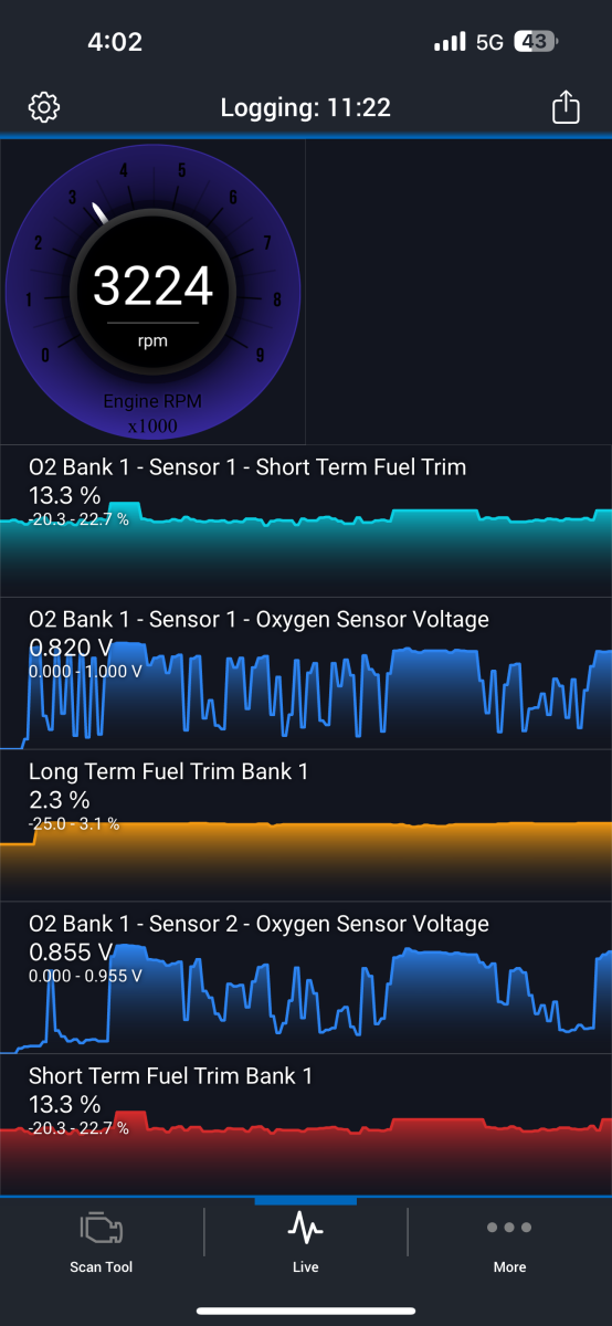

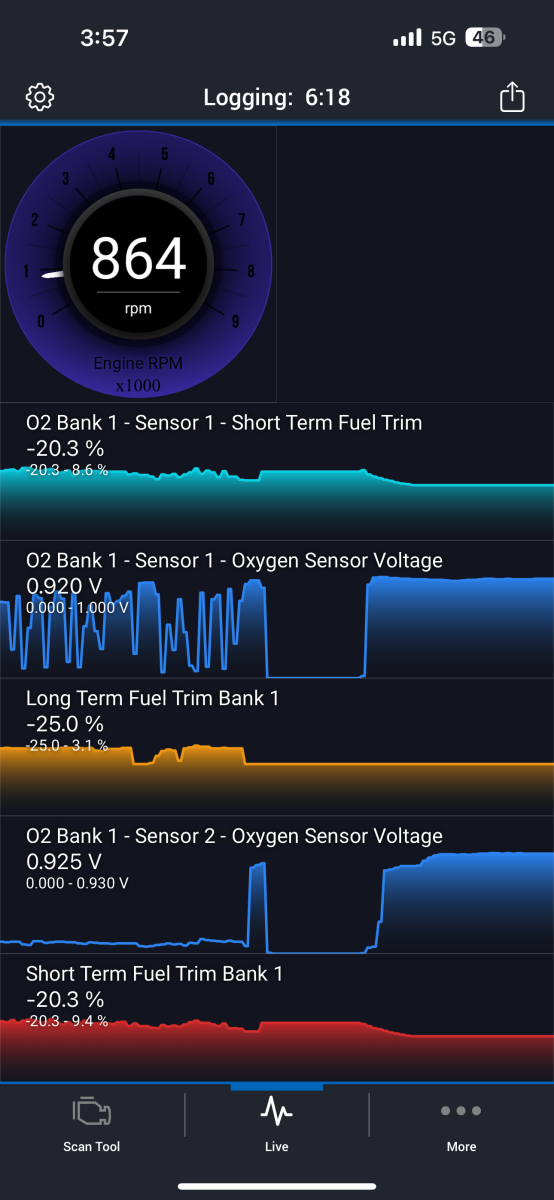

Hey all, just been dealing with the rough starting and revving it up to keep it stable until it’s warm enough to drive normal and figured I’d post some of the live data my scanner was pulling today because it seemed odd to me but could be normal as I am still no expert with these graphs. I will post below and I have three photos, you can see the time stamp of run time at the top if you expand the photo. After running and driving for 6 minutes, the photo is a snap shot after coming to a stop at a light. The next photo is after a little less than a minute of idling at said light and the fuel trims normalize to 0 and O2 sensors ping high. (Just looked off to me when watching it live). And the last photo is me driving down the highway. Hopefully someone can diagnose this data better than I can and help narrow down the problem. I did buy new Bosch O2 sensors but don’t really want to replace until the other issues get clearer. But I also retested the IAC when the engine was warm by unplugging and it sits nicely at ~500rpm and jumps back to ~800rpm after reconnecting.
