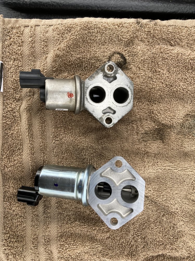

Well I just changed out the IAC valve and it made no difference. Funny thing is I gave my Ford dealer my vin number and he gave me the new IAC valve that is much bigger than my original IAC. Could the Ford parts guy make a mistake? Look at my picture the smaller one is the original and the bigger one is new.

So far I have used OEM parts from Ford dealer. I know Amazon sells counterfeit Ford parts so I do not buy there. I get a 30% discount from Ford anyway so very competitive.
Funny you mention that. I just looked around for a Motorcraft IAC for my '01 (I believe the part number is cx1851) and found one on Amazon for under $50. I thought that was a hell of a deal, but I am waiting for it to arrive and have "MotoCraft" stamped on it. We will see.
