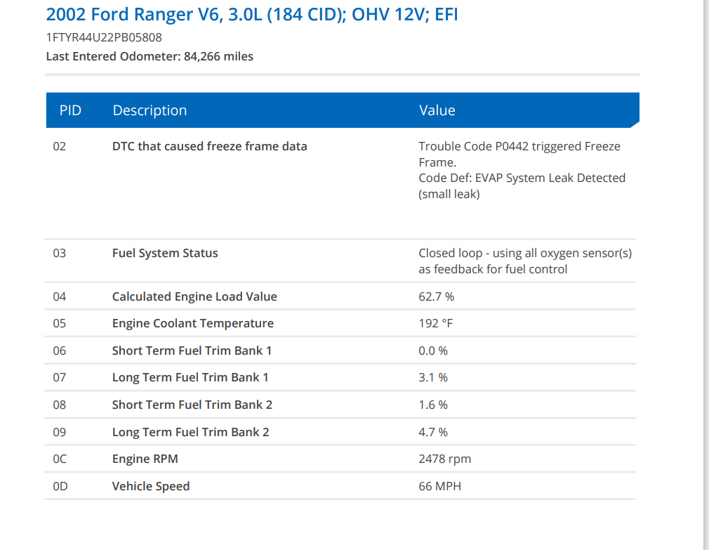

So We ran the OBD scanner is this is the freeze frame data when the CEL came on. Can anyone tell me if any of this data is suspect?
71222
All shown data looks fine
EVAP codes won't effect engine performance, worst case would be slightly higher idle from vacuum leak between EVAP Solenoid and engine's vacuum port for that solenoid

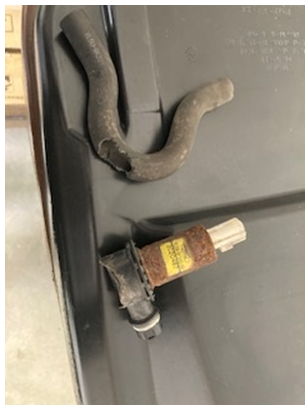

Just an update on whoever is interested. I replaced the Vapor canister purge valve and found what was causing it to stick open. The vent hose feeding it was in bad shape. Ford does not make this hose anymore so I got one from a pull and pay. So far its has been a couple weeks and no check engine light yet. I read in other forums that if your A/C system is low on Freon it will cause a rough idle so I had my mechanic check my system and was pretty low (- 1.0lb) it does idle a little better and I would almost say pretty good. Next thing I am going to do is clean the MAF sensor and intake temperature sensor. Looking back that should of been one of the first things I should of done. I will let you know.

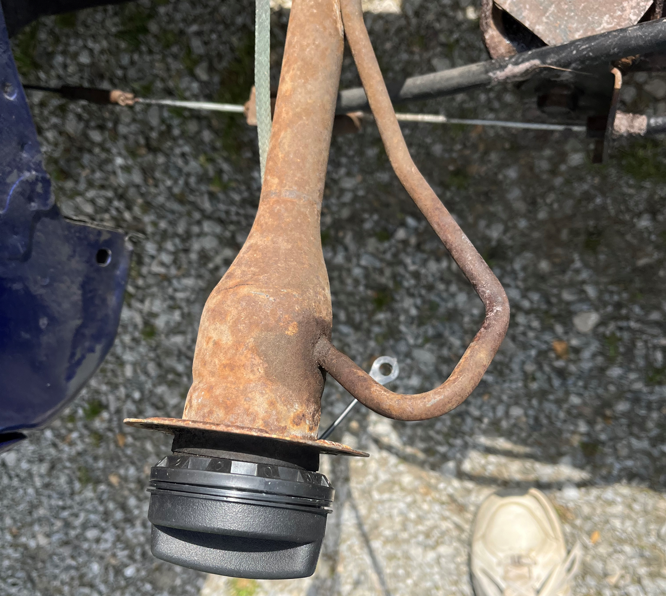

To those who have been following I found the cause of the PO442 code (small EVAP leak) My mechanic told me where to look. I love this guy he is so honest. I took my bed off and there it was. The filler nozzle vent tube has a hole in it. You can see in the picture that the vent has a gas stain on it. My check engine light has not come on again.
