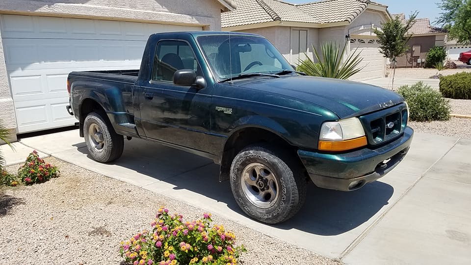

Do apologize for the long post, but want to explain everything that has been done so far. So picked up this little pickup recently and have been trying to figure out how to fix it. Body was in pretty good shape and only had 103,203 miles on it when I bought it. Now I know it was going to need some work, but I picked it up cheap! So brought it home and started to look into what was wrong with it. So far what I have found wrong with it:

Now since I replaced this sensor and still having the same issues, plus the speedo and cruise control works, WTF? Could I have bad wiring and need to tone the wires to see if there is a break somewhere? But even if I had bad wiring, then how the hell is the other components working? In theory, I shouldn’t have a working speedo and cruise, etc. I am scratching my head over this because none of my problems match what others have dealt with? Any suggestions?
