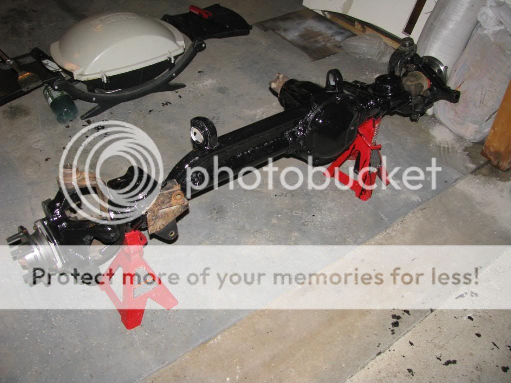

Got the axle back together, and was only going to paint the pumpkin and some of the truss, until my can of POR-15 tipped over on my plastic "drop cloth"...so I had to use it up somehow and ended up painting nearly the whole thing. Was going to leave the end part of the truss unpainted as I'll likely fabricate a track-bar mount off of it on down the road. Oh well, guess there will be some grinding and repainting in my future. Hopefully slag won't go everywhere and ruin too much, but I should have enough paint to redo it should I need to.

Slowly but surely. Gonna get my unit hubs machined to accept the rotors.
Hopefully before April's over I'll have the calipers and pads installed. Then it's pretty much only a tie rod bar left and time to wrap up the axle.
Though I'm still having trouble finding bushings for the top of the axle. Thought I found some on Summit but they were the wrong part. Anyone know where I can get polyurethane bushings for the top of the axle? :icon_confused:
