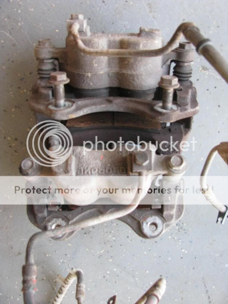

Went to an auto parts recycler place today and ordered my Akebono brake calipers and mounting brackets. Inching closer to wrapping this axle up for good. I didn't take into consideration that they may have to pull them from the vehicle (based on their TV ads I assumed they had most components off vehicles and inventoried), so I'll have to go back soon and pick them up.

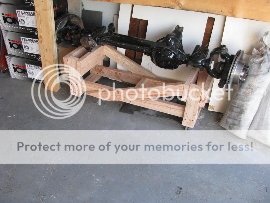

Picked up some Akebono calipers from an auto recycler...just under $100; and because my axle gets heavier and heavier and hard to pull out from under its nesting spot in my garage when I want to work on it, I made a caddy for it, and my back is happier for it.
