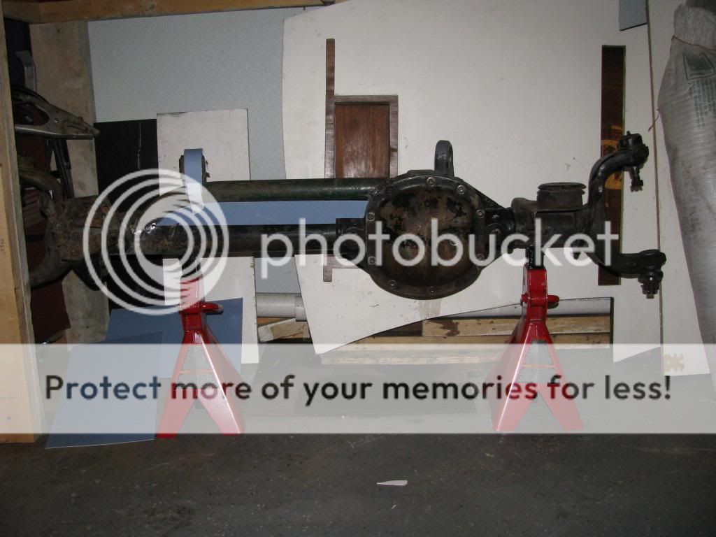

Spot welded my filler plate in between my truss and my axle last night. Hope to finish that up with the long weekend along with reinforcing the Cs somewhat. After that I hope to clean up the pass side upper link tab and integrate it into the truss better than what it is now.
Then it's time to buy new link tabs, weld those on and I can sand and prime this bad-boy. Probably won't put a finish coat on everything, as I'll eventually want to make a trac bar mount on down the road.
After that plans are to start buying the brake components to start getting that figured out and then I can reassemble this dang thing!

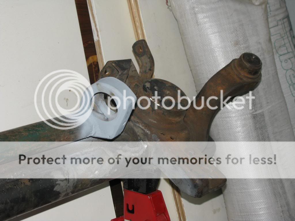

boxed in my upper control arm link, and got the filler plate burned in. Spot welds I started with looked great...so I forced myself to not get ahead of myself in fear of screwing up what I accomplished. Got back at it the next day, and it didn't turn out near as good...probably shoulda kept at it the first night. Oh well.

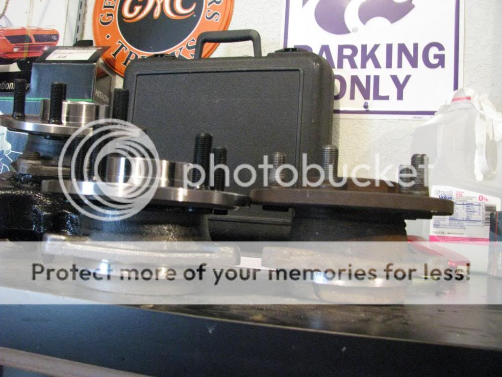

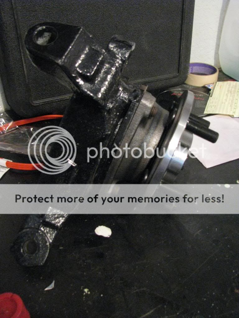

New Unit Bearings/Hubs!
2001 XJ versions so the lower deck height to help line up the future disks with the WJ knuckles
Got my link tabs burned in :icon_welder: today. Hope to be able to start putting this back together soon, just need to replace a ball joint I already replaced once before. My axle's just fallen off the jackstands way too many times that it's mess one up. But once I get the ball joint fixed, then I'll slap the knuckles on, and start putting this thing together. Likely next purchases:
