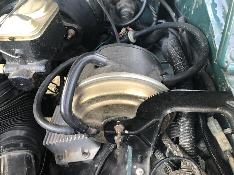

For the most part mine works great, sometimes it surges though. On our trip to Ohio it seemed impact related, hit a big bump and surgy surgy until I pulled the vacuum line off the servo. One time I hit a big bump and it got to surging and then I hit another railroad crossing and it came out of it. It only did it thru Illinois on the way out (they have a crappy highway), across Iowa, Indiana and Ohio and then the whole way home it didn't miss a beat. It did it again after it sat all winter... until I pulled the vacuum line off the servo and it has worked perfect for two days now.
Vacuum reservoir and lines were new last fall, I have tried two different amplifiers (one for a 2.8 BII and one for a 5.0 F-150, it hisses when I pull the vacuum line off (engine not running) so the checkvalve and dump valve are holding... so I did some digging and found this:

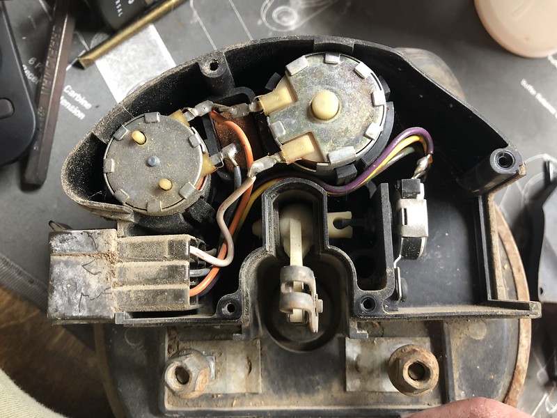

Kinda makes sense, the valves are gummed up and stick if it gets bumped the wrong way. Since it works most of the time I wondered how hard it is to clean and lube the valves in what I have... I have a kind of crusty looking spare so I did an exploratory on it... and I don't see much and the two motor looking things don't want to come out:

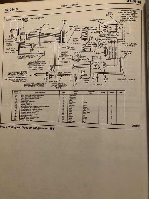

How the system works:
Speed Control Servo
Electronically the servo tests fine as per the EVTM, Ford shop manual and a neat thing I found here. The thread about fixing your servo looks like it might be in some other country (Australia maybe?) so they might have something different than what I have. I could keep grabbing them out of the JY hoping for something better or snag a NOS that might be a few years newer than what I have or get a $100 rebuilt one from who knows where... nothing really appealing and there is no actual valve test in any of the Ford literature I have found.

Not sure if that diagram is correct about the vacuum dump valve, but maybe I am reading it wrong
"Vacuum dump" means valve is closed when foot is off the brake pedal, pressing down the pedal "dumps" the vacuum pressure which releases cruise controls ability to hold throttle cable so basically an emergency back up to electrical deactivation of cruise control

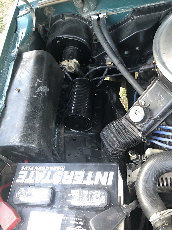

I played with it tonight. I started it and let it run for a bit and shut it off. I pulled the vacuum dump hose off the servo (far left side) and nothing happened. I pulled the main vacuum line off the right side and it hissed. I think the vacuum dump dumps the servo itself (I am picturing some sort of bellows in there) while not draining the vacuum to the valves on the other side.
And yeah, I added the "correct" coffee can reservoir on the PS fender late last summer. It wouldn't work at all without it, constant surging.
Speed Control Servo
And the reserve can has a check valve between can and intake(source)
Yup, you can see it in the first picture in my last post. It is the white disk in the main feed hose. If not for that there wouldn't be anything to hiss when I pull the main feed off the servo.
OK, thats not where a check valve goes
It needs to be between the can and intake, not between cruise and can
Intake(vacuum source)----------check valve-----------can-----------cruise
The can then has vacuum reserve for the cruise to use
Right now you just have the length of that hose as the reserve
Its been 4 years but I am pretty sure the donor had it where I have it.
The hoses to the vacuum can are 3/16, the ones to the servo are 5/16, I don't remember them adapting the hose bigger and then back smaller again.
I can't find a straight up vacuum diagram for the cruise system though.

Because you generally set cruise once you are at speed the vacuum in the intake is stable, so you probably wouldn't notice a difference
But because you are having an issue I would put a check valve between can and intake, you can leave the white one there, and that may have been stock location as a way to make vacuum more stable as the Cabs Vents and EGR systems shared the reservoir
And when you put in the can its check valve was left in donor vehicle, but I would get one
