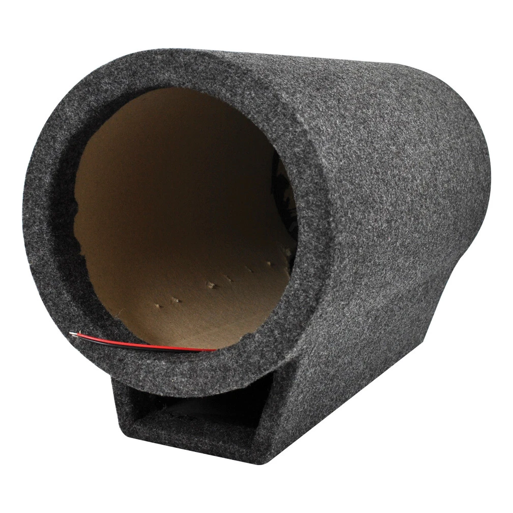

This looks like a good start to your project if you haven't got anything going for the center console yet, @Jtrussell1890! i believe it's particleboard, so it should integrate well.
Bass tube enclosure

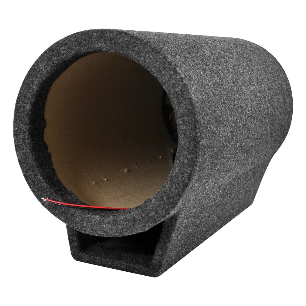

This looks like a good start to your project if you haven't got anything going for the center console yet, @Jtrussell1890! i believe it's particleboard, so it should integrate well.View attachment 137811
Bass tube enclosure
That's a great starting point, but I was thinking of a custom enclosure built into the center console with the face of the sub pointed at about a 40° angle towards the back glass. May still be a great item to start with since the diameter is what's needed and I could modify that to sit in the way I want.
