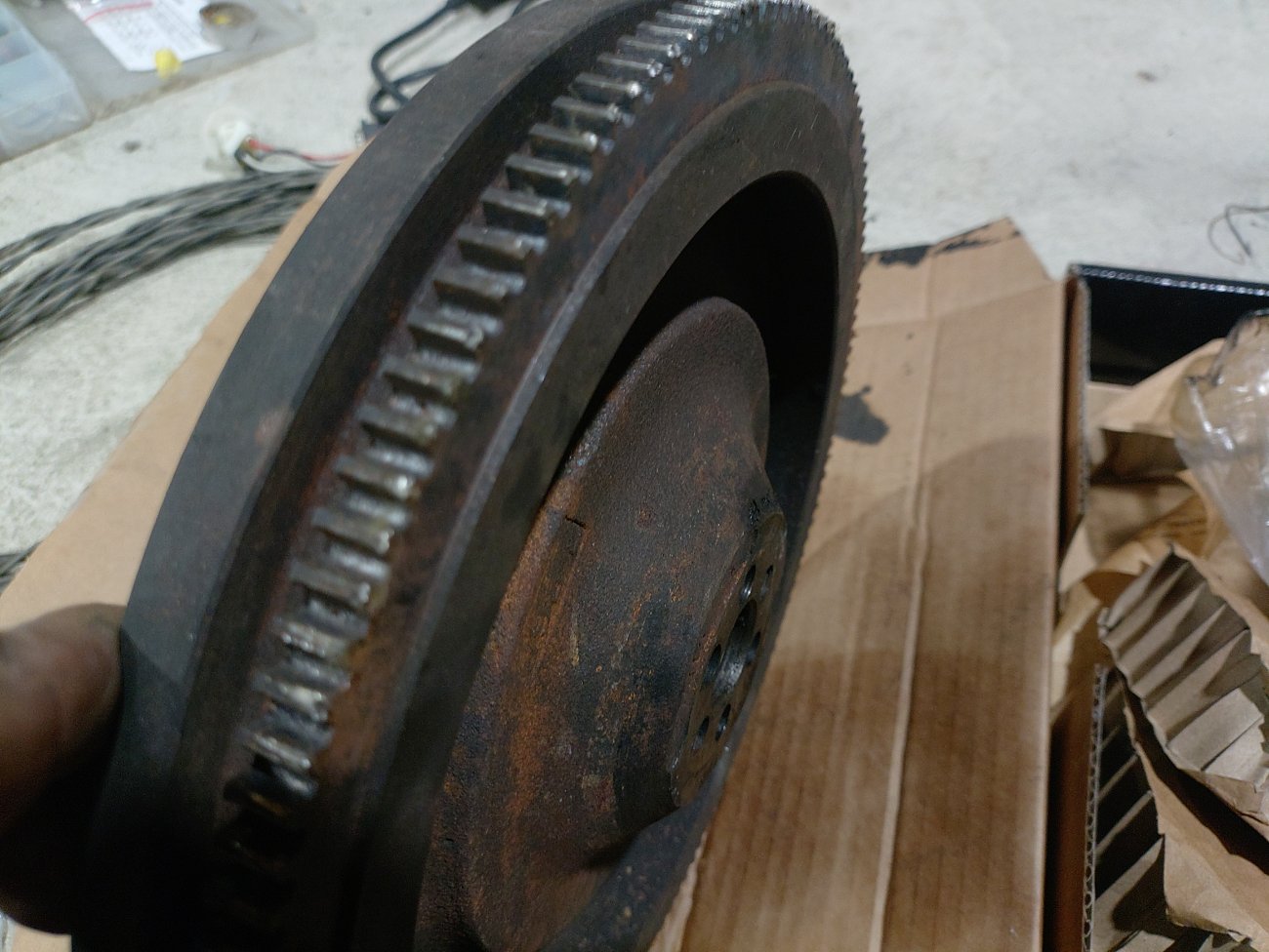

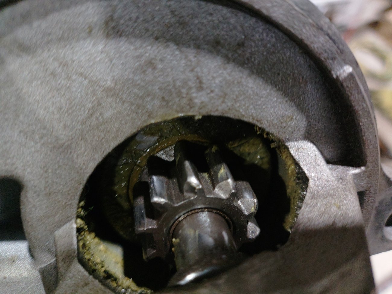

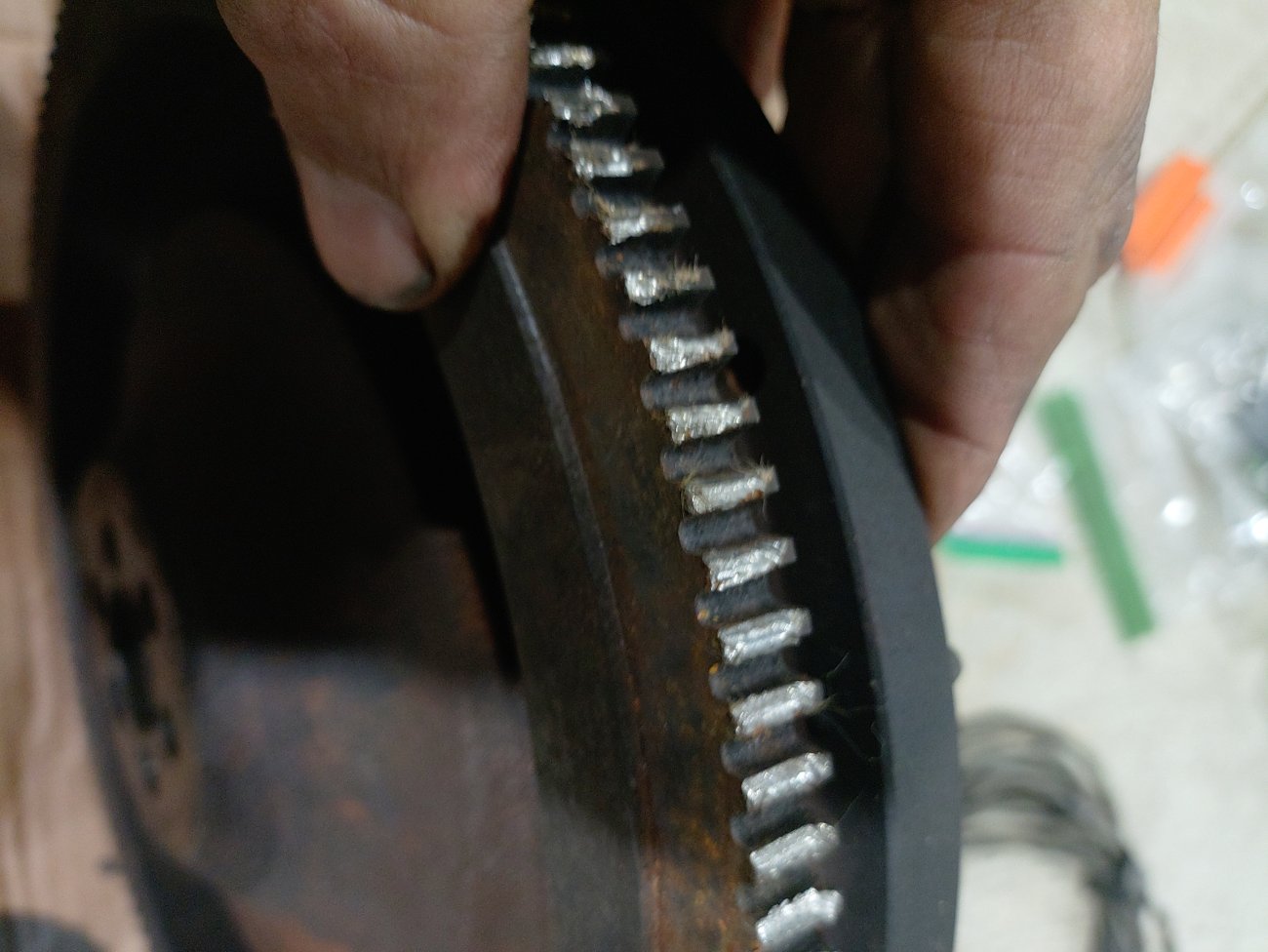

Well, truck is parked again...
It's grinding and is to the point where you can plainly hear that it's not grabbing all the way around the flywheel.
That’s unfortunate. Was really hoping we were past this problem.

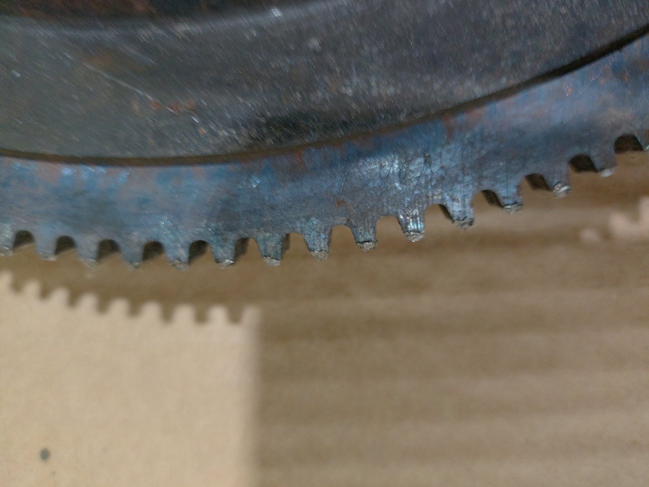

definitely need to pull the flywheel again then.

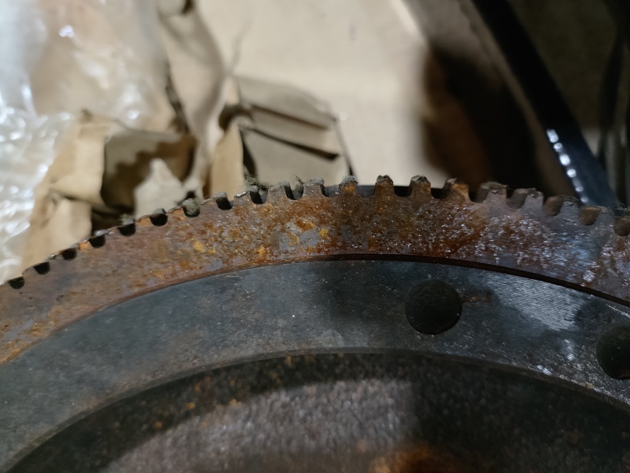

But I will put that ragged out flywheel back on as part of the process though.
if it goes about like i have my suspicions about....i might still be able to use that hosed flywheel.
if that is the case then there will be good potential options. if not....

I might give it another try of re-installing the starter and try to be 100% certain that as it is being tightened down the starter is as close as it can be to the flywheel (Which I thought I did last time?) but yeah.. it sounded exactly like how it did the other 2 times the flywheel got eaten up :/
@bobbywalter are you expecting that flywheel to mesh with the starter? Unless the teeth on mine basically got halfed in the bit I have been driving I had way more teeth remaining on my flywheel.. even the one that I already replaced was in better shape
