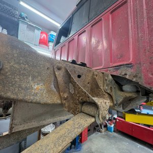

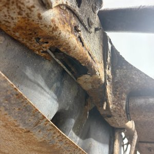

It was bought from down south so the frame is decent it only has surface rust.
