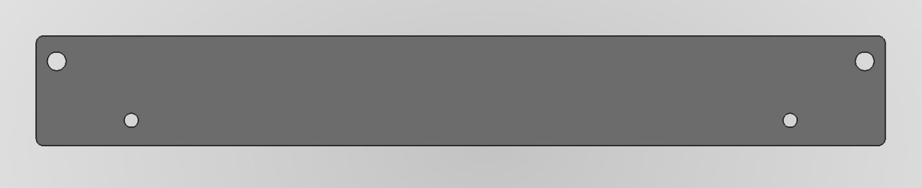

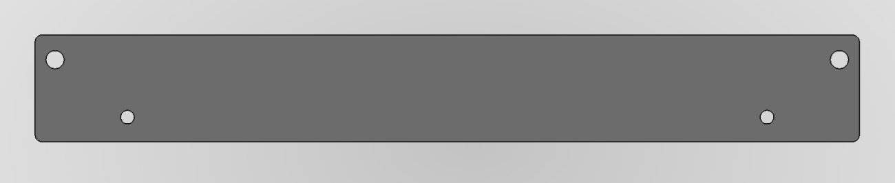

I put some buckets in mine from an earlier exploder but they weren't even close to lining up. I made a pair of parts like in this pic for each seat. 2 of the screw holes had to be countersunk for flat head screws so they'd sit flat on top of the tracks. It's a lot of screwing around but works well.

I like this solution.^

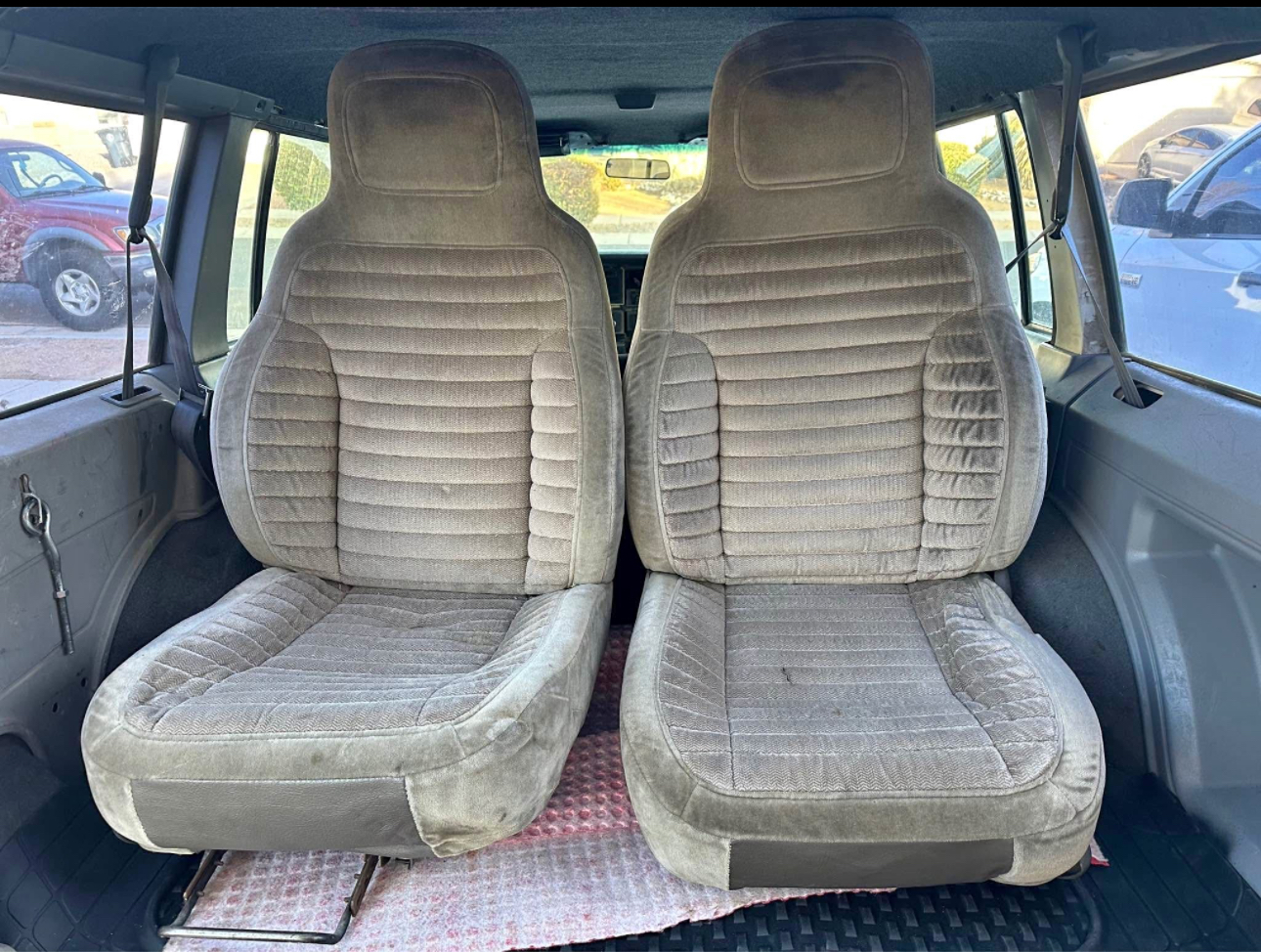

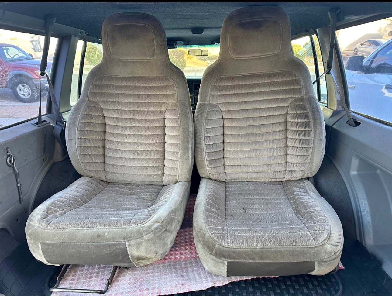

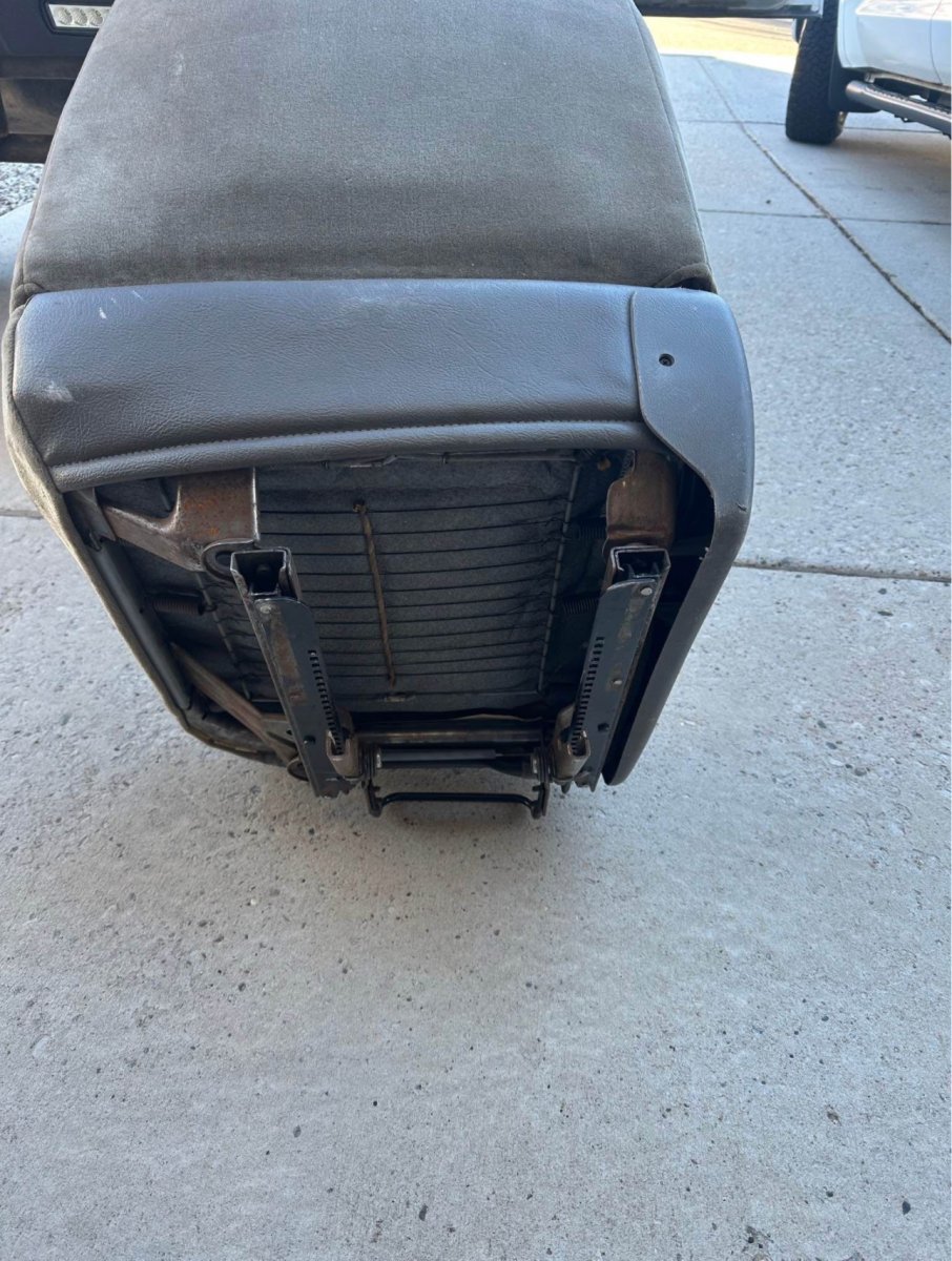

I’m mostly wondering because I found what seems to be a fairly comparably-sized 94 Jeep Cherokee seats online in what looks to be nearly brand new shape. I know what a problem people have with seat swaps in general, so I’ve had some major doubts about this one. Even if the seats do fit, I think those track rails look way too close together for a Rager.

I agree. Too close together but that would make making something like the adapter above easier. It wouldn't have to be countersunk. The bolts would just stick down under the seat. The question is how high would they end up? Only way to know for sure is a tape measure.
