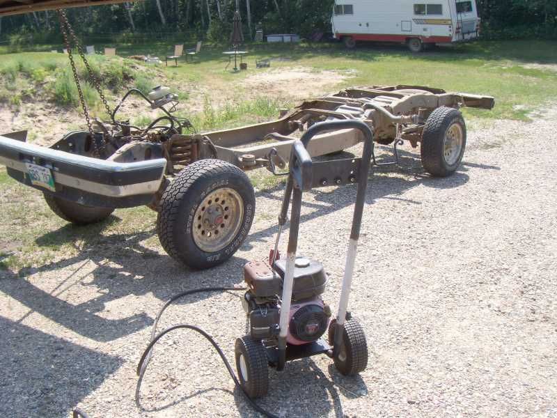

Dugan and I chased that problem to death, I don't know how long it was for him, but for me, we are talking 4 months !!!!
It's almost like it would run better on a full tank, BUT not always, replaced the strainer, and POOF ! problem gone, GAWD, it was that simple.
I had to take the box off anyhow.
he,he,he,he !!
