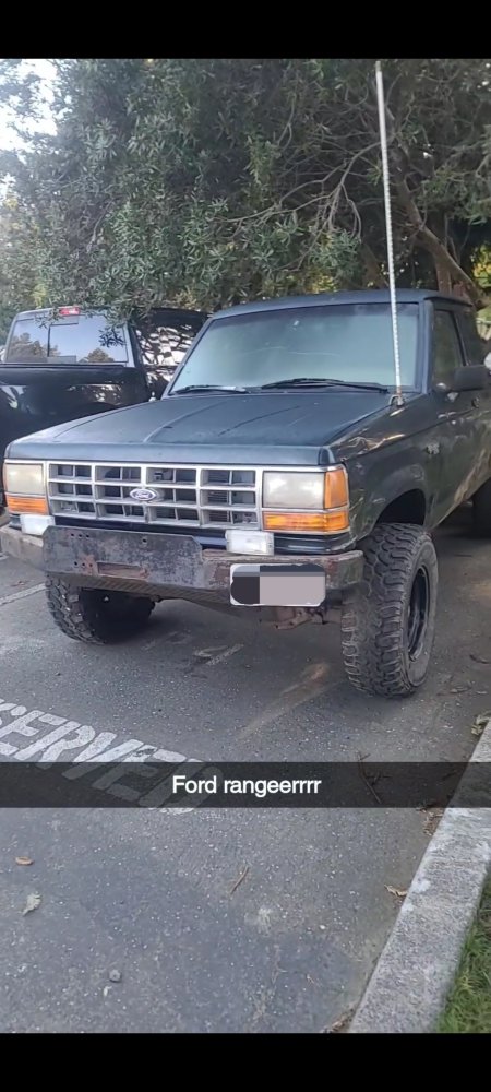

I picked up a 1990 XLT with 4x4 that had been sitting outside for about 4 years not running. Gone through and replaced gas, fuel pump, filter, oil, plugs, injectors, IAC and MAP.... Still idling at around 1200 and kind of bogs a bit on 1st gear and barely gets enough power in 4th and 5th.. Not sure where to go from here and I really need to pass smog here in CA 🙄
