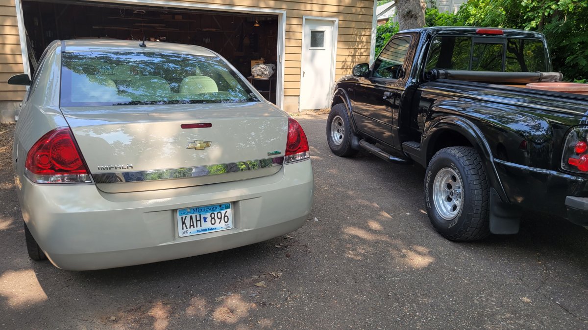

Here's a side by side photo of my Ranger in the foreground and my buddy's Ranger in the back. His was painted with cans. It doesn't shine like mine, but it would if he took the time to buff it. There was a Ranger plant here in Saint Paul. Another friend worked there. He gave us decals for my buddy's rear fender.
His freshly painted Ranger is in the foreground....
This is a 2008 (?) Chevy Impala with a freshly painted metallic gold "new" junkyard bumper. People say metallics are very hard to match, but thanks to NAPA, the paint is perfectly matched to the trunk.
BTW Those are polished aluminum ProComp wheels on my Ranger.

Not every NAPA dealer has a full service paint shop, but there is one here in Saint Paul that offers this service. They require both a VIN paint number and a BATCH paint number. You will have to call the Ford parts desk to get the BATCH. The NAPA shop follows the numbers but also looks at the truck itself and compares in order to make final adjustments by eyeball. They have been uncanny accurate. Your final color will be noted on their computer. After that, They will mix every spray can exactly the same. Paint technology has come a long way.
None of this is really hard.
