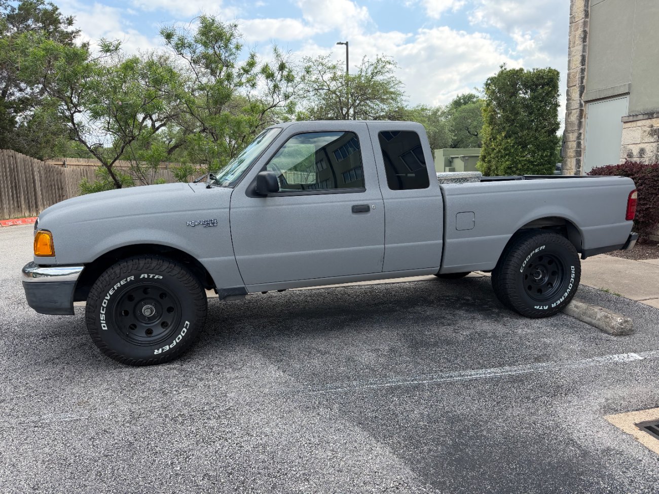

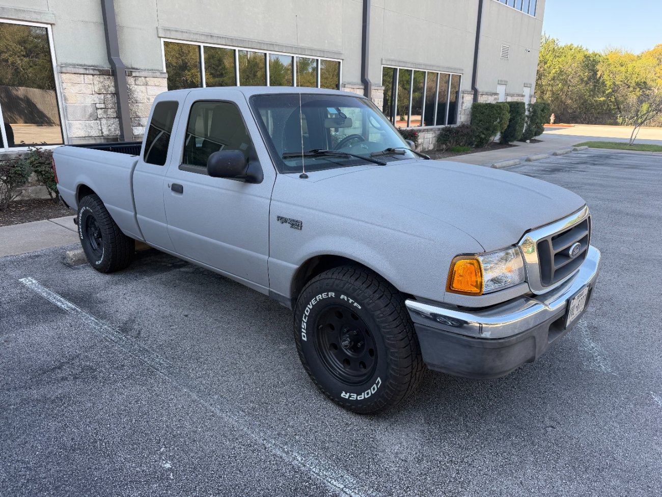

Added a 2" lift in the front and 1" in the rear to help with some rubbing. Before/after pics from the lift included.

In the second picture, you can see a thin metal ring between the hub and the bore of the wheel - the idea is to make the wheel "hub-centric" as opposed to lug-centric (just centered based on where the lug bolts are). I didn't think it'd be a problem, but no matter how I mounted the wheels, I was getting bad vibrations. Basically felt like an unbalanced wheel. I hadn't heard of them before getting my wheels re-balanced and truck re-aligned to make sure, so I'm guessing it's an uncommon issue.
In hindsight, I never tried a different set of lug nuts, so maybe the wheels don't like the taper angle of these, but it's supposedly the correct setup.
