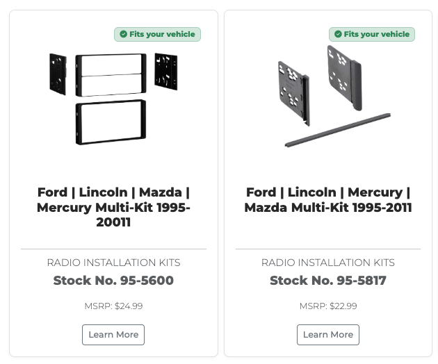

Considering replacing my OEM with an aftermarket double din. I looked all over and it's unclear if/how a double din kit is required. Metra says there are two kits available (see pic) for 4" double din and the 95-5817 says it needs "Sub-dash modifications are necessary to gain suitable depth and height". I'm looking at buying a used head and wondering if anyone has installed a used double din and dealt with this.

I’d get the 5600 kit. The modification is minor and you’ll never notice it afterwards.

The Metra -5817 is ass. It sticks the radio face almost an inch back from the front of the dash for no good reason.
I'm running American International FMK552 per old threads on here or explorerforum or something.
The Metra -5600 looks more-or-less the same.

In the end I got another OEM double din to replace my broken one. Not as musically fun but also less eye candy and keeps the original look. I did notice that most of the vids I saw using the kits had a fair amount of protrusion that looked funky but maybe the American International kit solves that.
