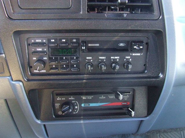

I have a 1990 ranger with the old cassette headunit pictured below. I'm going to be replacing with a pioneer HU. I need to know the proper way to remove it. What tools will I need? I also have a new harness that should work with the new HU. I'm going to be running it to two amps (A 2ch and a mono sub amp). Besides having to run the RCA plugs through a splitter, is there anything special I'll need to do as far as wiring (from the HU to the amps) goes?

you can either go to like best buy or a stereo shop near you and get the for keys to remove it. They are like 10 bucks or you can find an old metal hanger and make your own. You just push them into the two holes on each side making sure all 4 are in at once and you should hear them release. After you feel it release you can simply just slide the head unit out.
you can take 4 finish nails and inser them into the holes on the sides.
then when you have all 4 nails in or your tool of choice, just push the tools away from eachother to help release the clips.
makes life alot easier
Or... You could remove the dash panel, unscrew the headunit mounting bracket, and then remove the radio that way.
I think that's what I did to mine... It's been four years. I may have used welding rods to remove it. Just get two of them (no flux coating, of course), bend them into a long horseshoe shape carefully, then stick them in and push apart.
They are called DIN tools. and are very cheap, and once you learn how to install a stereo the tools will help you make money doing it for friends.
