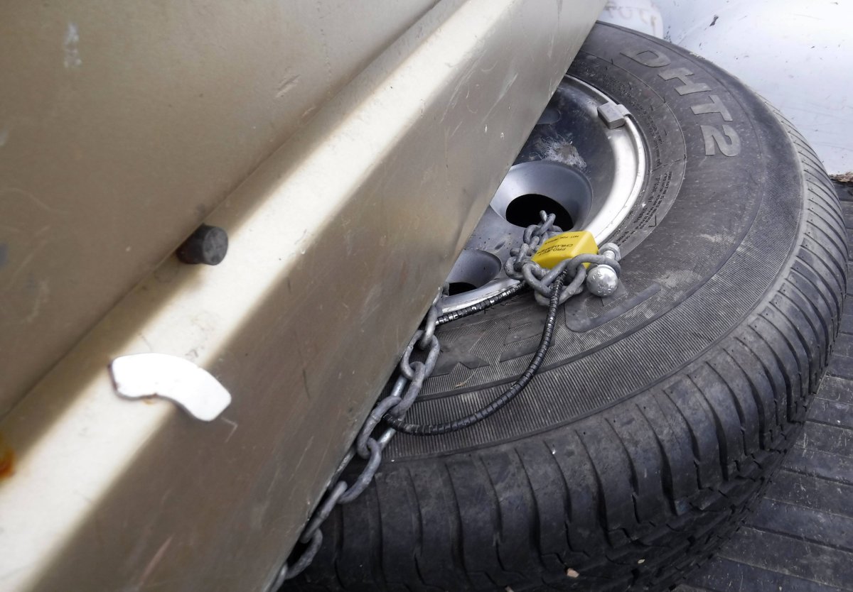

I prefer to have my Ruger lock on the spare tire (that should make somebody wonder where is my Ruger ;) NO, I don't go armed.
