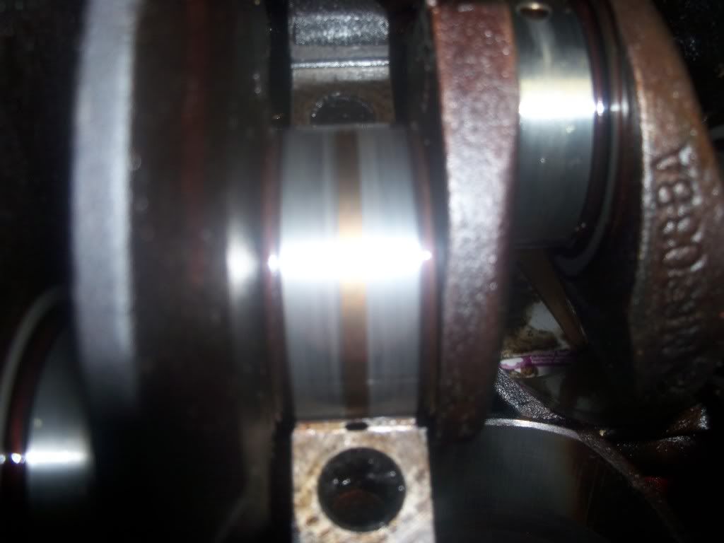

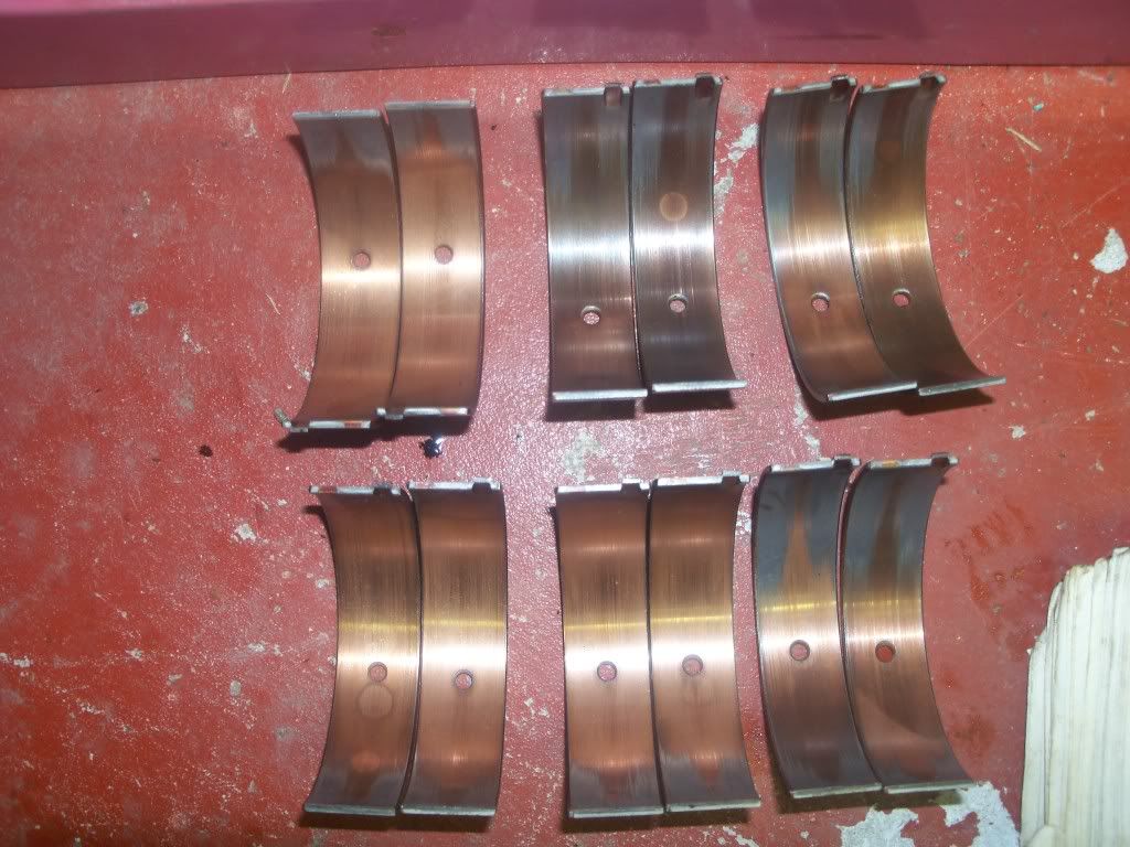

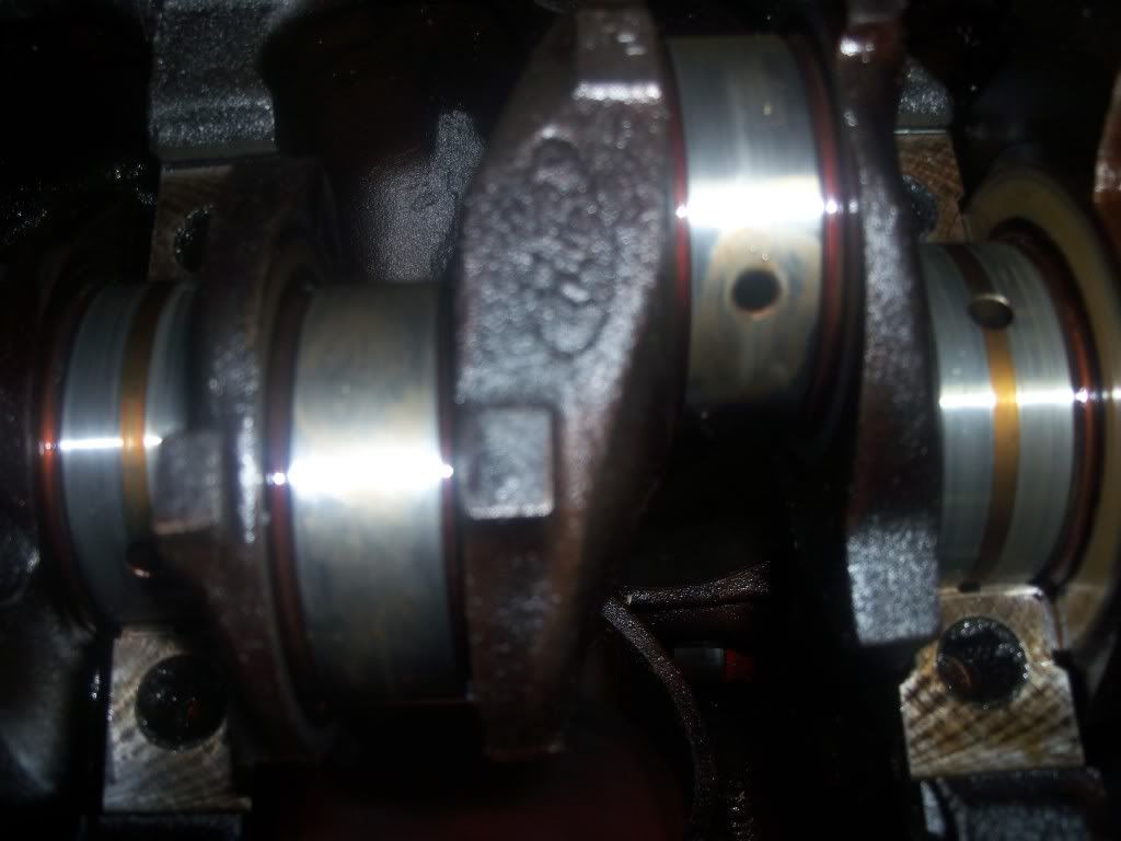

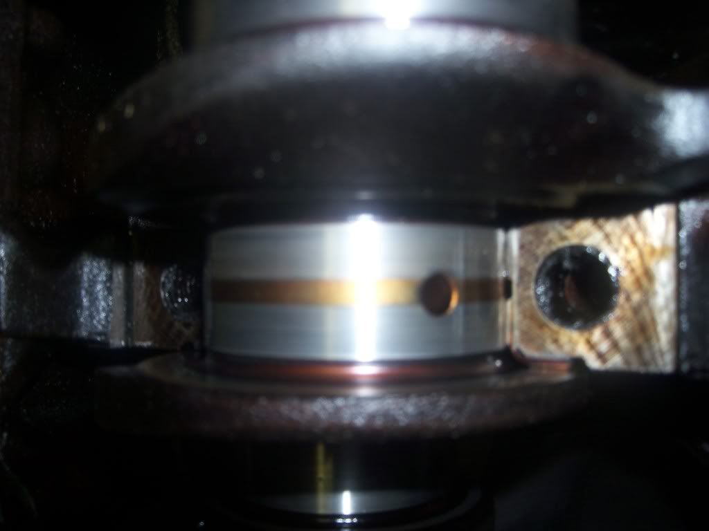

Here are some images of my crank and bearings main and rod. can any one tell from these if the crank will need turned or it is probably still within spec.
Looks nice, but only a micrometer will tell.
Will
Also, looks like you're missing some babbitt on those shells.
there is def some wear on all of them. it all seems to be where they meet on the crank. some worse than others.
Looks pretty worn out. U can always plastic gauge them to give u an idea on how bad. I good thing u decided to do a rebuild.
ok, the mains "appear" to be fine. The rods look like shit. You shouldn't see the copper. look at the bottom right rod bearing, see how copper is showing in the center but not on the sides??? that means the rods are out of round. the others probably looked like that at some point too but are wore beyond seeing it. You need to have the rods reconditioned. you should also have the crank checked out, for a few extra dollars it is worth your time, especially because of the extensive wear on the rod bearings.
