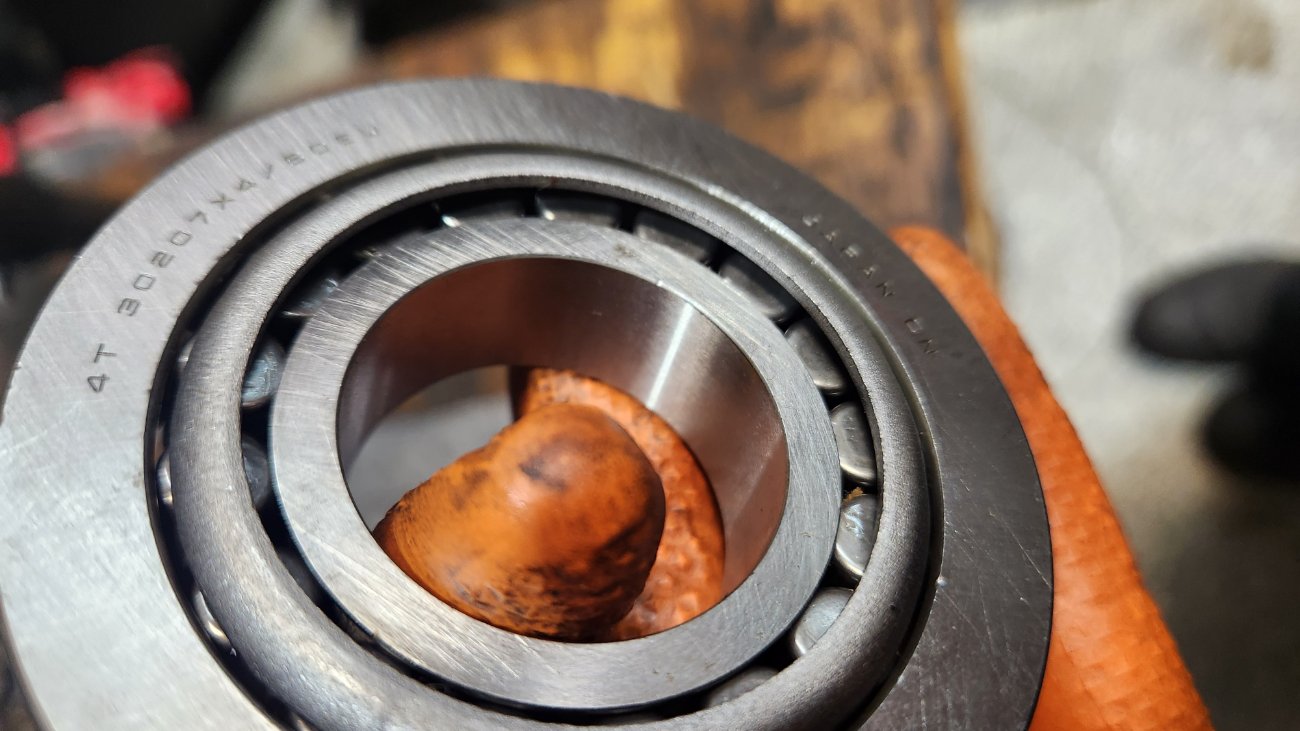

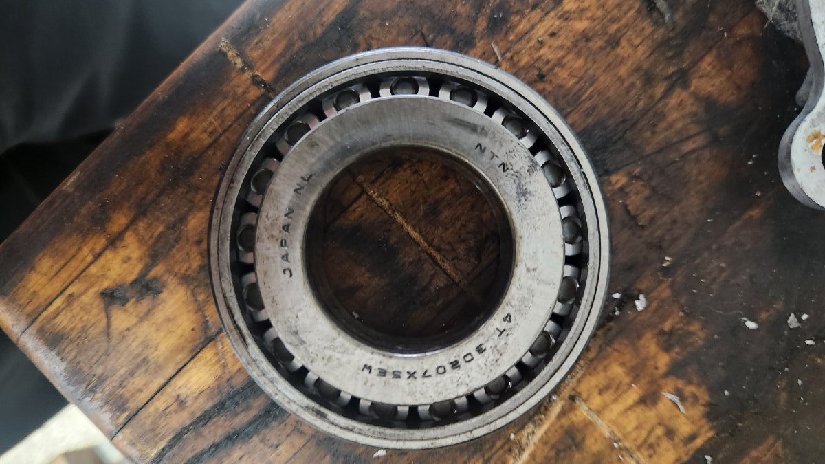

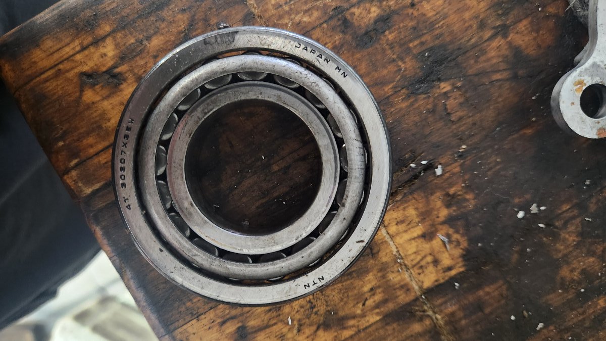

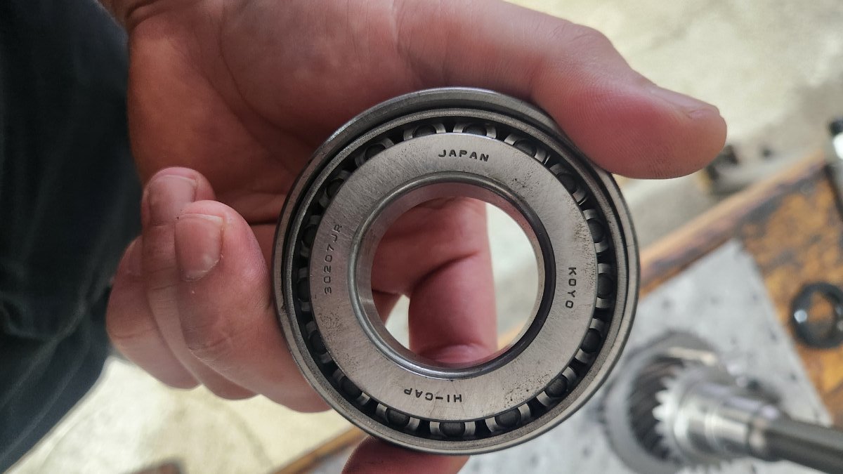

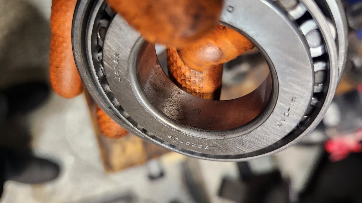

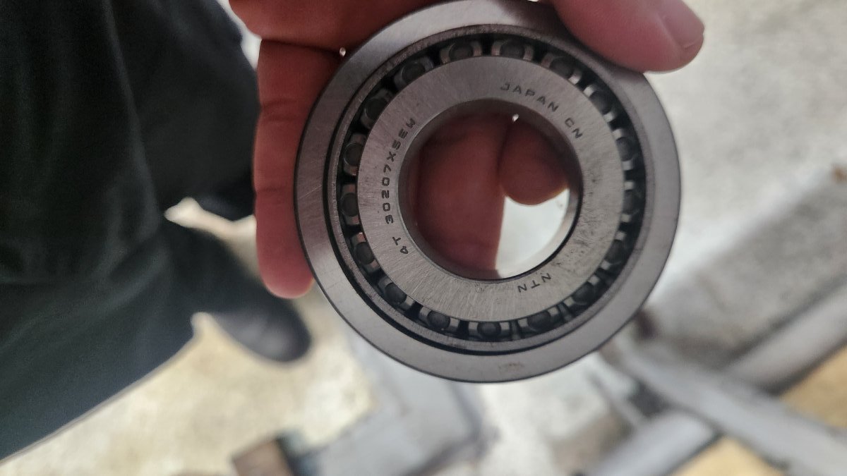

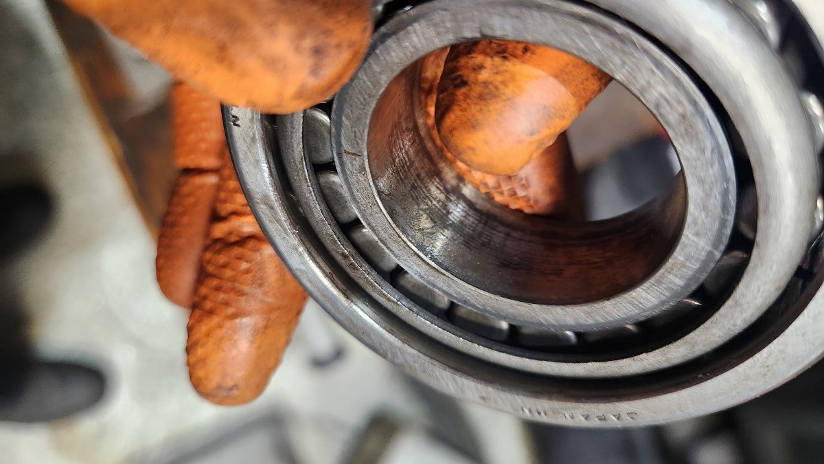

Ok, I'm kinda stuck.
Going to reassemble it and I found a difference in the bearing on the failed input shaft and the bearing in the kit I got.
1st and 2nd pic is the bearing that came off.
3rd and 4th are what is together in the pack and fit the bearing carrier but the inner race, that presses onto the input shaft, is different than the inner race on the old input shaft.
The last pic is the another new bearing, which matches the old input shaft bearing, but the outer race isn't for the front carrier. I believe its for the rear bearing carrier.
This is the 2nd trans but I dont believe its been rebuilt. I think it was assembled like that at the factory. Is that why it failed so early?
Or is it built correctly and the new bearings were packaged wrong?
Which race is for which shaft?

What's the issue? A quick Google agrees 30207X is the input shaft and 30207 is output shaft center. If one is Koyo and the other is NTN, the packagers can't have switched the outer races in the kit. I guess it's possible they threw the wrong input bearing outer race in there, but -X4/80EW and -X3EW both resolve to the same dimensions.
How does it not fit?
in the 4th pic the inner race has a wider retaining lip that the other two. that lip does not have a primary load on it.
while laying down, are the assembled heights the same?
will the replacement fully press onto the shaft? is the inner radius clearance adequate to clear the seating on the shaft?
on taper bearings the thin side of both races has no side load.
in the 2nd, 4th, and 5th pics the side shown goes into the housing, right? the inner race surface should not touch anything? right???
What's the issue? A quick Google agrees 30207X is the input shaft and 30207 is output shaft center. If one is Koyo and the other is NTN, the packagers can't have switched the outer races in the kit. I guess it's possible they threw the wrong input bearing outer race in there, but -X480EW and -X5EW both resolve to the same dimensions.

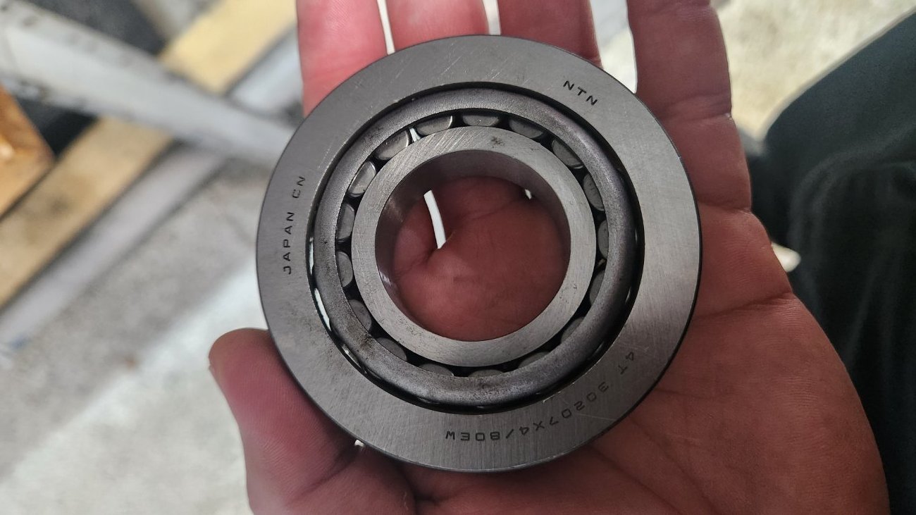

Hopefully the new pics will show this.
1st, old inner race
2nd, new inner race.
3rd , new inner race &bearing for the rear.
The inner races are different. The old inner race has a sharper inner corner while the new has a taper. I wasn't able to find specs on the angle of the rollers themselves so I wasn't sure if there were any other physical differences.
The inner race on the other new bearing (with the larger outer race) has a sharp corner which matches the other inner race.
I also pulled the old output shaft bearing off and its the same as the old input shaft bearing.
So why does the new set have 2 different bearing for the input and output shafts? That's what messed ne up.
