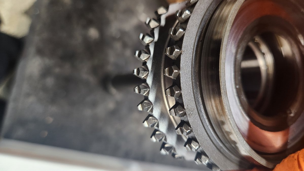

From the images it looks like the input shaft is broken right behind the small gear.
You'll have to pull the bearing off the back, and then remove the 5th/reverse gears, then pull the rear bearing plate/bearing to get it completely apart.
I thought it was just the dog teeth that gave but I'm not really sure what I'm looking at.

Your input shaft is definitely broken... look at THIS, must have just been a bad part or the pocket bearing is going out or something

The input shaft is separate from everything behind it, but the 4th-gear dog teeth are part of the input shaft.
You want a whole new input shaft for a 4.0 trans.

Ya, I called the place recommended for parts and the guy I talked to sent me a pic of what my input shaft should look like. Order for a new one is placed.
