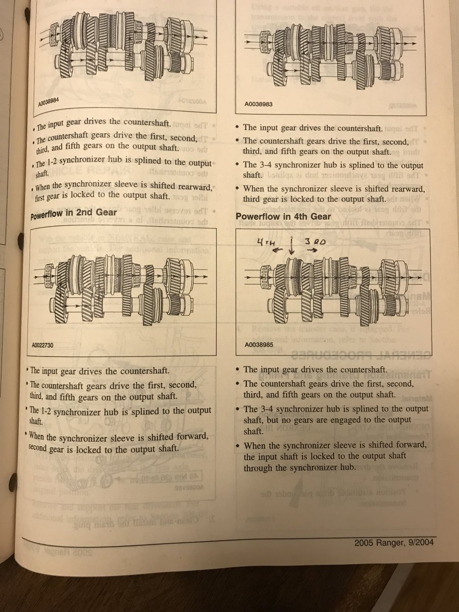

4th isn't a gear. the input & output are coupled together for a straight thru 1-1. it does not involve the counter shaft.
the 3rd/4th syncro hub locks the shafts for 4th gear.
Rebuilding a M50D-HD
I was wondering why the counter shaft looked like it has less gears that the input/output shaft.
So then 4th isnt locking. What needs to fail for that not to happen?

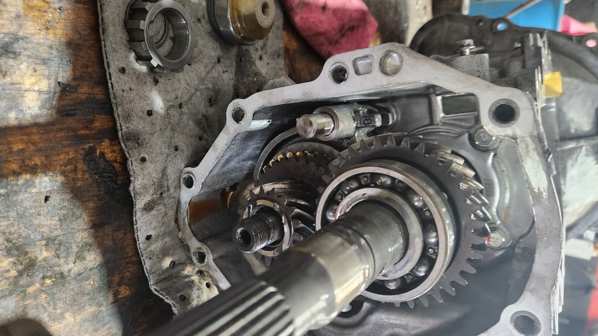

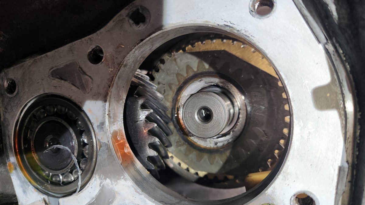

Got the trans somewhat apart. Im at work so I cant dedicate too much time to it as I'm flatrate.
But here is what I found.

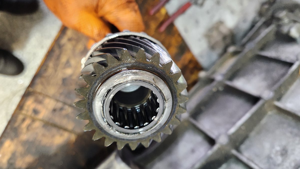

Inout shaft popped out and found damage. Not 100% what I'm seing though.

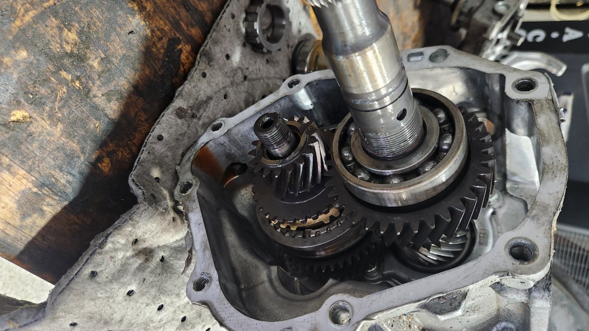

And this is where im at.
I cant get the back end out. Seems I need to take the top bearing off. But want to be sure before i out in the effort.
Any other details we should know when reviewing this damage tips? Am I missing something?
Also, proper nomenclature would be greatly appreciated. As it will make easier for me to ID what needs replacing and such.
Thanks in advance.

That's rad. I would also have voted "dog teeth stripped" rather than "bluetoooth dog teeth".
If you got super lucky, that could be the only damage, right? It's not like either of the pieces can move that much. I feel like I've even seen people say they can get the input shaft in and out without dropping the countershaft, although I never felt like there was nearly enough room.
The main output bearing does need pulled/pried off. There are a couple of writeups floating around.

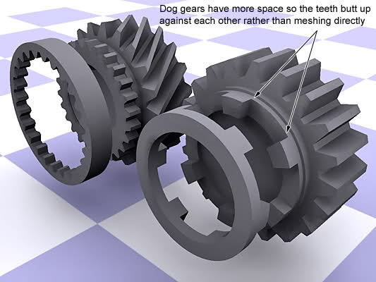

"This term "dog teeth" is new to me.
But a quick search showed me this is what they're suppose to look like.
Mine are FUBAR'd.
Safe to say this is my issue.
So, should I just replace those and reseal it?

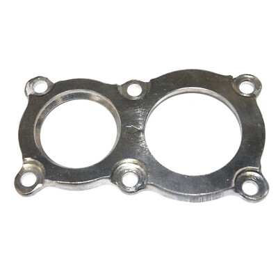

Whats the groups thoughts on the steel bearing housings?

I guess the technical term is "engagement teeth"? They don't go all the way around the input shaft like they do the rest of the gears. Yours looks fine per se (vs being stripped), just obviously the whole ring isn't attached to the rest of the input shaft anymore.
There was somebody else who talked about replacing the rear retainer plate because the output shaft pocket had worn too deep. All 3 of the ones I've taken apart were fine, in the sense that I could still shim the input shaft bearing to spec with the shims available.
Basically what you need is an input shaft, its bearing, and a shim kit. I would also do the slinger (white plastic thing on the input shaft) and the pocket bearing (between input and output shafts).
The thing is that like I said, I've never been able to get an input shaft in and out without dropping the counter shaft, and at that point everything is taken apart anyway. So then it's like, why not do synchros? Bearings? "Rebuild kit"?
You'll find the unique HD synchros are anywhere from unavailable to stupid expensive, which has come up a lot lately.
At the very least, I've always considered the main output bearing one-time-use after prying it off.
Ya, I didn't find any chewed up teeth.
I've seen videos of people removing and installing the inputshaft by itself but only on 2X4 versions. I cant find any 4X4 videos, granted I only spent about 5mins doing so. Lol.
I'm assuming I need to pull the output shaft to replace the dogteeth, ya? Seems its a press fit piece.
