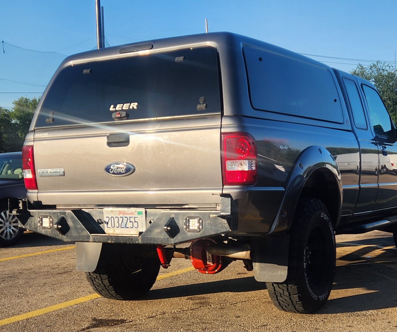

This bumper "bolts" right on.
Hitch and aftermarket bumpers with recovery points are usually what most people do over trying to bolt hooks on in the back. Stronger too.

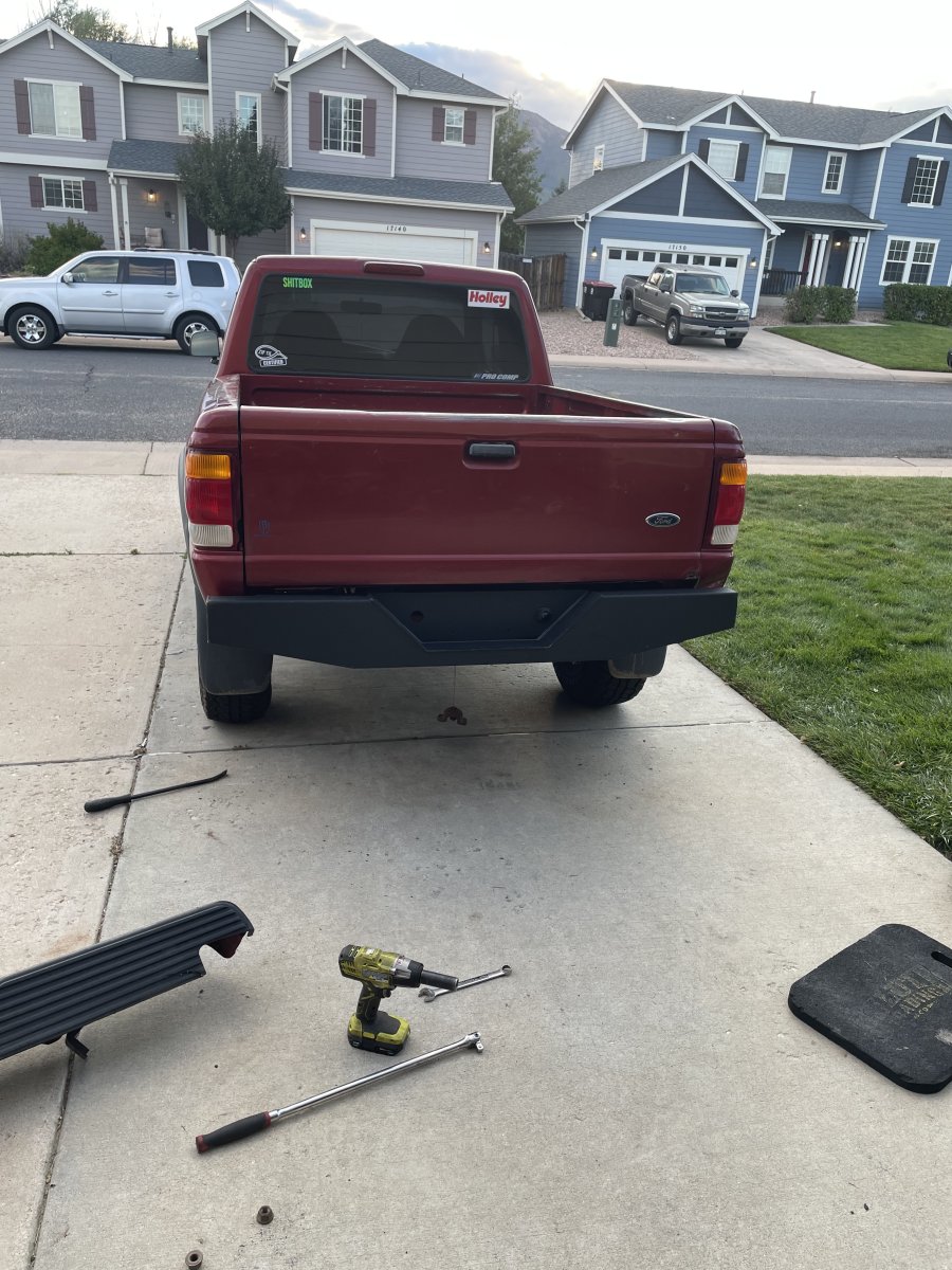

That’s the bumper I was thinking about getting I have an after market bumper on at the moment but it doesn’t have any form of recovery I got it so if I hit a tree or something while off roading it would be a cheap fix I was thinking about welding some D rings on to it but I just don’t have the time to design and figure out how to brace the bumper so it doesn’t fold when i inevitably use them

What’s your bumper look like?

It’s a pretty cheap steel bumper

I don't blame you, I lucked out and my brother got me a clearance universal fit receiver for my '97, if you can find one in a junkyard they'd likely be like $20 but I'm with Roert and would just weld D rings at the bumper mounts
