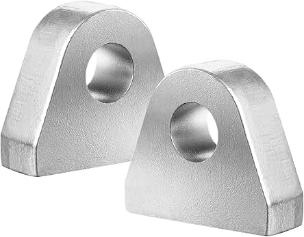

If you don’t want to weld, you can always get the D rings that bolt on. They sell them at farm stores. If you do it this way you can add an extra plate on the back side to spread the load.
These are probably $15-$20 per and you still need the grade 8 hardware to mount.
A set of 3/4” or 1” clevis mounts would be cheaper and stronger, but with these you don’t have to weld.
These are $25 on Amazon.
I have those top bolt on d ring mounts. Add some plates behind them and they are solid pieces.
