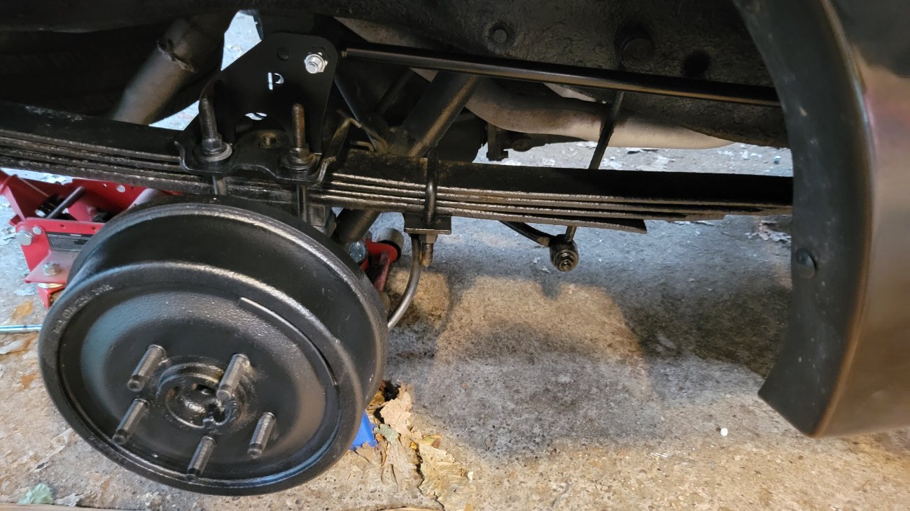

I do agree with everyone else, but here I go again, pitching the same old idea: leaf spring clamps. They stiffen the spring pack and help the sway bar to keep the rear end level to the road thus allowing the rear tires to get a little better grip. They also help keep the whole truck from pitching forward and down during panic stops, thus shortening your stopping distance by a few feet.. I've got two on each side, six inches out in front of the axle and six inches in back. Finally, they minimize axle wrap under hard acceleration. You can put on more if you like.
this is the worst thing you can do to a truck that gets worked....especially a 4x4 that gets wheeled hard....multi clamping.
this can pop load which is slip bind and reposition shackle location left to right and WILL break your springs at the center bolt on a truck that gets worked.
for a 2wd hotrod that does not get beat to death it is a easy way to improve roll center and wheel hop. traction bars or chains even which are the same cost work better.
You are right, but I load mine down all the time, even go off road, but I don't over load it. You are also right about traction bars. Thanks for mentioning this concrn.
