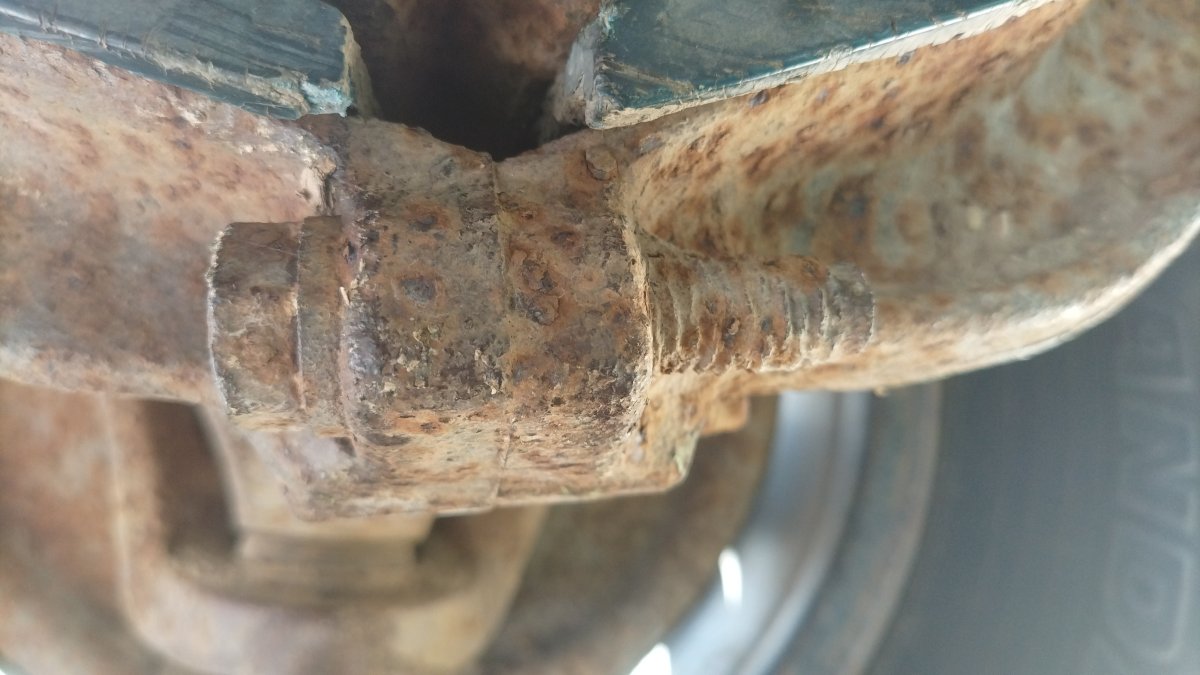

this bolt was new in 2018.

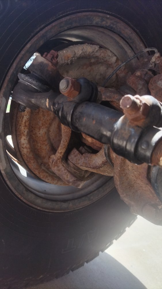

so...I cut the pins and now there is some wiggle on both sides, however the drum is still not turning nor does it want to come off..I sprayed a bunch more PB Blaster around the front for good measure but no dice so far.
Any other ideas at this point?
Are you able to back off the star wheel on the adjuster?
