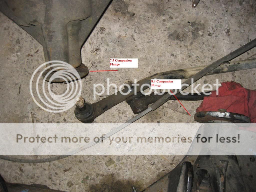

For your comparing pleasure:
You can see that the 8.8 flange is much thicker.

Ok thanks for the pic adsm08 that helps visualize it better, so if I were to swap the end of the driveshaft to accommodate for the larger flange of the 8.8, will I be able to use the same u-joint on my driveshaft or is the hole on the flange a different size if so there are u-joints made for that type of situation correct like top and bottom are one size and left and right are another size if so anyone have a proper name for them and if possible sizes or diameters would be awsome. oh and are the bolts the same size and threads on the 8.8 and the 7.5 driveshaft to diff. if not just grab some for the 8.8 in that case. and the only reason I would have to get different u-bolts and plate would be if I were to put in the 31 spline axle right, tubes are the same diameter 7.5 to 8.8 right thanks to all.
