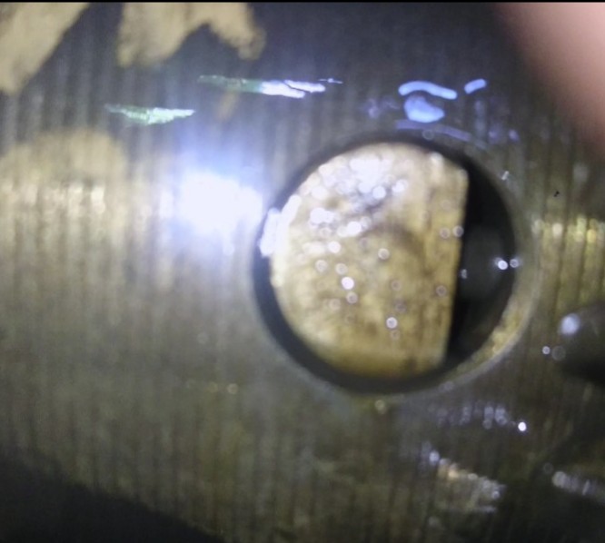

Need help, I have a 1994 Mazda B3000, with Dana 35 axles.
When I serviced the rear axle (replaced the axle oil seals), I found that the cross pin was some play in the carrier. This is all stock, mileage 120,000 miles
You see how he plays in the video. Then I turn the cross to 180 degrees, and the "playing" practically disappears. So, the question is - can I assemble the differential with turned (rotated) cross pin, like a photo below?
thanks)
In other words, can I put it like that?

I would measure the hole for out-of-round first.

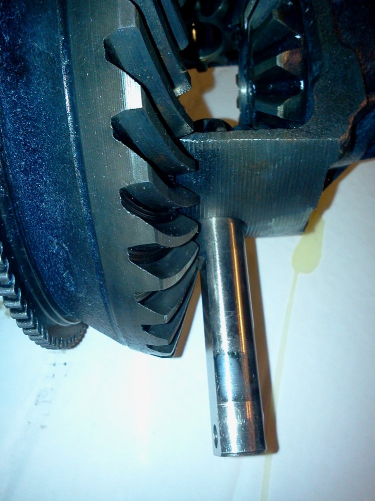

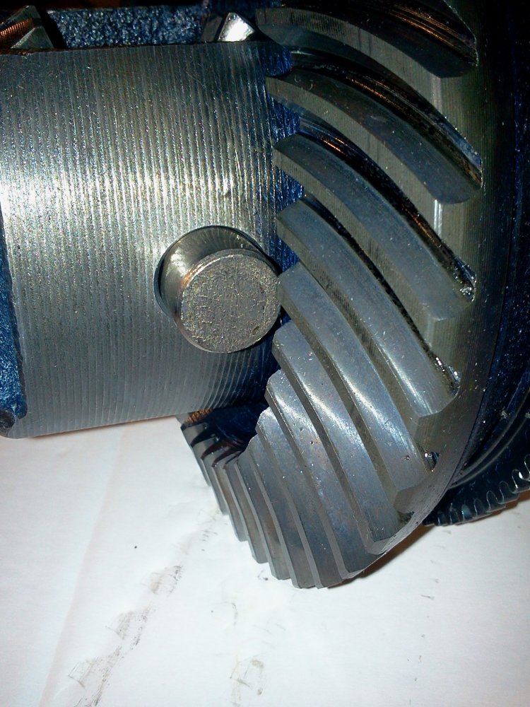

OK, this is a Ford 7.5" from a 1999 Ranger with a 4.10:1 gear ratio. it does have some play at the pin, the pin itself has no wear.
depending on the gear ratio the pin may, or may not come out.
with the 4.10 the pin does not come out unless a tooth is ground for clearance, or the ring gear is removed.
you cannot even get both spider gears out until the ring gear is removed.
in the first pic the pin is out as far as the notch allows, it is still inside the spider gear.
the second pic is the non-notched end of the pin showing the interference.
63318
63319

As you have it part way apart, I'd measure hole with micrometer - if its out of round, you want to get it fixed before it is catastrophic.
