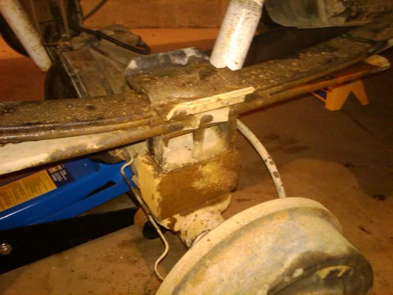

Alright here are the pics...here is what I started with...a 2 inch block STACKED on top of a 3 inch block. It had HORRIBLE axle wrap, and my springs were inverted (stock ranger springs).

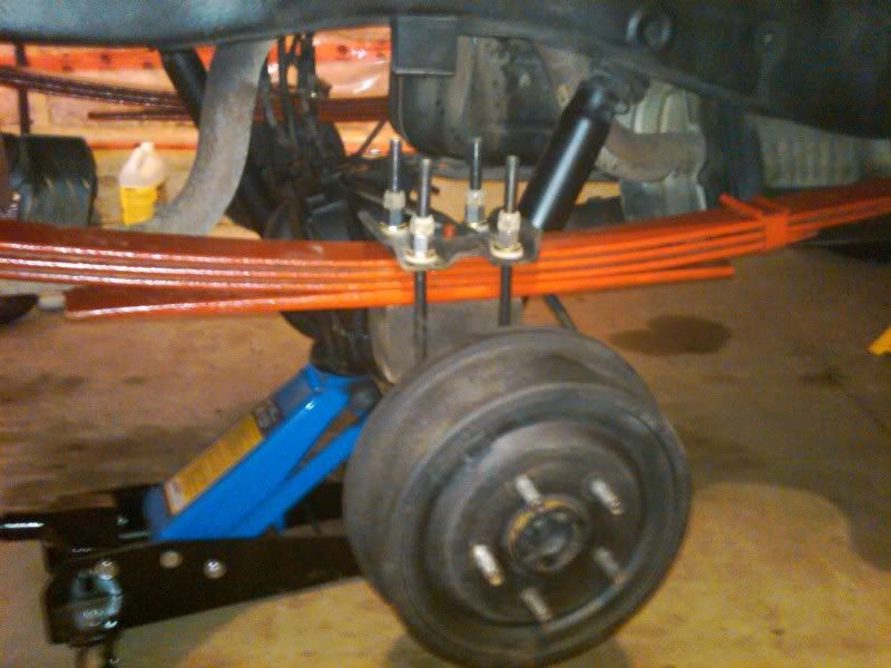

Heres the new set up...explorer 4 leaf pack with a 3 inch block. I double nutted the u bolts just to be safe.
Overall Im quite happy, i have little if no lift, but I managed to get rid of the 2 inch block. There is no more axle wrap, and it drives so much nicer, the ride is quite a bit softer. I think it will flex out quite a bit more as well.

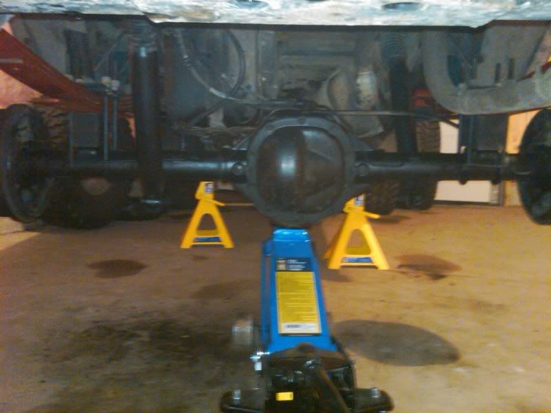

Its not a good idea to jack up under the pumpkin on an axle with pressed in tubes. It can tweak it a little a stress the bearings/fatigue the axle shafts.
its a ranger, there's no weight back there

so you can just swap out the ranger leaves with the explorer ones without any mods? they are the same length? cuz if so thats what i wanna do here soon.
They are a direct bolt in swap. The only modification to the Explorer springs is flipping the centering pin over.
yeah its dead simple, sometimes getting bolts out of the bushings isnt easy though...they like, to rust themselves in there good. Make sure to soak those centre pins in penetrating fluid for a couple days as well.
Its a SuperCab 4x4 though. There is a decent amount of weight back there.
