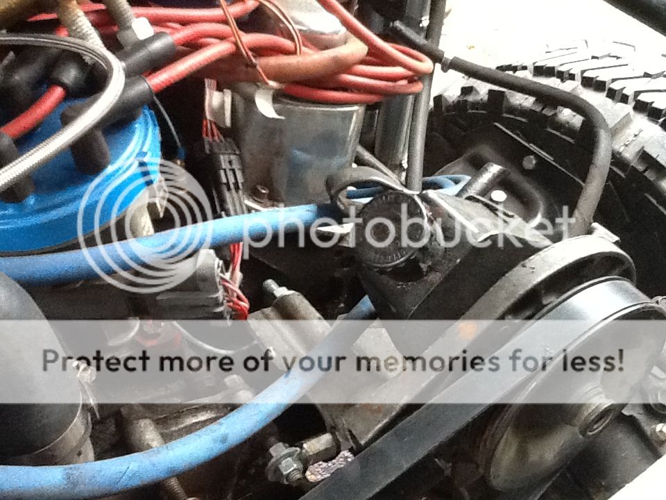

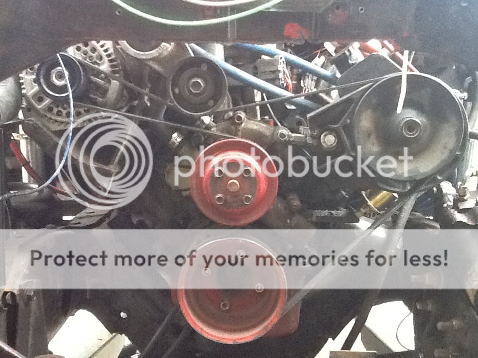

Also power steering pump wasn't having it went and got a pump off a ford van. Saginaw pump and bracket ended up having to modify the bracket and make the pulleys fit the belt. That's why there's a little adjustment with the rod coupling and bolt in the picture.

You'll notice Saginaw pump installed too. It's sweet. Steers much better.
