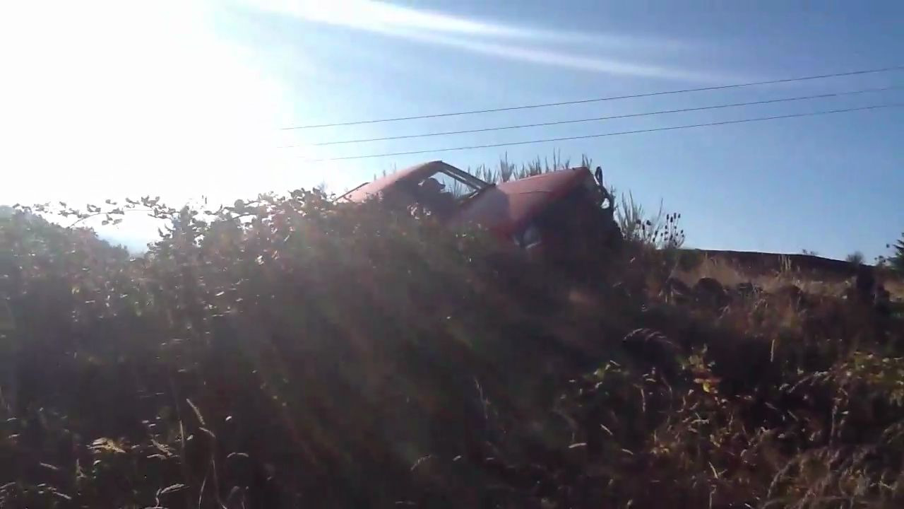

Thanks might have to get it running today.
congrats man truck is so boss i want to do a sas on a 94 ext cab 5 speed 4bt w/d44 and d60 but keep it mostly stock ride height w/ 02 superduty wheels and cv shafts up front instead of u joints in the axle still be able to use as a dd cuz ik my 347 wont be
Wow Sweet Build and Sweet Rig ! , I've always wanted to do a SAS and Thought about only using a HpD44 up Front and 9" Rear , Only Plan on 37"--38"s , But now I'm thinking Otherwise , Great Build !! .
