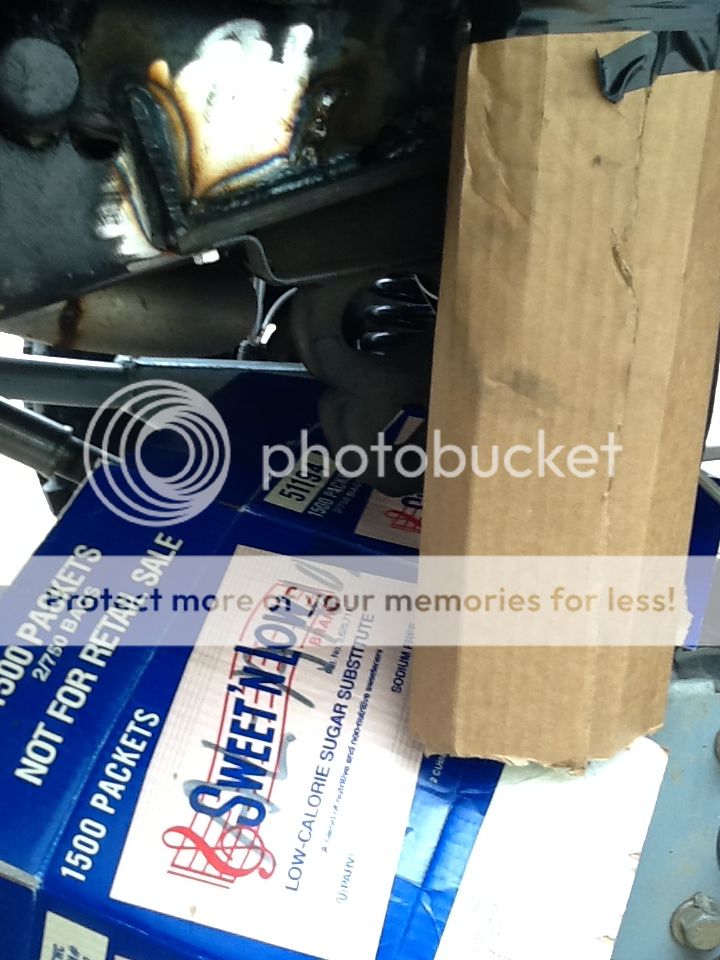

Finally replaced rear spring bushings which were hammered after 110 miles. The inner metal sleeve was wider than the spring so it just slid back and forth tearing the rubber out. While the springs were out I discovered a sheared center pin. This has me kind of concerned so I replaced them and bought a couple spares. good news a lot less body roll.
Got more little stuff done front shackle mounts from Barnes 4x4 new ubolts for rear axle old ones were shot. And finally got around to front bump stops. They are rear bumps tops from a Nissan pathfinder. I've got 5.5" of up travel which should be enough for the dunes.
