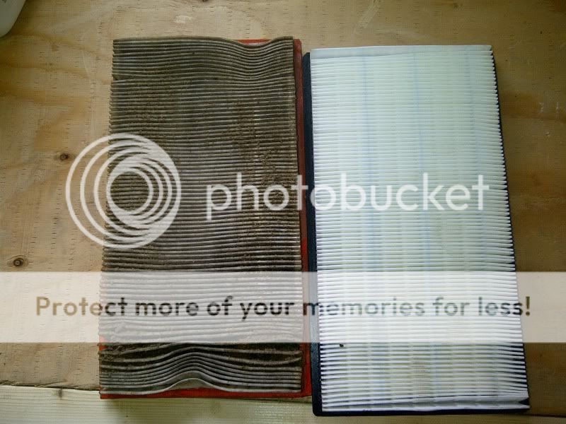

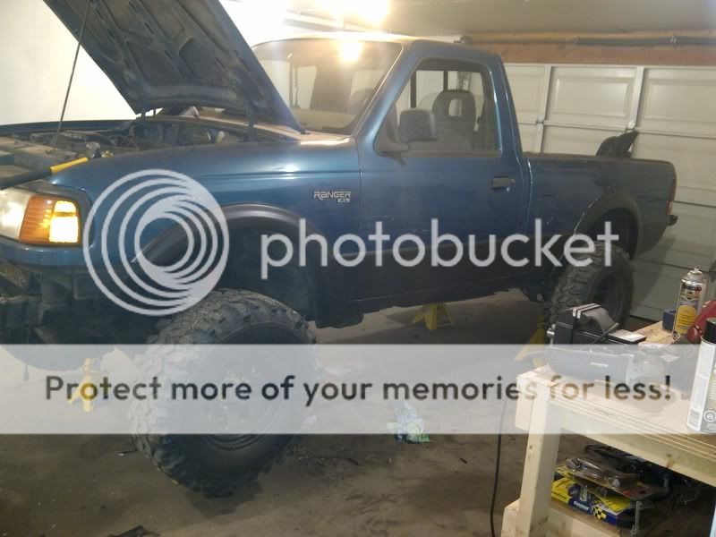

did some maintenance on the ranger, changed oil/filter and changed the air filter....guess the last wheeling trip was a little messier than I thought :D
well got the itch and started doing a bit of body work....

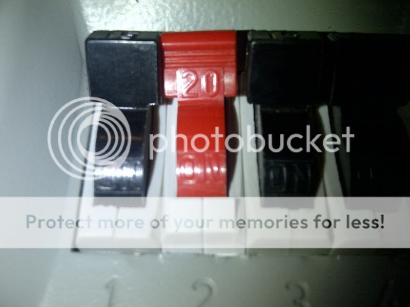

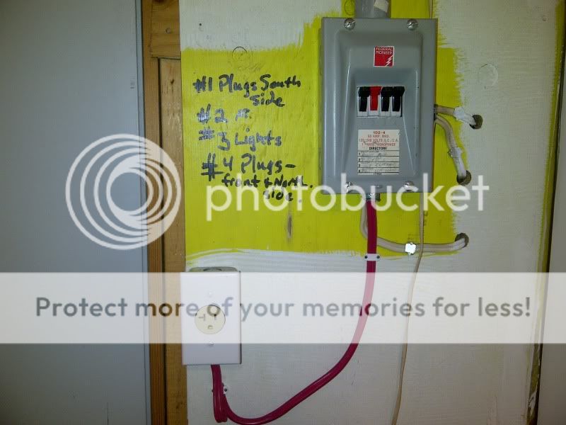

Welder works awesome. Figured Id do a bit of electrical however to make it perfect. The welder will use 20 A, and all the plugins were 15 A. I could have just dealt with blowing breakers, but I would rather not. I had an electrician buddy help me out. There was a breaker not being used in the panel, so we swapped it for a 20 A breaker (red toggle), ran 12-2 wiring, and used a plug rated at 20 A. Should ensure I dont have any problems and can weld without worrying about the electrical system.

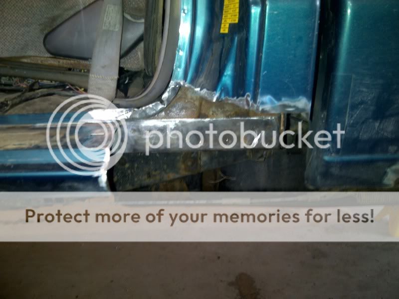

Then got the cab corner trimmed up and burned into place.

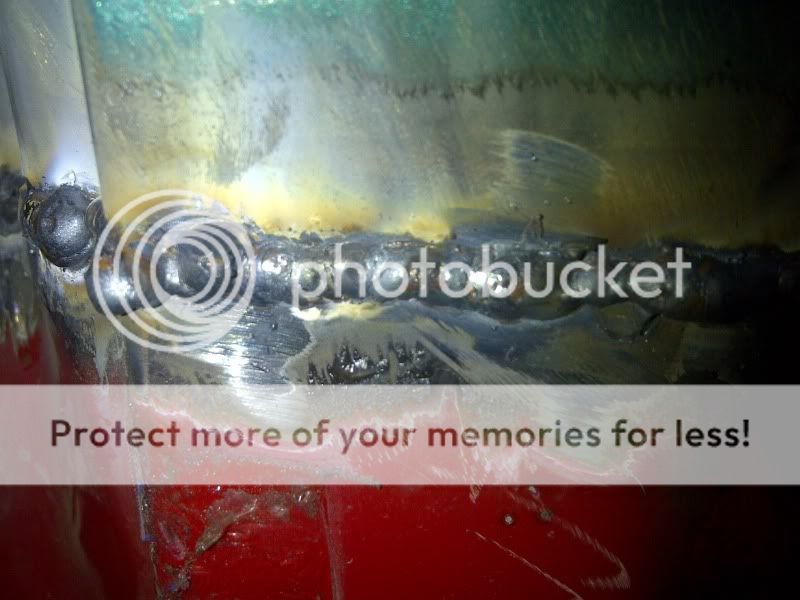

body work welds....for those who dont know, body work involves a TON of small tacks, as to not burn through the metal. It will all be ground down later

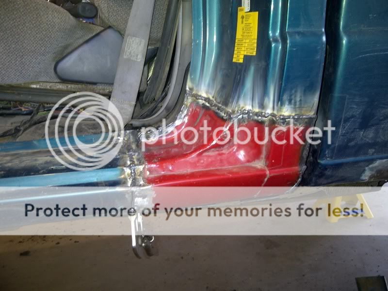

Got the cab corner finished...welded and ground smooth, no need for body filler on a trail rig.
primed
painted

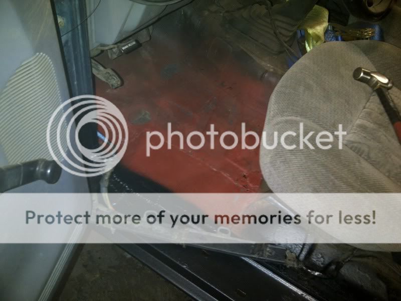

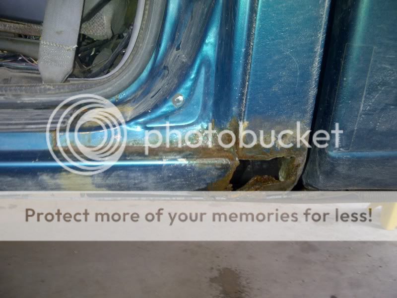

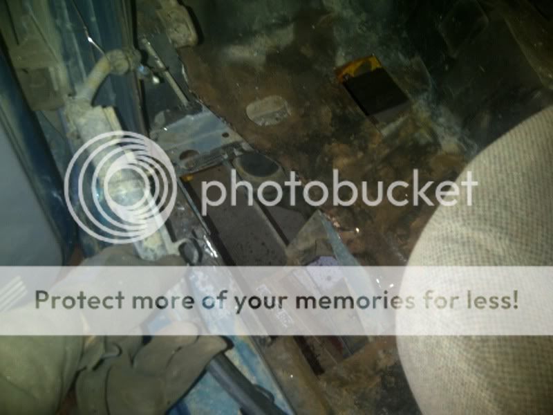

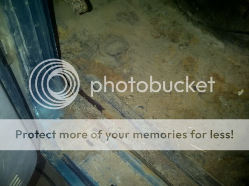

then attacked the rusty floor
cut out bad parts
and patched and primed, I also painted it, and am going to fibreglass it.

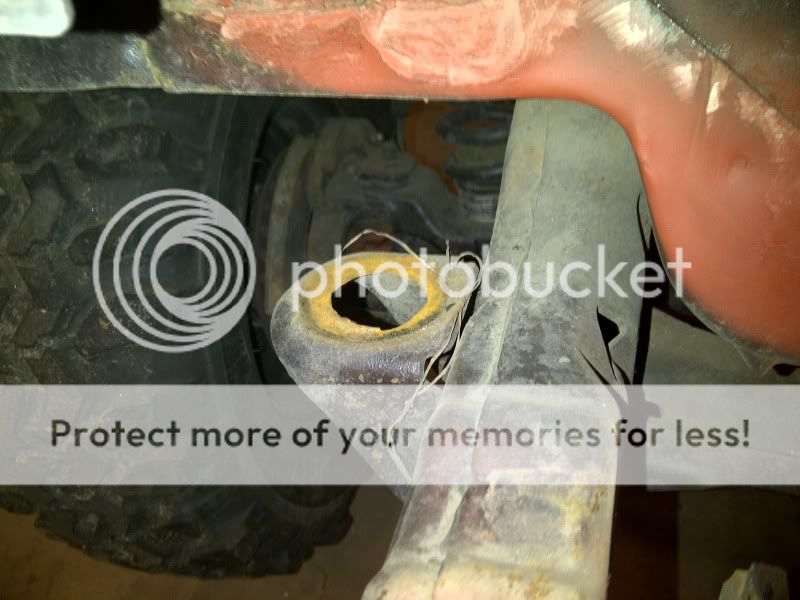

cab mount that was broken
fixed, also notice that I started hacking apart my bumper/mounts....going to be putting winch plate in soon.

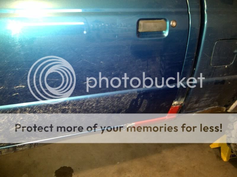

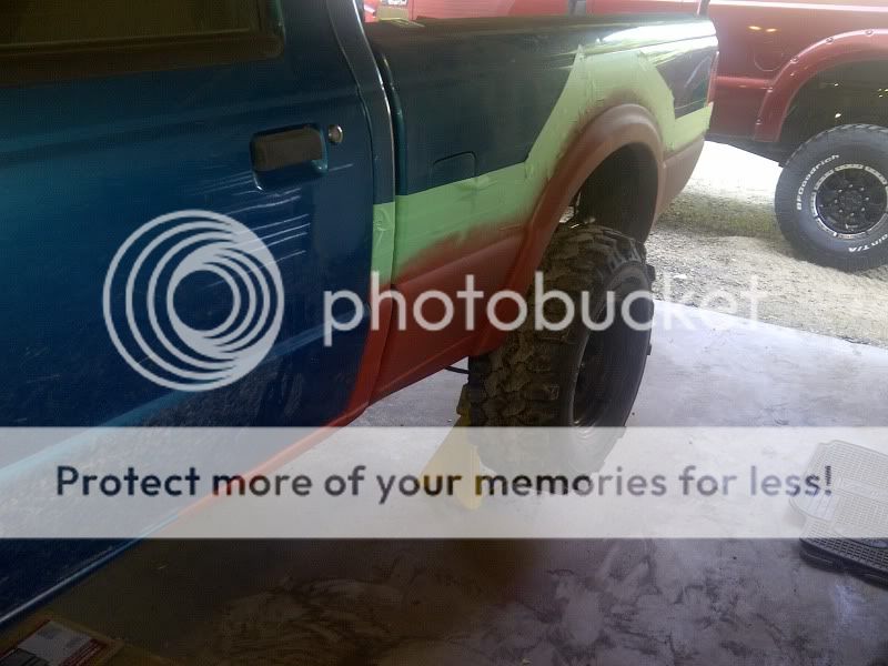

and painted flares/below body lines.

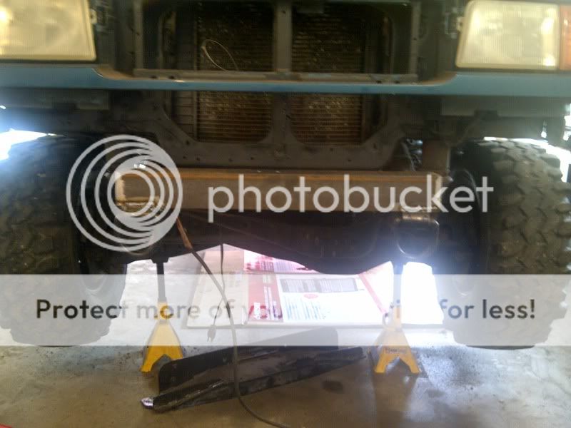

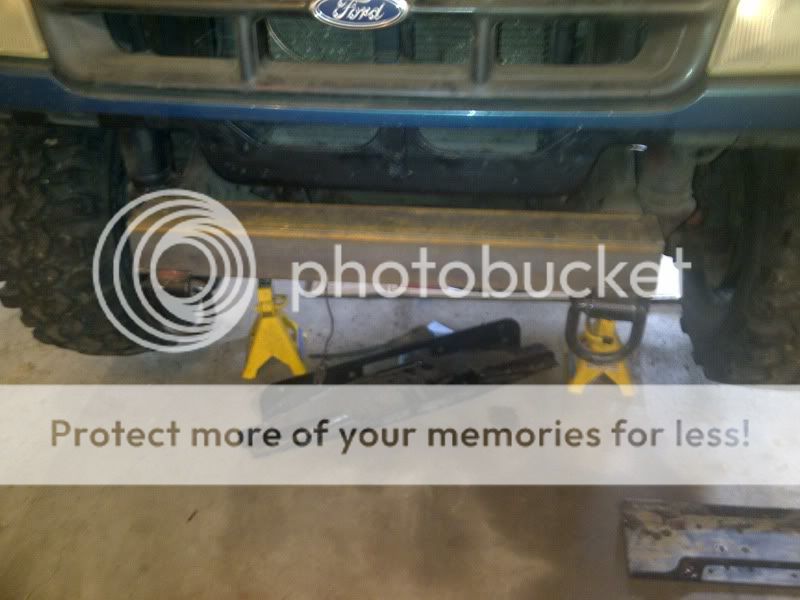

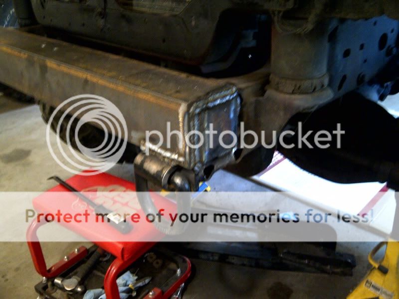

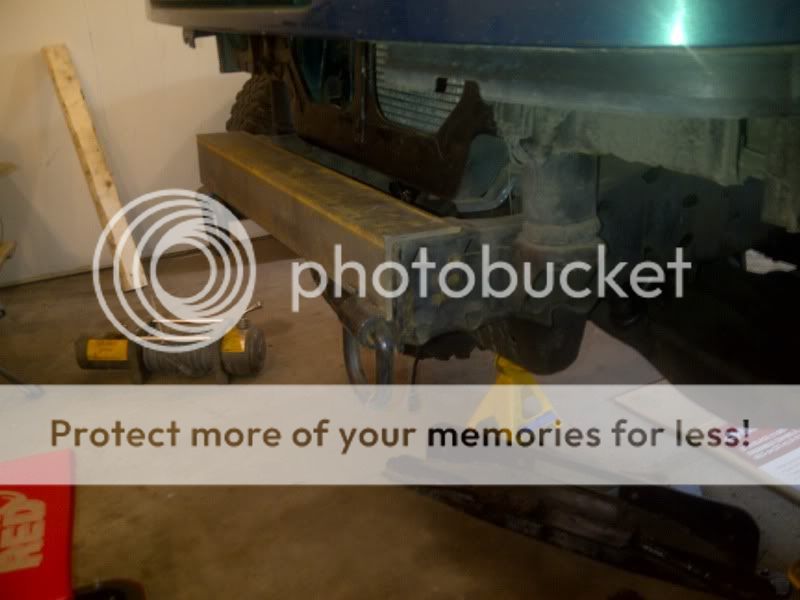

Well started on the winch bumperish type thing...
cut a piece of 1/4" angle to fit.

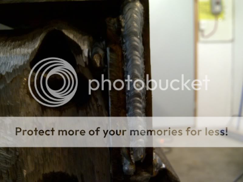

and started to burn it in.
the Hobart Handler 135 is a great little welder, loving it so far, and as you can see, can burn a decent bead.
