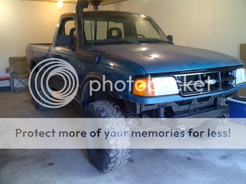

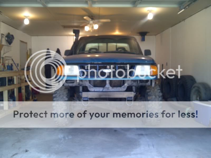

and on July 30 Im going racing with the Ranger, mud racing :) so Ive been tuning and doing little tweaks to get it ready for the mud bogs. Hopefully Ill be able to get video of the races. Entering the stock class, I figure I should be light enough to do okay. I finished welding the front cross member, and will build a bumper off of it eventually.
Front crossmember is finished. Did a bit of tuning to the Ranger, getting her ready for the mud races.

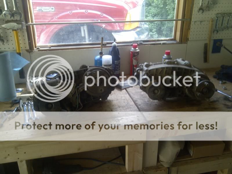

First swapped out t-cases. The one in it had a small leak, but after a wheeling trips worth of abuse, was leaking almost a litre of ATF a week. I had this t case from my old ranger that DIDNT leak, so I swapped it in.
also, you can notice Duty through the window :D

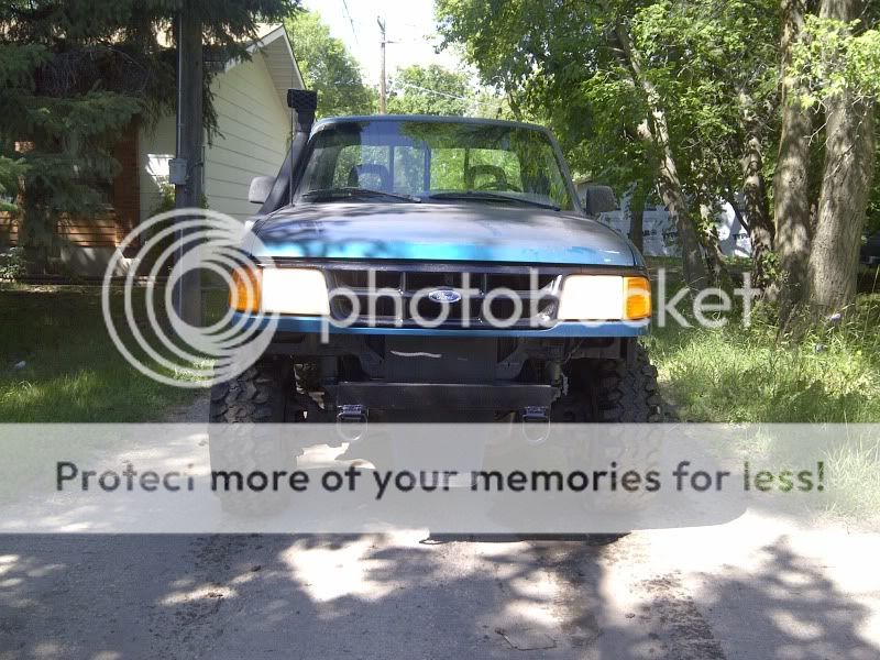

looks a little bare without the rest of the bumper built, or without the winch, but will have to do until I have time. Will more than suffice for mud racing.

I also changed the oil, changed the spark plugs, changed the air filter, greased front wheel bearings, and cut off the muffler :)
I have one last thing to do before going to the mud races, and thats to make like a rubber mat skid plate to cover the bottom (open portion) of the rad, and to act kind of like a slip, and to make sure the rad doesnt plug up, will do that maybe tomorrow. peace.

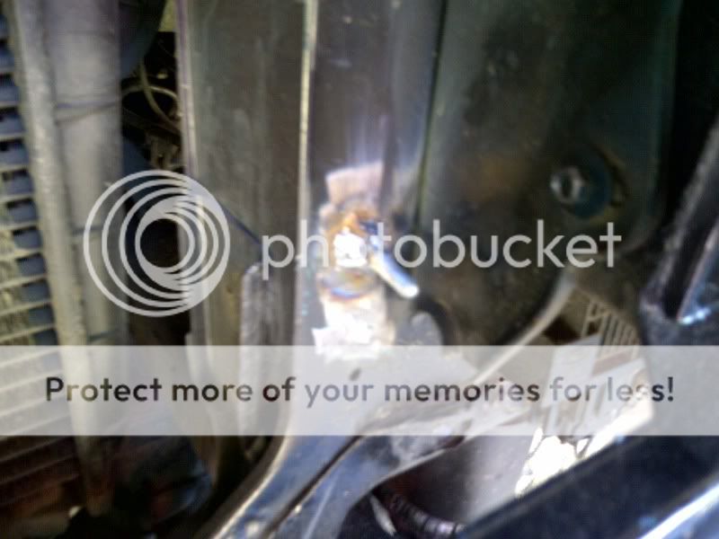

what do you have the settings set to on your welder?
I was welding 1/4" plate to the frame, so the welder was at its limits of what it can do. Settings were voltage: 4 wire speed: 60 and I had my gas regulator set at about 18 ish. I just adjust my wire speed based on how it feels. And this was with 0.030 wire.
holy shit! wire speed of 60?? Everything else is the same on mine. For some reason the guy i bought mine from made a mark on it that the welder works good at. Its between 20-30 i think. I have tried going higher and lower, and it goes ape-shit. So i just leave it at that setting.
Gas is the same. 18-20

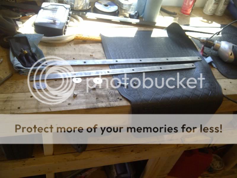

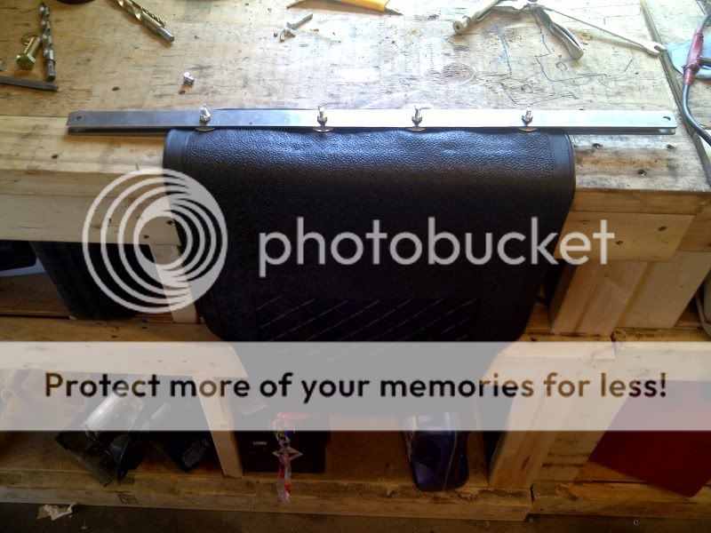

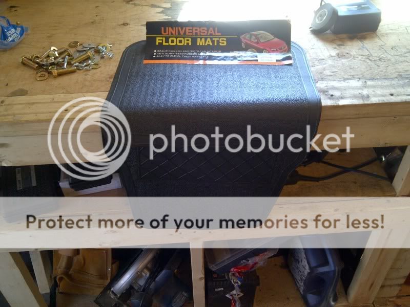

made my mud skirt, used some cheap floor mats :D
Rangebe...version 2.0
cut/drilled some flat bar
welded some 1/4" bolts
assembled

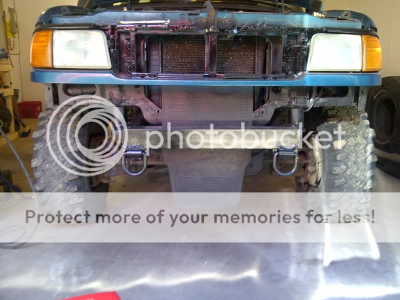

and installed

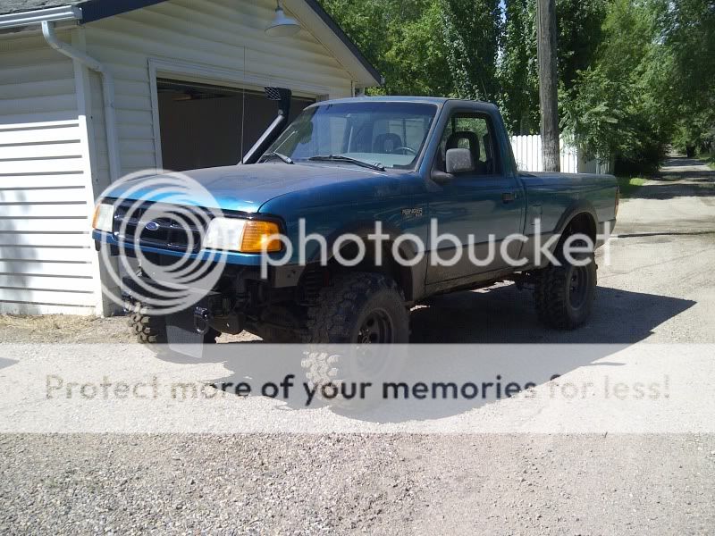

will stop a lot of mud plugging up the rad, but will still allow some air flow.

i actually dig that flap. reminds me of the one we put on my old mans big rig. rangebe 2.0 is looking real good nate dawg!
It looks like a fleshy patch where your truck's nuts used to be.

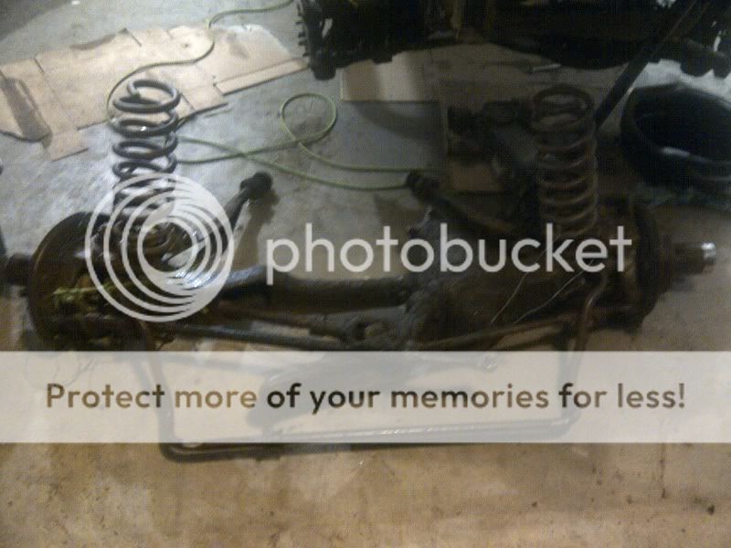

pic from tonight....buddy dropped this off for me....
Dana 44
and slo-vo has sent these in the mail for me:
and I should have these soon:
Dana 50:
Sterling 10.25
anyone have any guesses as to my plans :D
