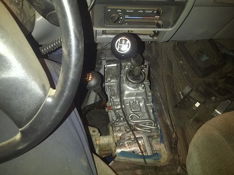

Decided to play with the shifters. These are in the stock location. All I need to do is heat/bend the tcase shifter a bit to get it in a better position, and cut/weld the tranny shifter. Even as they sit however, you can shift into all gears/ranges.

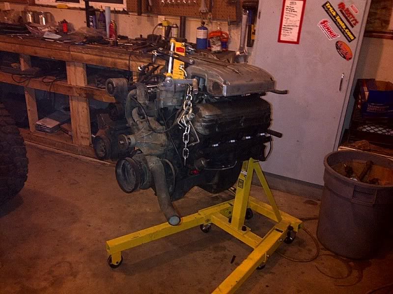

Now for the crappy news. When I pulled the stock headers I found ROCKS in the exhaust port of the passenger side head. I know the crank has been turned, so more than likely those valves/head are fooked. I have next week off, so once I finish motor mounts Ill pull the heads and bring them back to the junkyard and hope theyll exchange them for different ones.
