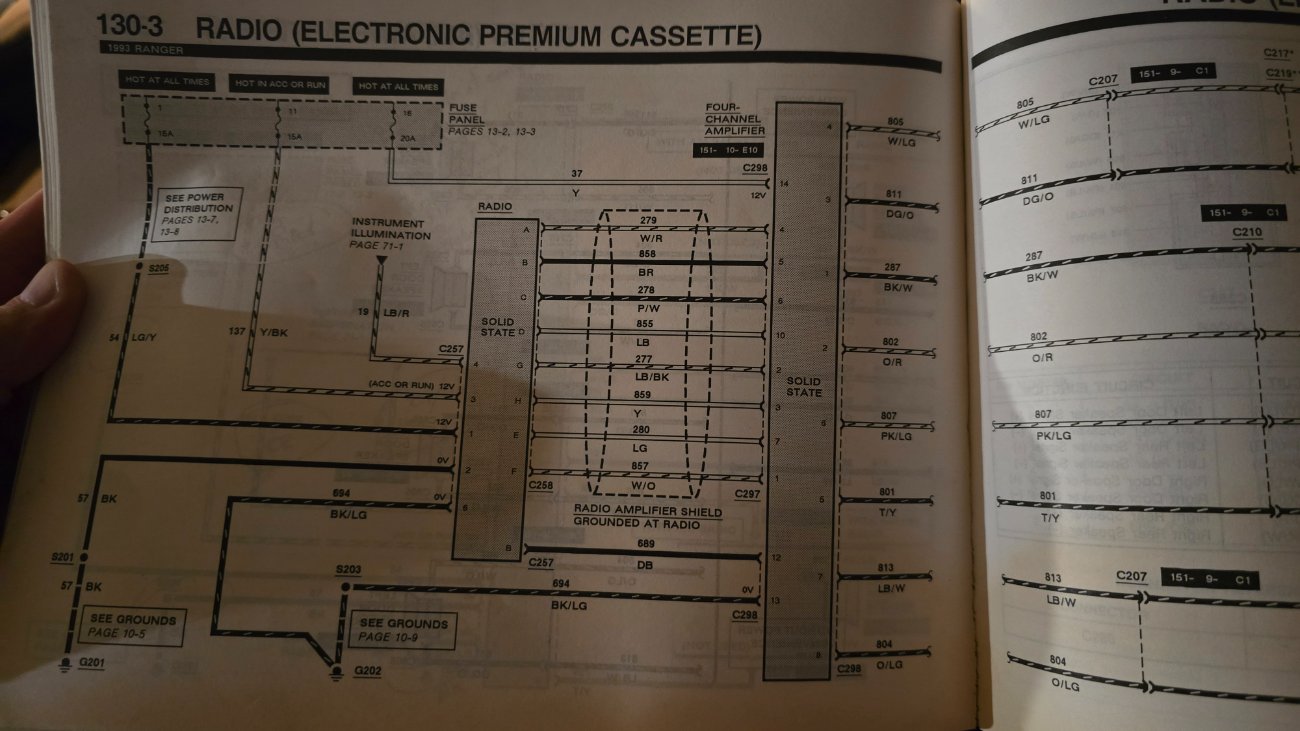

I'm replacing the radio in my '96 B4000. I cut the old plugs off to solder in the new, which I have done to other cars. The problem is I can't find a schematic that matches the colors on the wiring. Scratching the speaker wires on a battery doesn't make a sound. Finally I pulled a speaker to identify the wire colors and they don't match the dash wiring. Is there something between the radio and speaker like an amplifier? If there is, where can I find it?
TIA,
Jim
Trucks equipped with premium sound systems did have a separate amplifier. Look behind the glove box. I’ll try to remember to look in mu wiring diagrams book after work tonight to see if I can give a little more info.
Thanks for your reply. I couldn't see anything that looked like an amp. Do I have to remove the glove box? Also, if I can power on the amp, could I isolate the speakers by scratching the wires on a battery?

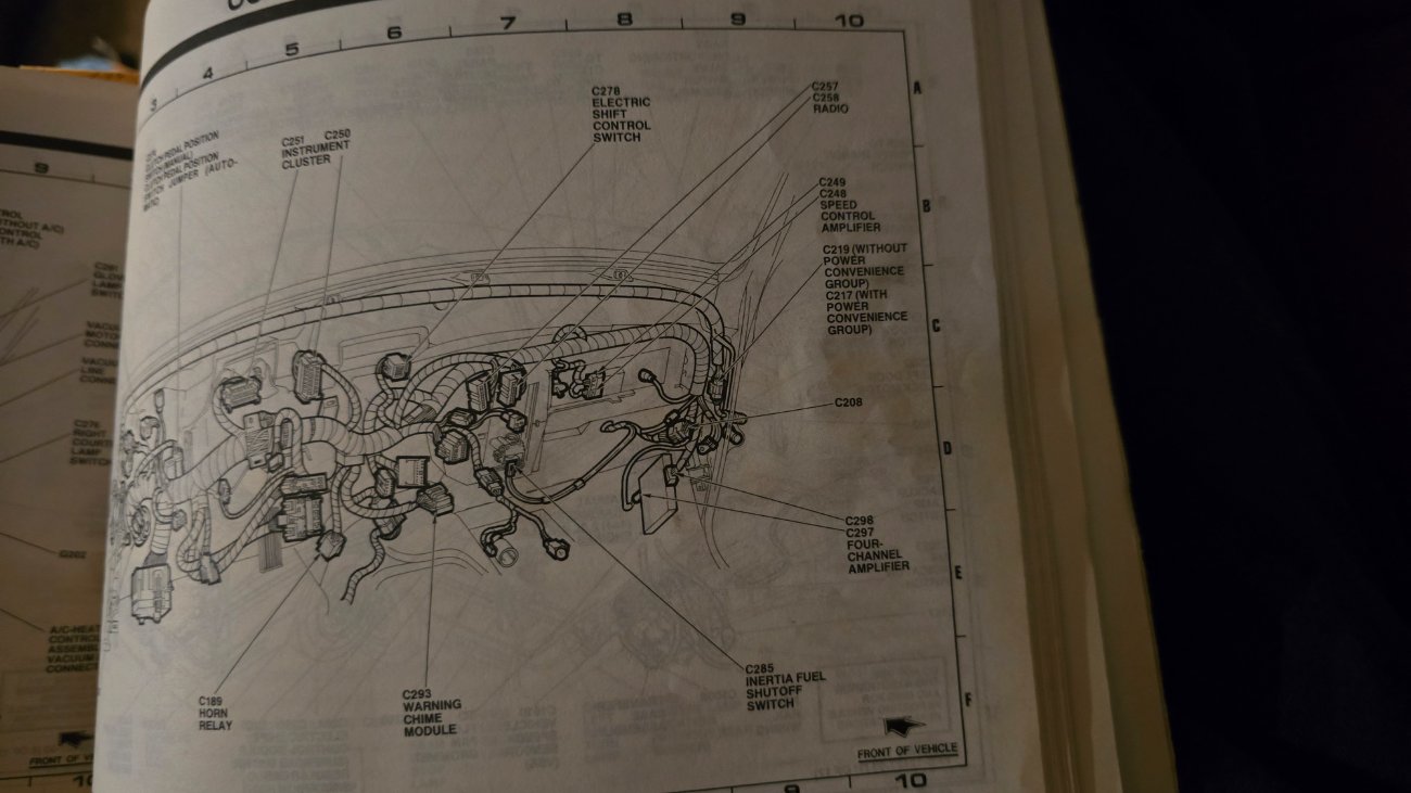

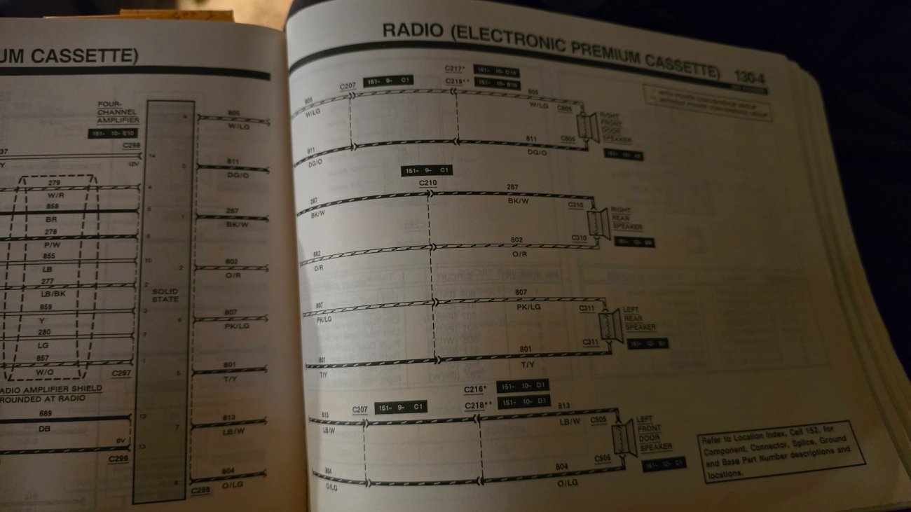

My book is for the 93. But your 96 should be very similar. It's the same generation. It looks like the amplifier might be behind the kick panel in the passenger side footwell. Here are some diagrams that could be useful.

My '94 shows the same location.

Now my problem is how to get the kick panel off. It looks like it snaps off but I don't want to force it.
Got a 96 B400 electrical manual and it shows the amp being on the rear bulkhead, which doesn't make sense. It wasn't there anyway. I finally bit the bullet and ran new speaker wire, a real pita and if I have to do it again I'll just burn the truck. Thanks for all your help in trying to solve this.
Well, I finally gave up and ran new speaker wires to the radio, not a job I ever want to do again. Thanks for all your help, it meant a lot.
