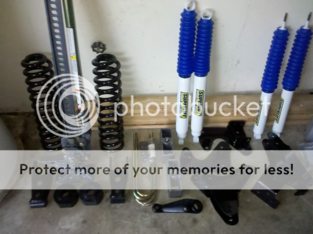

Got the rest of the 8" of lift in today! Here is a pic, including the high lift jack I scored on CL:icon_thumby:

Nice jack, looks brand new! What size is it?
Thanks man. It is brand new. The guy got it as a gift, and didn't even use it once. It's a 48" got it for $50!
Well stated.. High lifts are a gift from god! Ha ha. I'm gona bolt on a 1/5x6x12" aluminum plate to the bottom, to help keep it from sinking in mud. A winch is on the list as well, but it can wait till I find a good deal. I still have to fab the bumpers anyway, so I couldn't mount one if I had it.

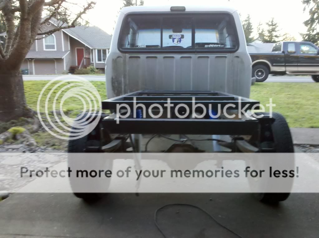

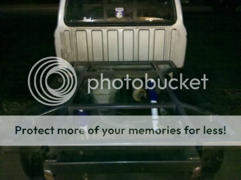

Tube-bed pics!

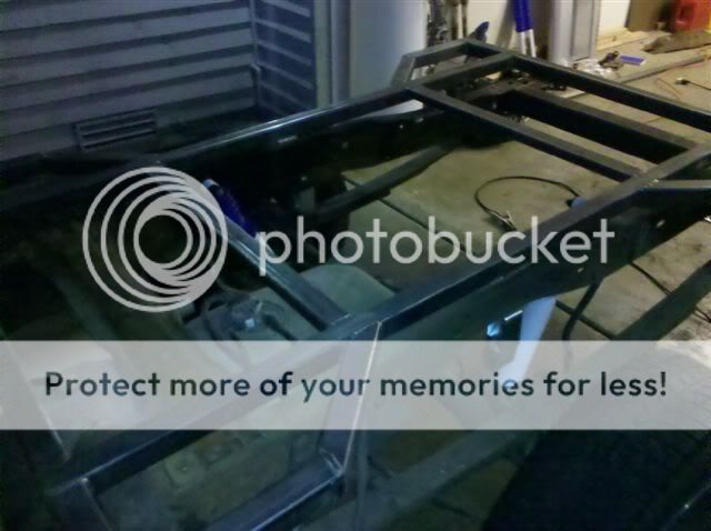

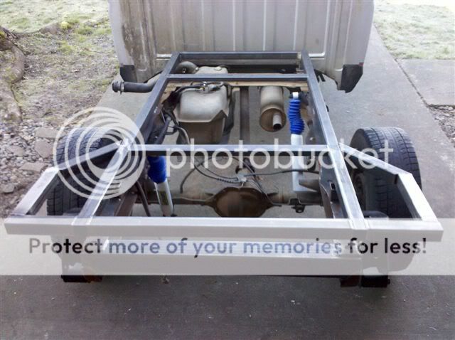

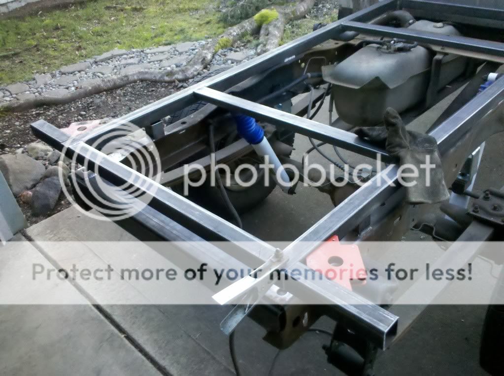

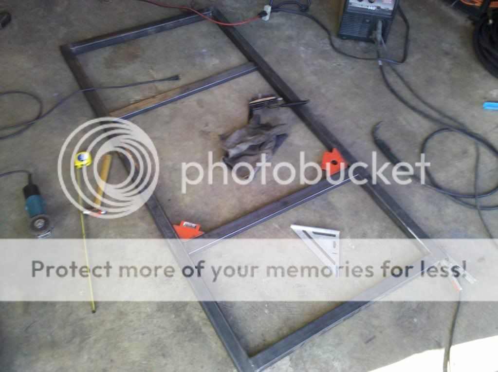

Got started on the bed yesterday, and was able to get most of the basic frame done this afternoon. Still quite a ways to go, but I really like the way it's looking. Slo-Vo's tube-bed, was a huge inspiration for the design. Thanks Slo-Vo!
I used 1 3/4 x 1 3/4x 120 wall square tube for most of it, and 1 x 2" 120 wall for the cross members.
(2) 1 3/4 tube @70" long
(2) 1 3/4 tube @ 29 1/2" long (end pieces)
(2) 1x2" tube @ 29 1/2" long (center cross members)

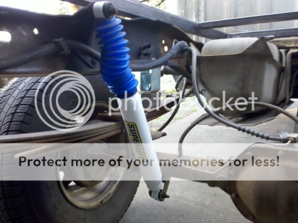

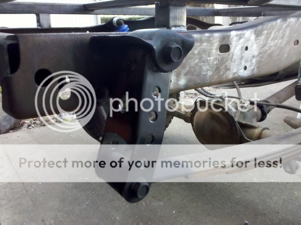

Pics of the shackles and shocks:
