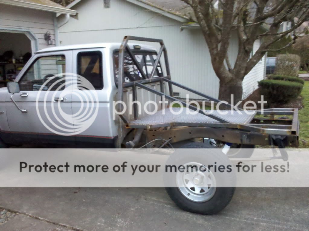

Interesting design/idea on the tube bed and roll bar. Looking forward to seeing it completed. You planning on running hi-clearance fender bars over the rear tires too?

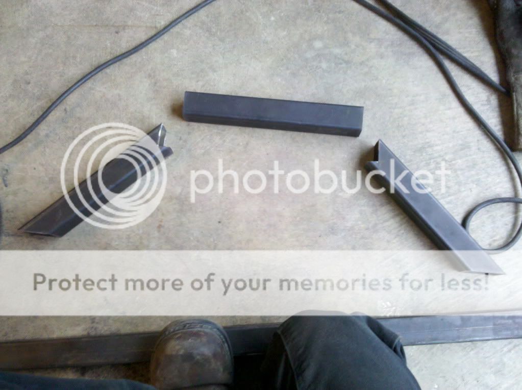

Have you heard of miter cutting square tube at all. I did my back bumper corners that way. It's time consuming but looks not bad when done. Miter cut 3 sides of the square tube for several inches and many cuts so you can bend the tube to what ever angle your after, then once bent, weld it back together for a curved square tube bend. Just an idea to add to your build.
Thanks man. It is definitely a one of a kind. At first I was kind of doubting the strength of the square tube roll bar, because of all the corners, and welds, but it's pretty stout as it is. Once I get some more bracing, and cross members on it, I'm sure it'll hold up just fine. I'm not planing on running any type of fender. I think all I need to be legal in the state of Wa, is mud flaps. I'm going to make some detachable ones, that mount to the very rear.
I've never heard of mitering tube like that before, but that's quite interesting. It could actually turn out pretty slick. Do you have any pictures of it finished? Thanks

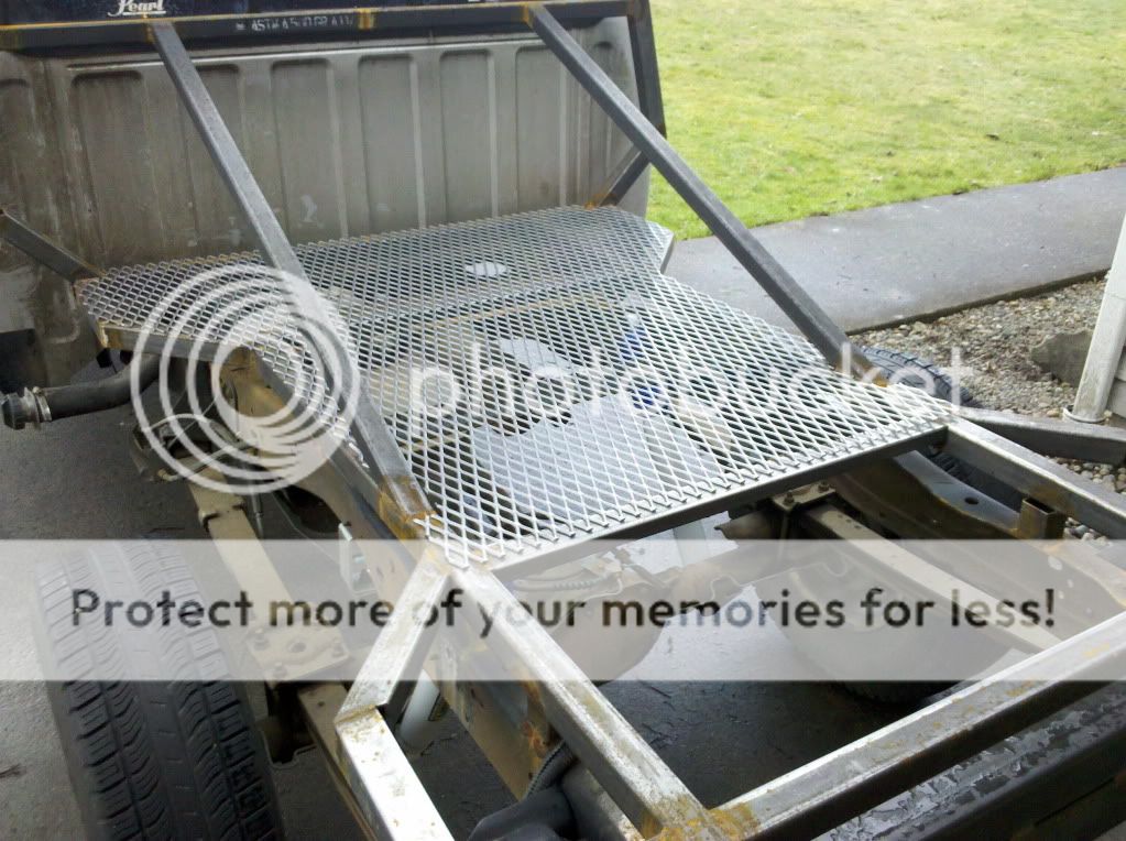

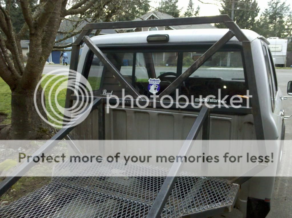

Picked up the expanded metal, some more 1-1/2 x 1 1/2 tube for bracing the roll bar...... I think it's more capable of handling a roll now. Ha ha.
Here are some pics:
Here's the expanded metal plopped in (unwelded) On the back section, I'm going to get some diamond plate and make it kind of like a work bench. I''m gona mount a vice on the right side, to make U-joints a little easier on the trails, as well as what ever else I decide to break.

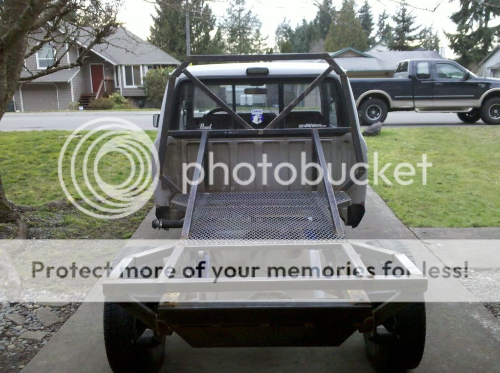

Bottom supports:
More cross members:

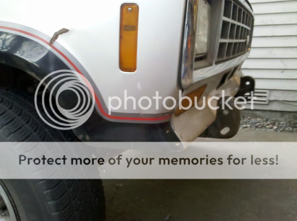

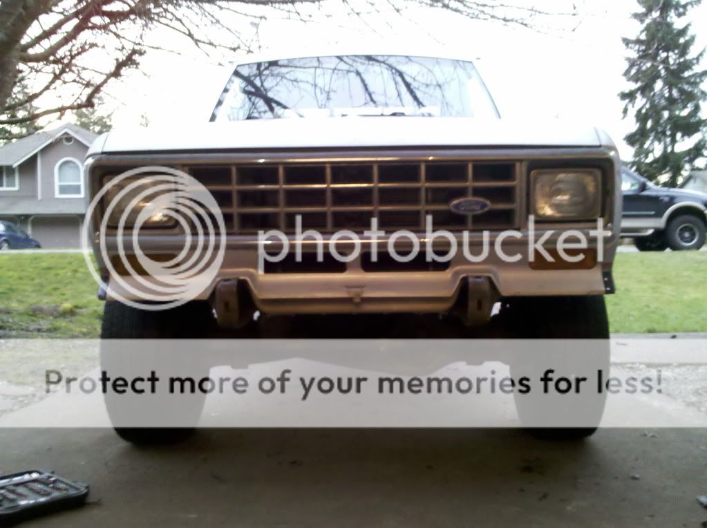

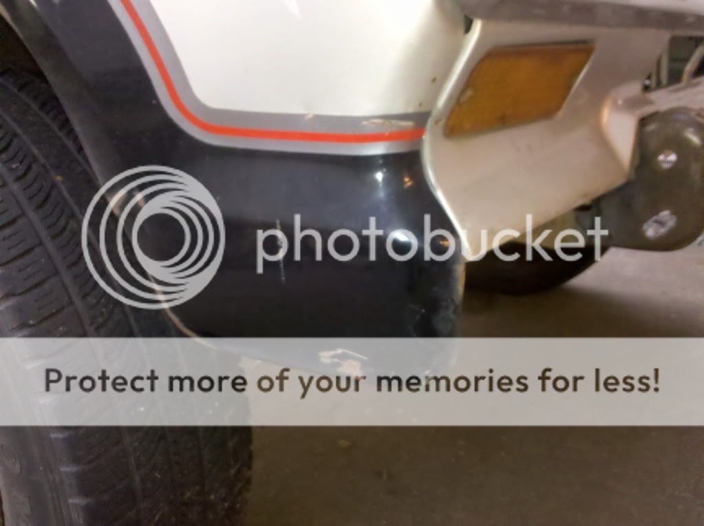

Got started on the front bumper too. Bumper off, wire wheeled the hornes, and started cutting the fenders a little.
I got the main tube welded on the frame horns, but it was too dark to take a picture. I have everything I need to finish it, except for the tube for the receiver, so next weekend I will have some sweet bumper pics!

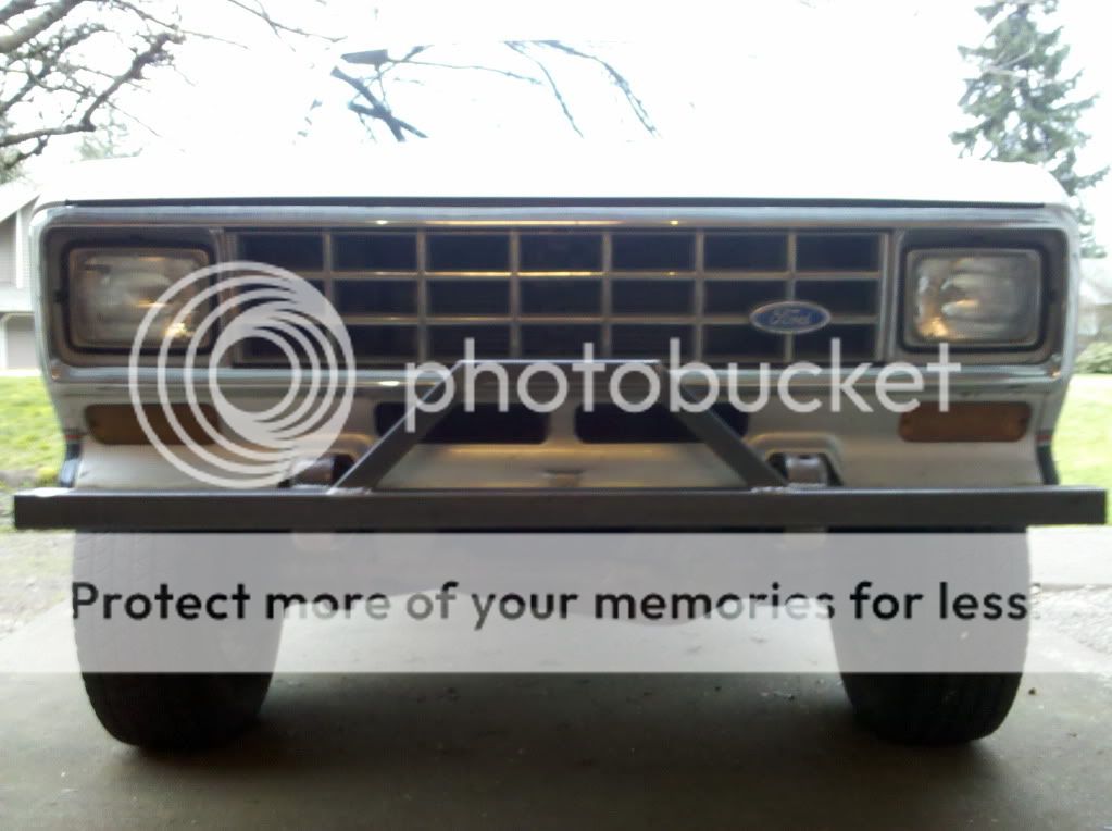

Here's a little front bumper progress..

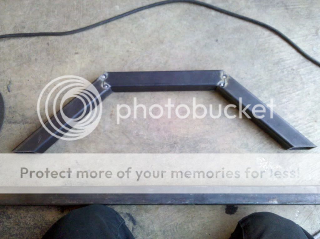

Bull bar tubes notched with a grinder. 1 1/2 x 1 1/2 x 120 wall tube
Tacked up
Welded on. The main tube is 2x2x3/16 wall 58 1/2" long

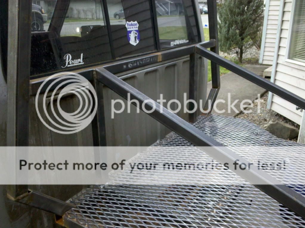

And for the hell of it...another shot of the tube bed
I have LOTS more to do on the bumper:icon_welder: This is going to be the fun part..... I've been looking forward to it for quite some time. It won't be the fanciest, but it'll be functional, and very stout.
