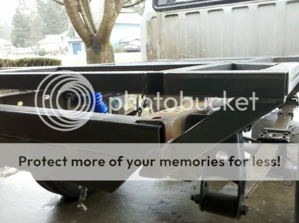

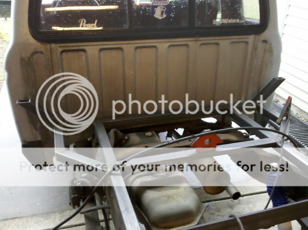

Added a cross member in the center:

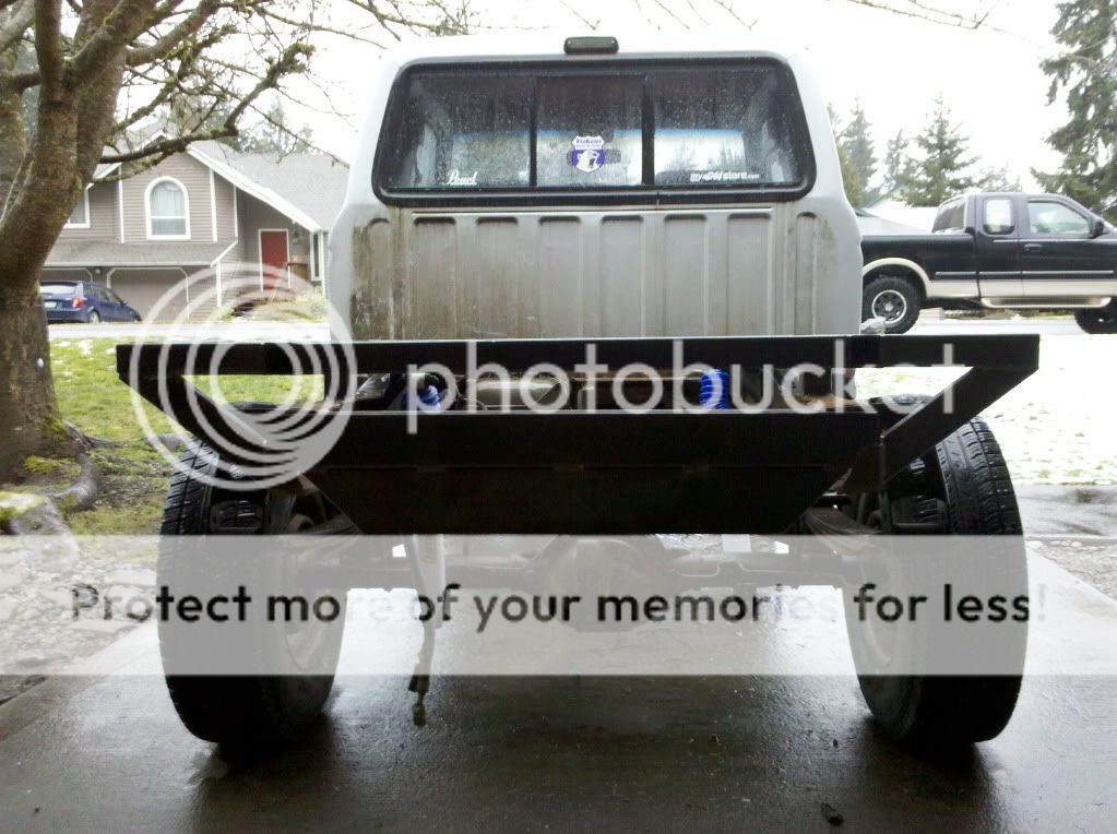

Added some 1x2x120 wall tube supports, and the angle iron cut at 45's on both sides, to make it more bumper-like (I think that's where I'm going to mount the lights)

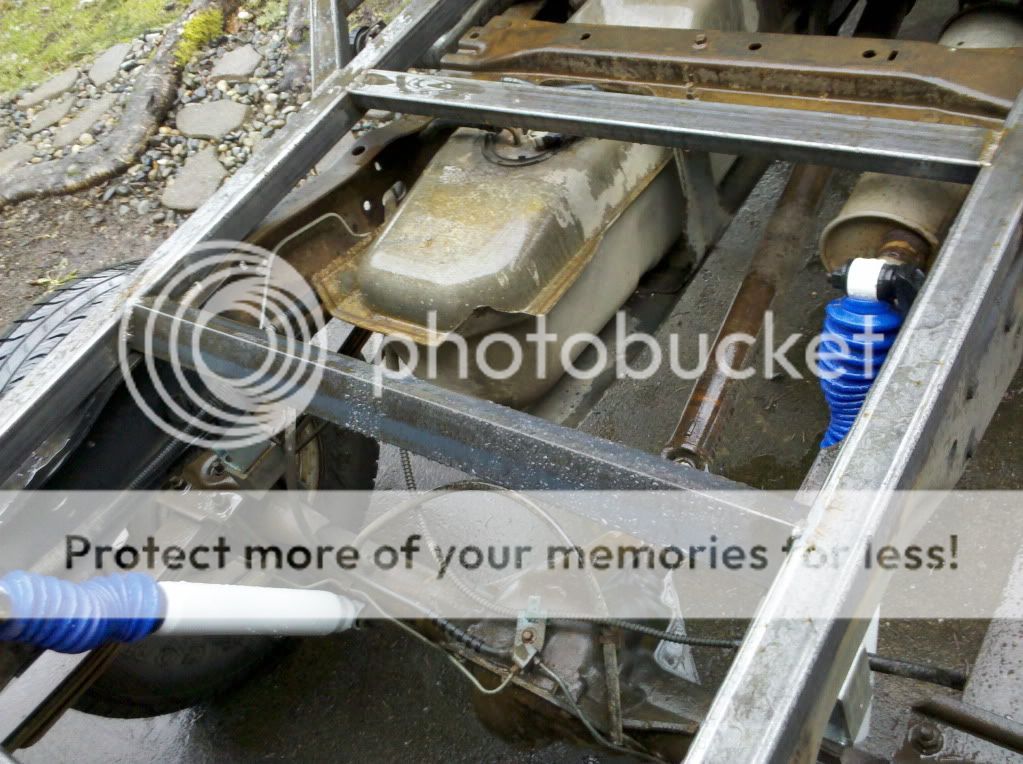

A good rear view:

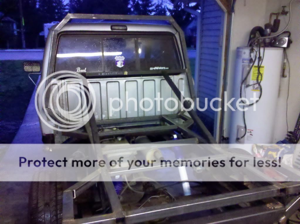

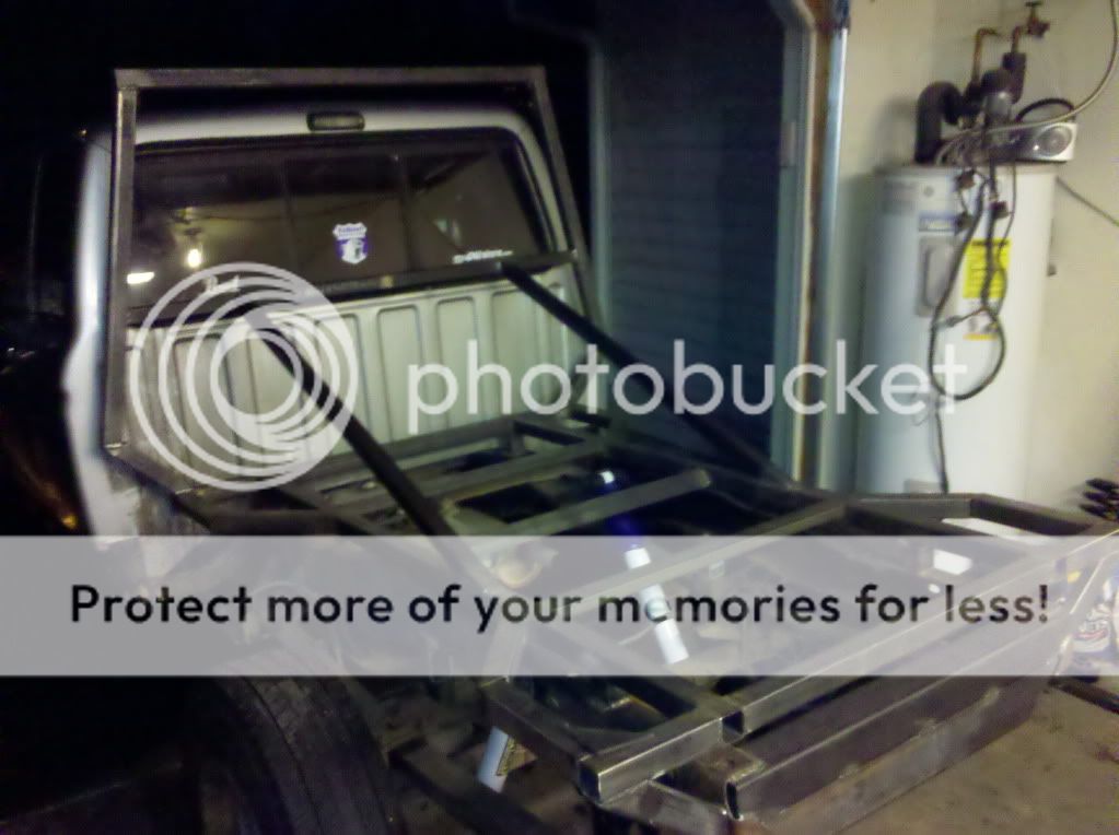

Getting started on the roll bar:
What it looked like by the end of the night:
Like I said, I really really don't like the top of the roll bar. It just looks like a standard headache rack. Next weekend I'll fix it, as well as some more cross members in the roll bar, and have some updated pics. My gears are supposed to come this week, so I might be posting some gear install pics, and info. It's almost lift time:icon_bounceblue:

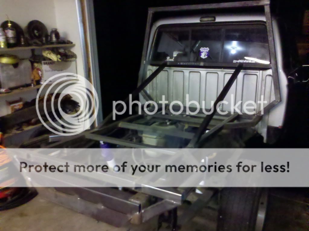

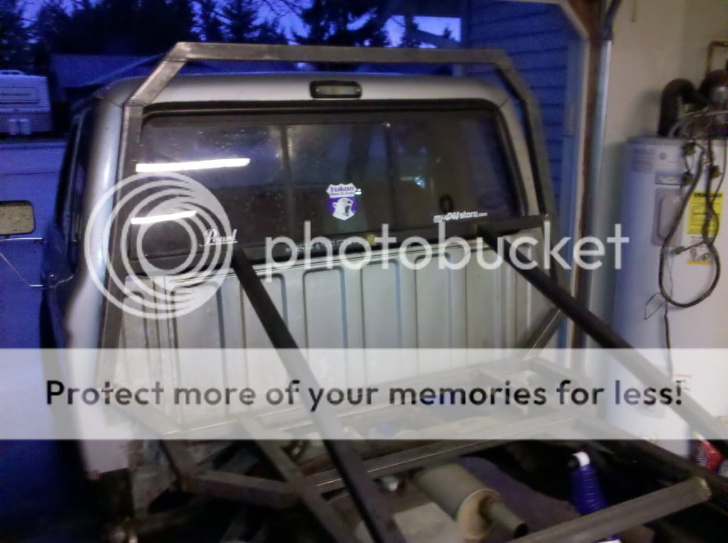

Fixed:
Still needs some bracing like I said, but I ran out of both time, and steel. I also took an inch out of the overall height, so it sits closer to the top of the cab. I'm pretty happy with how it's turning out.

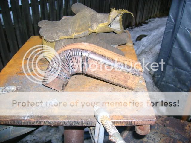

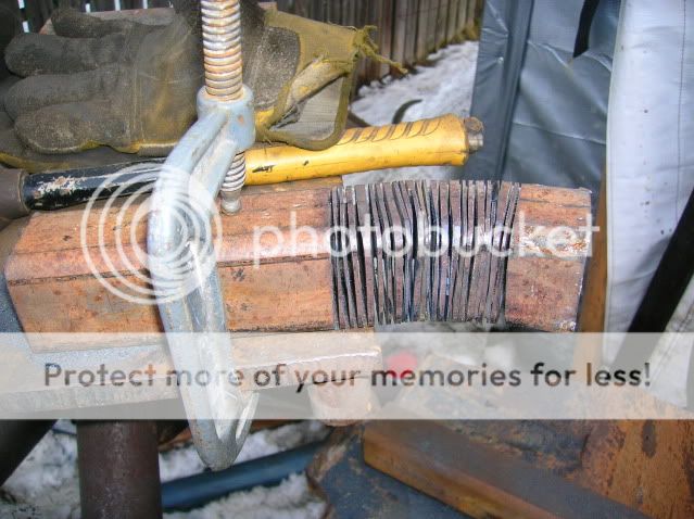

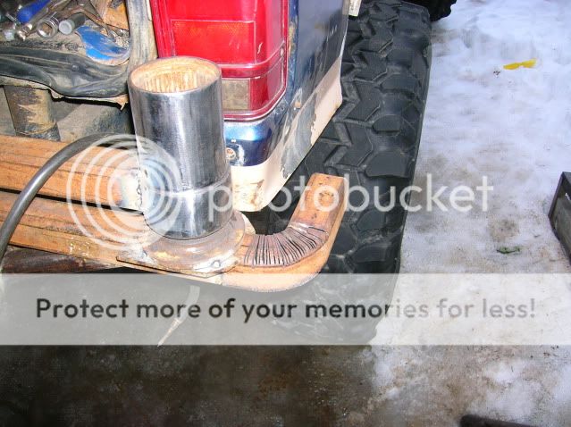

Have you heard of miter cutting square tube at all. I did my back bumper corners that way. It's time consuming but looks not bad when done. Miter cut 3 sides of the square tube for several inches and many cuts so you can bend the tube to what ever angle your after, then once bent, weld it back together for a curved square tube bend. Just an idea to add to your build.
