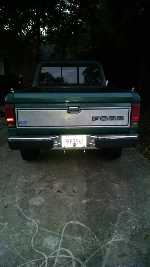

The truck ran like crap and had two dead cylinders when I drove it two hours back home. The plug wires were fried, the points in the cap were burned up and the timing was way off. I pulled the air plenum and cleaned it thoroughly. The EGR port was so clogged I had to use a ½ drill bit. The valve cover were leaking and missing bolts. I went through and rewrapped the wiring harness with new tape and loom. I addressed many details as I went along. The tranny was dry when I bought it so I dropped the pan and serviced it. It helped, but still shifts sporadically. The interior is in great shape just needed a good cleaning. It looks great now, all it really needs a new dash pad. The large piece of trim on the tail gate of course fell off when the previous owner had it. Thankfully he saved it. I was able to repair and reinstall it. I would prefer to delete it but thanks to the big holes Ford drilled in the sheet metal I cannot. Oh my god the amount of water I have sprayed on this truck. I have no idea how much I have spent on water and degreaser. I have hit with the pressure washer many times and the underside and engine compartment it still greasy. There is more here and there but you get the idea.

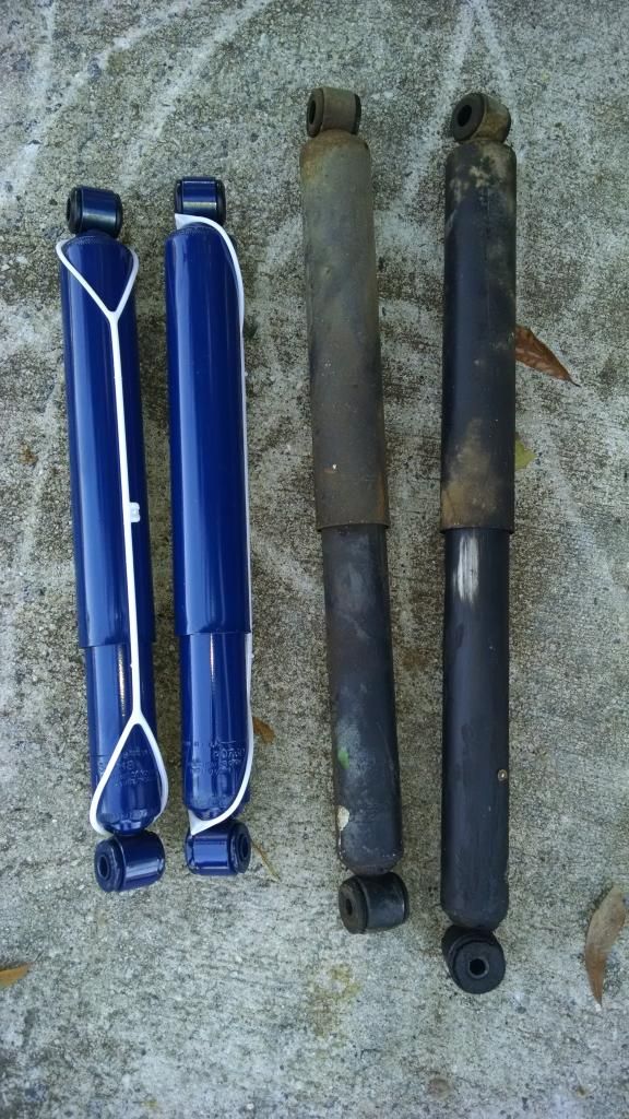

I also replaced the original 1987 shocks. They are beyond worn out.
