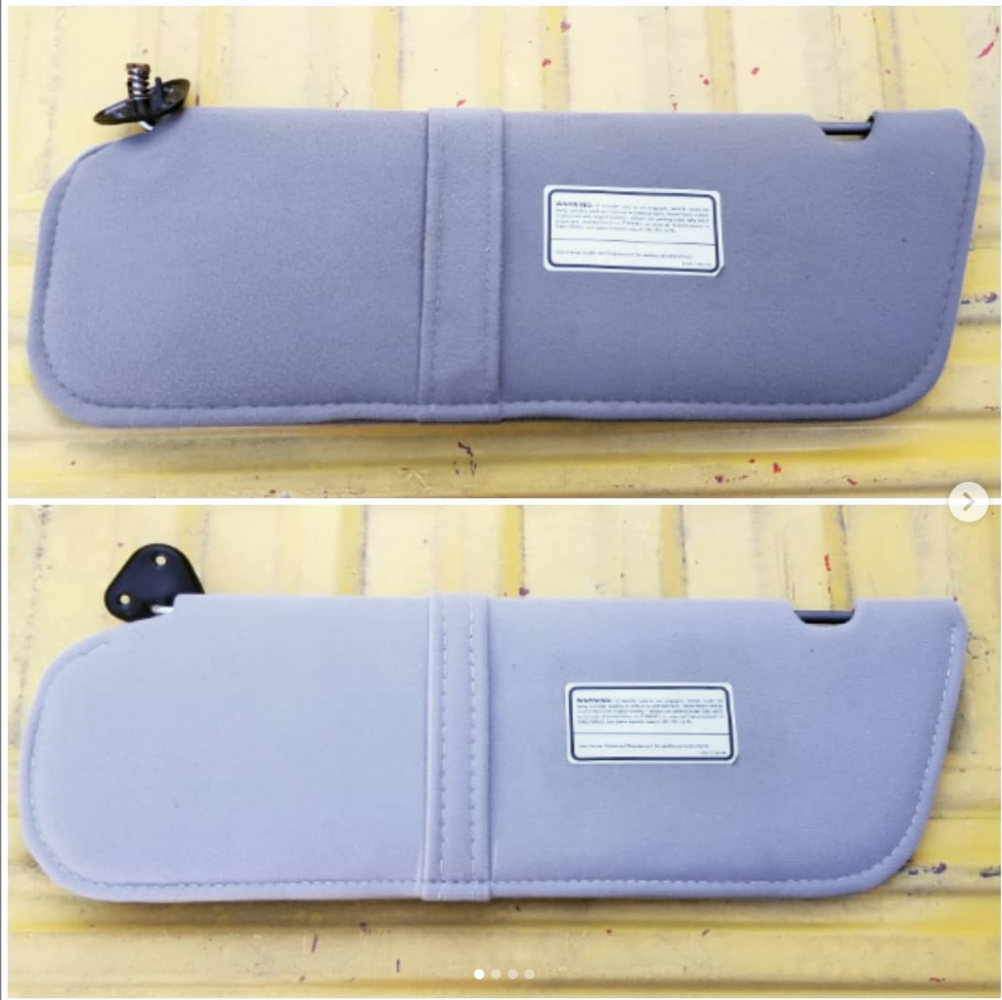

I also had my visors professionally redone locally for $50 from a guy who's done custom hot rod and classic car upholstery for years. He did good work.
