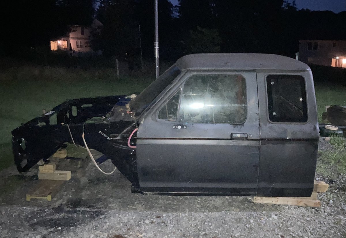

This week's developments so far...
(He currently has the cab blocked up on wood 3" from the frame to clean and strip /remove unnecessary lines and cobbled wires.
The truck had NO engine/trans/tcase/trans crossmember when he got it.)

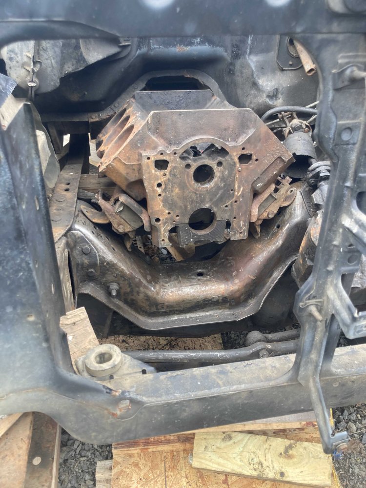

We placed a bare 787 series 3.8 Buick block and factory Buick G-Body mounts into the bay.
It does look like we have a future interference issue w/ the right bank cylinder head & Valve cover and the AC box on the firewall, especially if he just goes w/ stock body mount or 1.5" body lift like he wanted (with a 2" suspension lift.) I still am un-burying the oil pan and the valve covers for this block from a corner of the storage area- so I'll have them to add to the block for mock-up soon.
It would help if I had/could find a factory correct reference measurement from the Block /Trans mounting face (plane) to a fixed point on the frame or the front axle centerline.
I have included pictures without the block being placed in any specific orientation/squared, etc. IMG_4309.jpgIMG_4308.jpgIMG_4307 (1).jpg

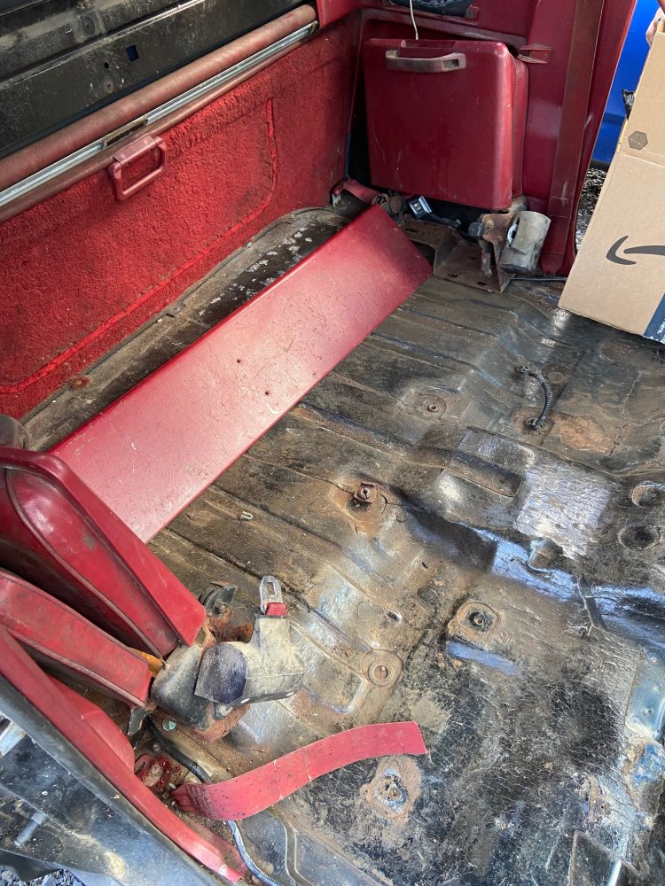

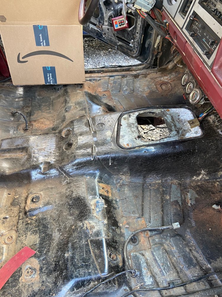

He's cleanned, rust converted, & painted the rear frame & underside of the bed floor. Pulled the cobbled wiring and rusted brake lines.
Cleaning and scraping the front of the frame to rust encapsulate and paint.

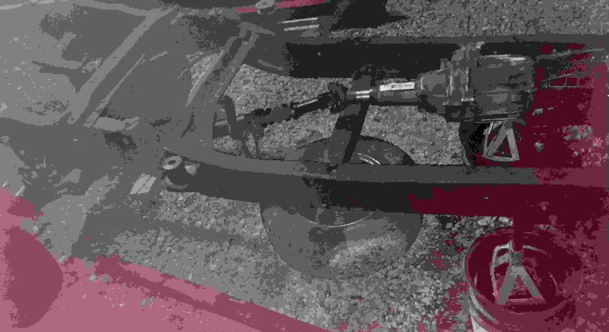

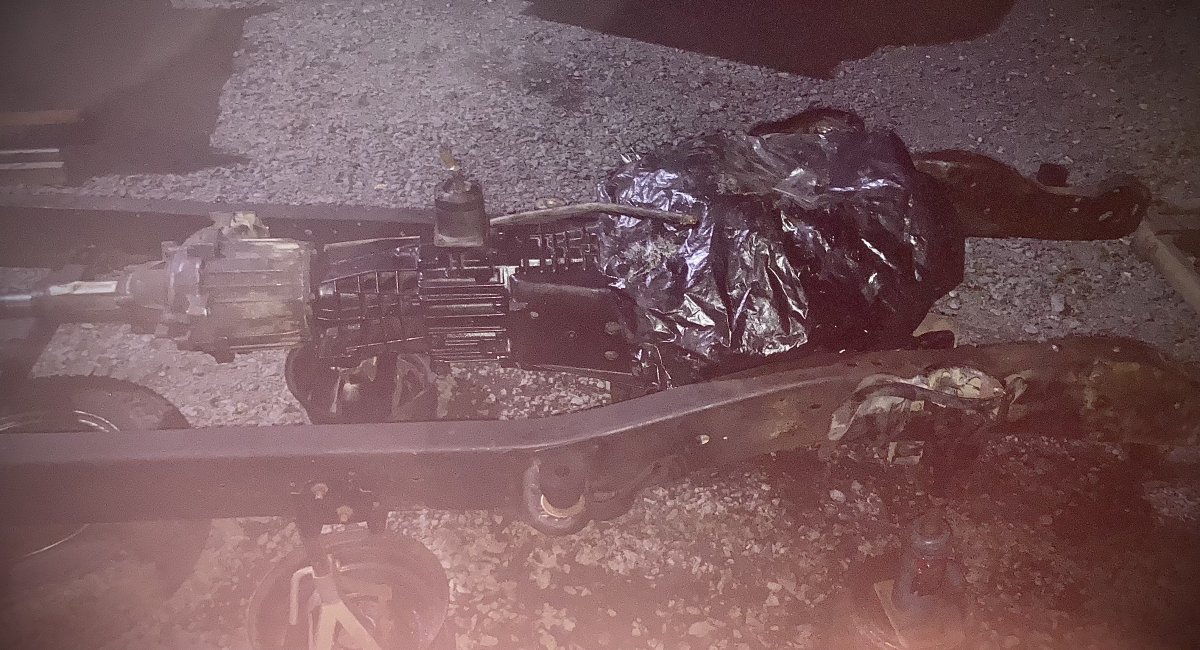

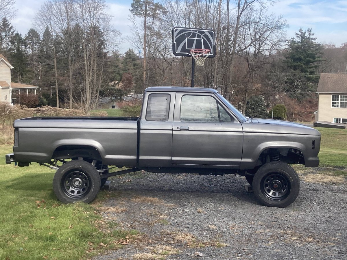

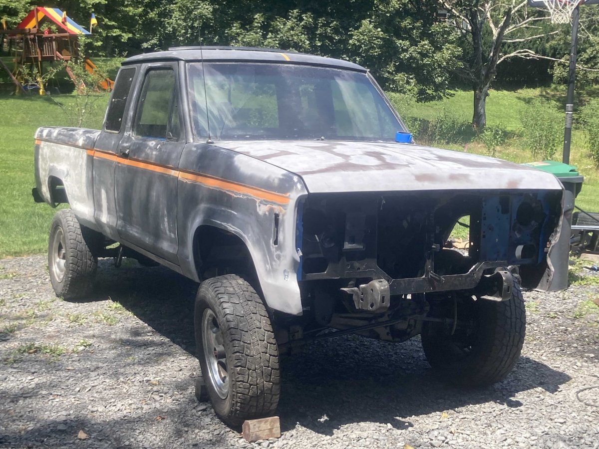

Progress Update- mock-up w/o a few missing components:
2002 Sport Trac rear leaf springs installed (2" lift approx.)
Scraped, undercoated, prepped.
NV3500 Chevy Trans & empty tcase w/ bare 3.8 block mocked up.
Shifter is looking nearly perfect on floorpan

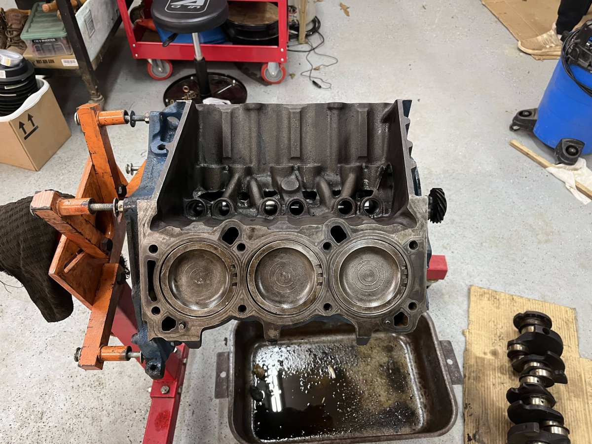

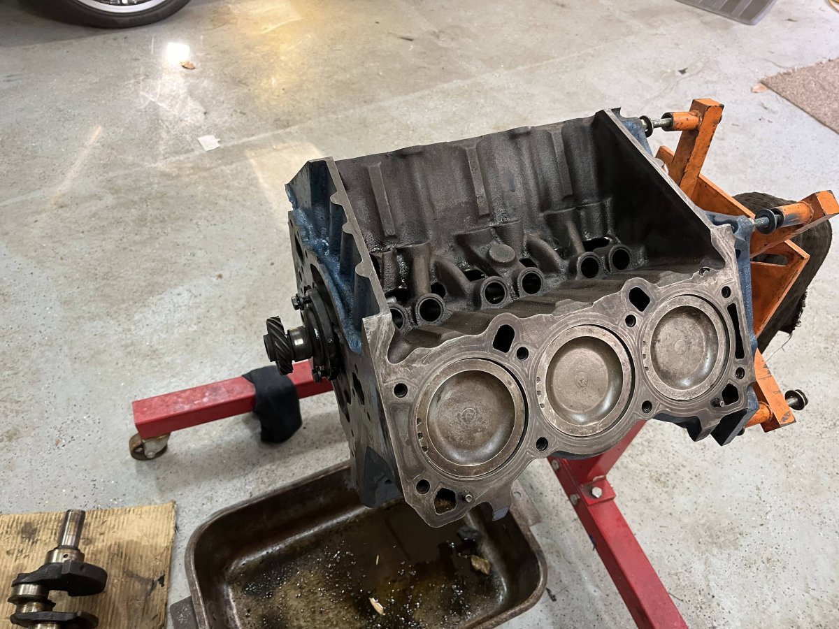

Had a setback on the engine- the cam journal bearings in the 85 block were not viable, and the rod bearings showed wear. Refreshing the 85 shortblock soon. Pictures below...

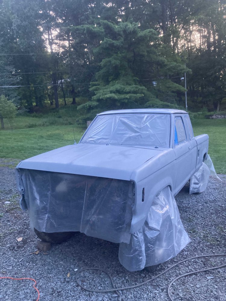

Updates:
Painted. Basecoat color: Eastwood Charcoal Metallic w/ 50g extra fine silver flake added. Clearcoat added w/ 50g deep forest green pearl (2 coats). Forest green striping and graphics to be determined and added next summer . New weatherstrip for doors and rear wing windows. Having trouble with spinning studs on the rear window. Next up reinstall cab wiring by windsheild and dash.
Continuing to work on body details, electrical harness repair, and we've begun rebuild of the Buick 3.8. (85 Block and heads w/ 80 Turbo Internals (pistons/cam & crank) (Master rebuild kit was back-ordered on the Main Bearings so we must order them) also need to get Chevy 10.4/.5" clutch kit/proper pilot bearing for the Buick to NV3500 input shaft and one t-Case bearing and replacement chain for the NP231C. Heater box and core going back in.

(Grandpop's shop and both Cousin's labor sure helped clean up and begin assembly of the motor- 45th Anniversary SS is Grandpop's)

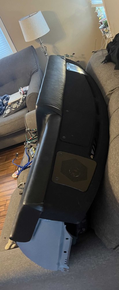

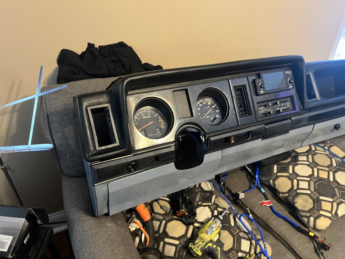

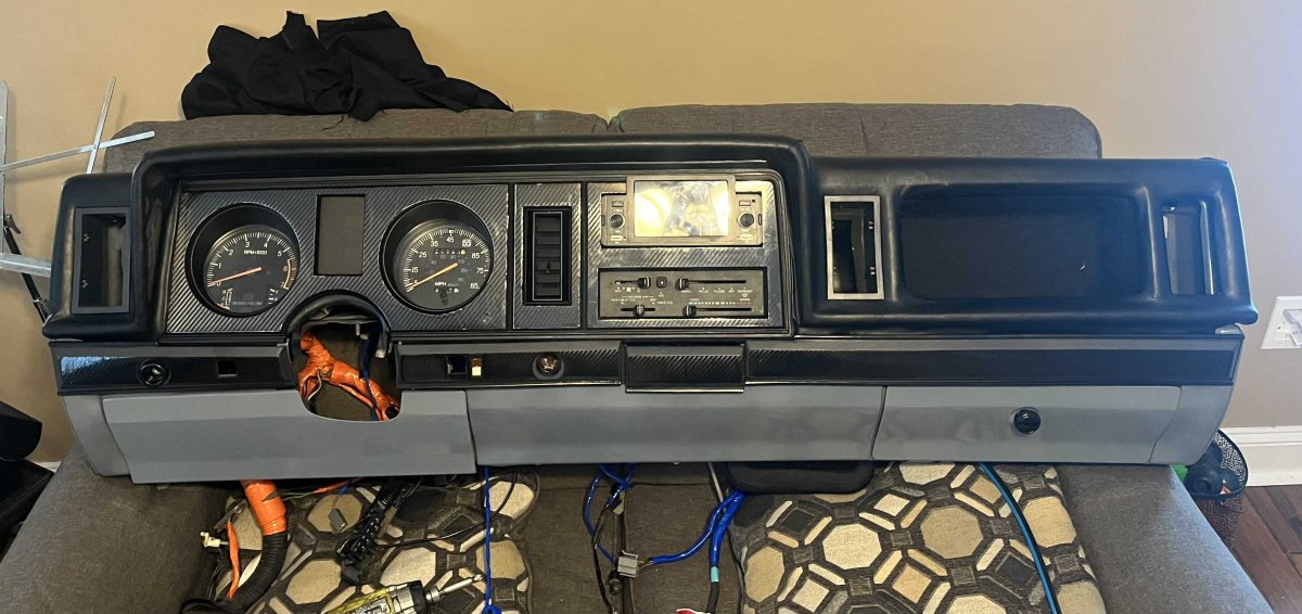

Dash and interior coming together (After & Before pictures below)- Synthetic Leather & Black Denim wrapped, false carbon fiber vinyl over the silver, chrome & red deleted. Panels wrapped and pictures coming. Just a few more parts to gather for the motor and it will be ready to reassemble and install. (Needs clutch, hydraulic clutch hose, TCase Chain and a tcase bearing) Fuel & Brake Lines.)
