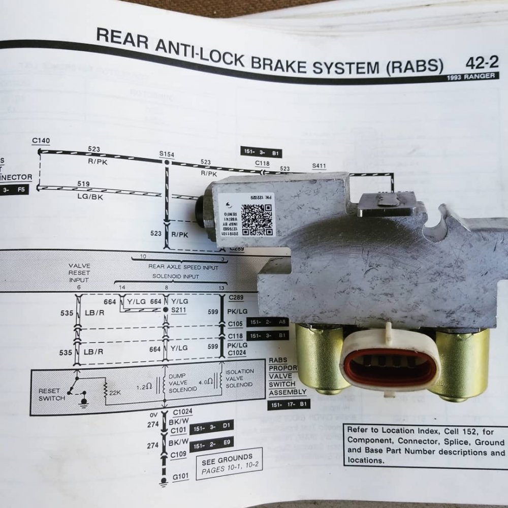

Finally fixed my ABS system (again)! As suspected, the replacement Cardone hydraulic valve I previously installed was faulty. Mechanically it worked, but the pins weren't measuring the correct resistances per the wiring diagram. There was no resistance for the reset switch pin, so internally it was open. New one read 22k ohms, as expected. I replaced it again, measuring the remaining pins before installing and they all checked out. After bleeding the brakes, the ABS light turned off successfully. What a pain, but it's done. ✅.

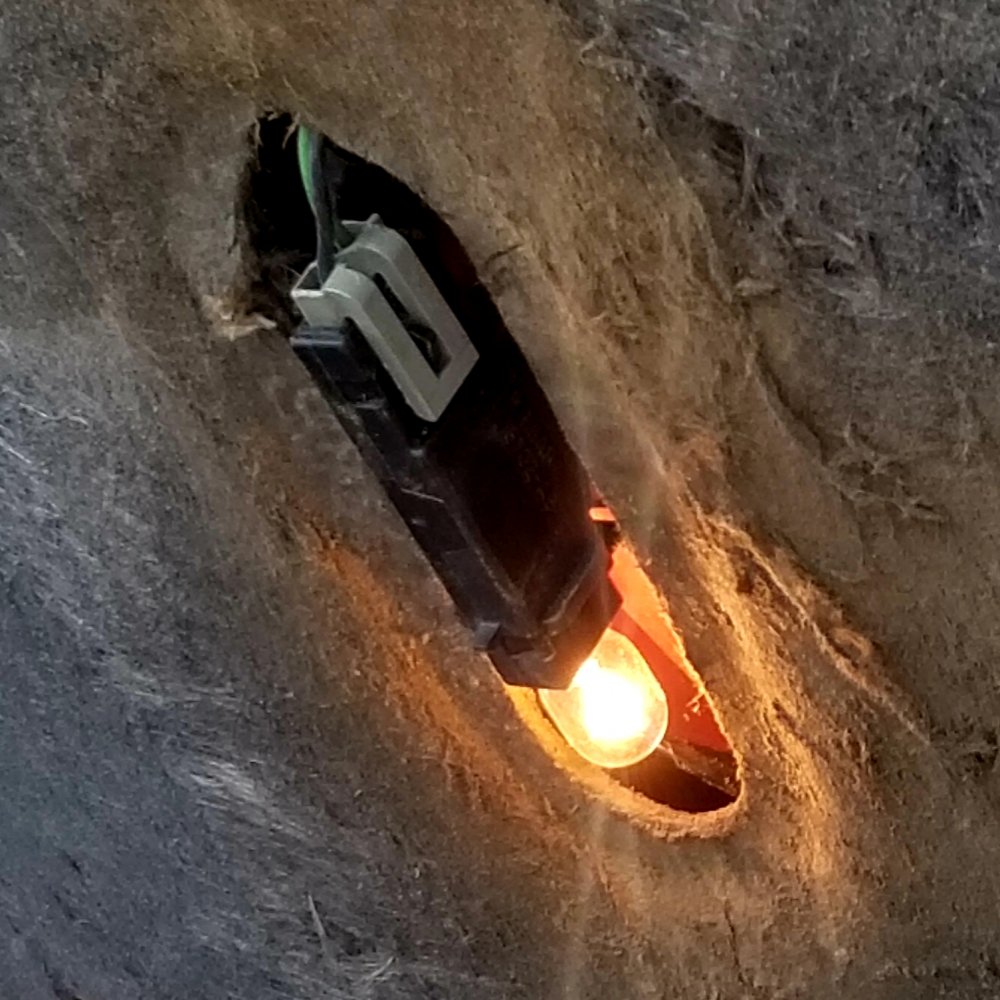

The under-hood lamp is fixed! Last year I resoldered the frayed wires of one connector end, and now I replaced the connector on the other end. I got a replacement oem switch (#E8ab-15702-AB) off eBay, so now it works as it should. Everything electrical is now 100% fixed on the truck! Win win.

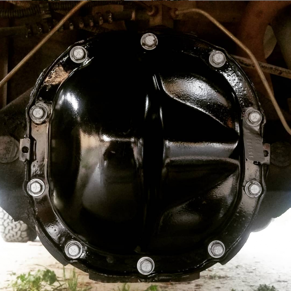

The other day i fixed my leaky rear differential and I took the opportunity to paint the cover and bolts. Black isn't a flashy color, but it has the stock 3.27 gears so i just wanted it to look cleaner.
