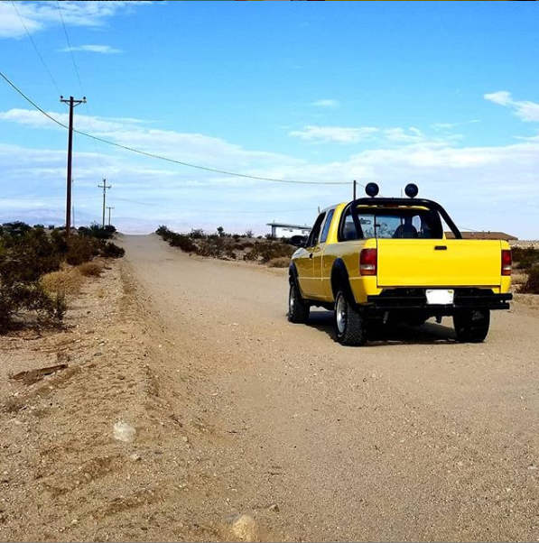

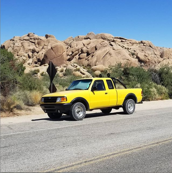

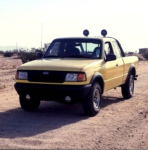

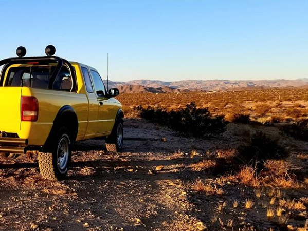

For labor day weekend in September, i drove the truck from LA to Joshua tree for the weekend. The trip took 4 hours to get there (traffic) and 2.5 hours back. Temperatures were well above 100 degrees outside and even though the engine was doing fine, once we arrived coolant was spilling out from the reservoir. I may have over filled it. Nonetheless the truck did great, but was very slow going up hill. AC wasn't working during this trip so my fiance was pretty angry throughout haha, oh well. I took the following photos while out there.

Driving on the rocky roads broke the rear left speaker since the adhesion of the drum (don't know the real name) was too old to hold it together while jumping up and down. The trip ended with no working sound. Boo.
